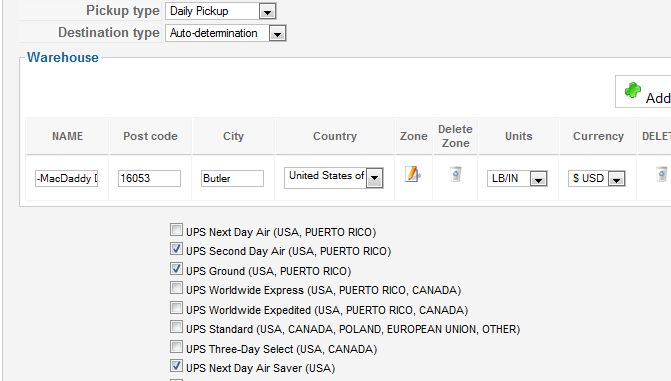

nicolas wrote: Please make sure that you selected the USA and not the USA minor islands in the country of your warehouse.
If that is ok and that the zone of the warehouse is removed it should definitely not display that warehouse not found error.
1) Per reading this thread and others, I made sure: > United States of America (United States of America prior to my post.
2) Zone of the Warehouse is removed
3) Agree, it should not....but it does..Here is new screenshot sir.

I apologize that I stopped responding to this post, but if this helps it seems to be resolved.
In my case, I am not really sure what I did to resolve it, but at some point the error that UPS could not understand the unit of measure of a product or that said product values were going out of parameters led me to review the products I had in the cart. Turned out one of them had their dimension in Meters rather than inches. Thus, I had a 1lb product that shipped in 5m x 5m x 5m box. That's a box almost the size of a small house. Once I fixed that, UPS started working fine.
I am positive that previously it didn't work and it wasn't the use of Lb and Meters that confused it. But among the many changes I made I must have hit the right one that left only the humongous box as the last problem to fix.
I'll be happy to post a screenshot of my UPS plugin later if you think it may help.
