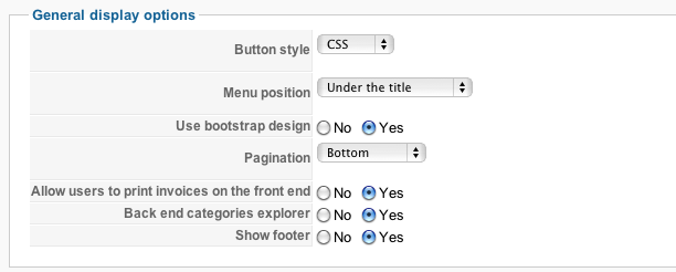

I want to use bootstrap check out styles without modals.
However documentation shows option to turn off only in Joomla 3 not 2.5 see www.hikashop.com/support/documentation/5...html#display_general
How can I keep style_red/ bootstrap settings on and NO modals on checkout?
