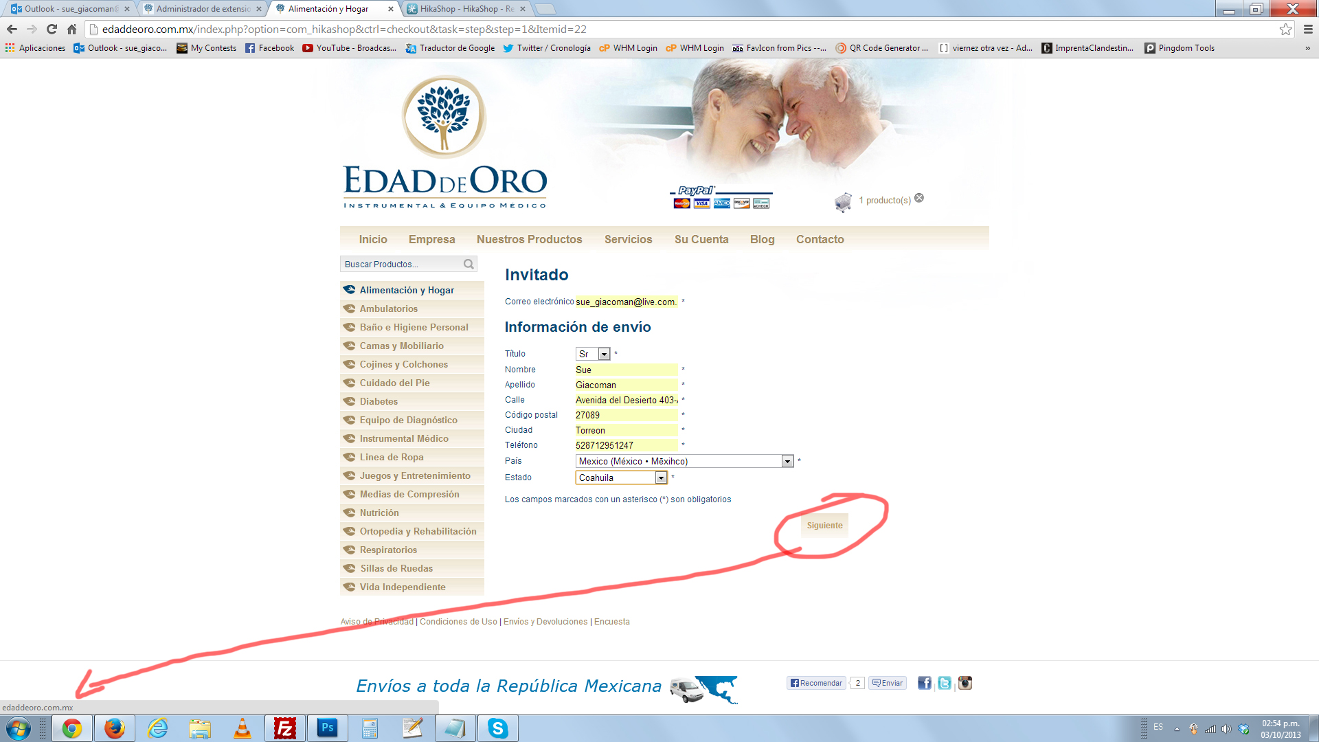

  • Posts: 103
12 years 10 months ago #126254
Hi! This is happening to me too, what can i do to fix the trouble?
I found that the url of the next button in the guest checkout is actually, directing to the homepage, where i can fix this?

  • Posts: 103
12 years 10 months ago #126399
Dear Jerome, feel like i have a similar problem, could you please help me?
www.edaddeoro.com.mx
I just created a special admin user for the access
user: hikashopadmin
password: hikashop
Thank you so much in advance!
