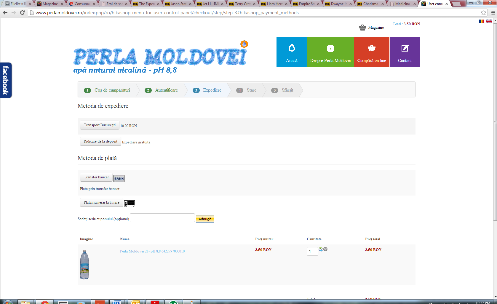

  • Posts: 18
12 years 9 months ago #127891
Auto submit shipping and payment methods selection is on Yes but it doesn't proceed to next step when payment/shipping methods are selected.
I enabled the Bootstrap so you can check it out. When i click on payment/shipping button label it doesn't seem to get the active class. So actually maybe this is not why it doesn't change its appearance.
Please have a look on my website.

  • Posts: 18
12 years 9 months ago #128746
Hi.
I edited the address template.
I didn't edit other views.
Please find attached requested screenshots.
I have to specify that I migrated from the hikashop i had installed on Joomla 2.5. Still, i update hikashop on the current Joomla 3 installation.
On the payment/shipping screenshot, both the payment and shipping methods were selected.

12 years 9 months ago #129199
As Jerome said previously, your template don't seems to support bootstrap so thanks to disable the option "Use bootstrap design" in Configuration > Display > Main.

12 years 9 months ago #129264
To edit the shipping and payment buttons, you have to edit the views "checkout / shipping" and "checkout / payment" via the menu Display > Views.
Then in these views, you can revert the check on bootstrap when displaying the buttons, the code in question is:
<?php if(!HIKASHOP_RESPONSIVE) { ?>
			<td>
				<input class="hikashop_checkout_shipping_radio" type="radio" name="hikashop_shipping<?php echo $shipping_key;?>" id="hikashop_shipping_<?php echo $rate->shipping_type.'_'.$rate->shipping_id . $shipping_key;?>" value="<?php echo $rate->shipping_type.'_'.$rate->shipping_id . $shipping_key;?>" <?php echo $checked; ?> />
			</td>
			<td><label for="hikashop_shipping_<?php echo $rate->shipping_type.'_'.$rate->shipping_id . $shipping_key;?>" style="cursor:pointer;">
				<span class="hikashop_checkout_shipping_image">
<?php } else { ?>
			<td>
				<label class="btn btn-radio" for="hikashop_shipping_<?php echo $rate->shipping_type.'_'.$rate->shipping_id . $shipping_key;?>"><?php echo $rate->shipping_name;?></label>
				<span class="hikashop_checkout_shipping_price_full"><?php echo $price_text; ?></span>
				<span class="hikashop_checkout_payment_image">
<?php }
You just have to remove the "!" in if(!HIKASHOP_RESPONSIVE) to not use the bootstrap buttons.
Hope this will help you.
