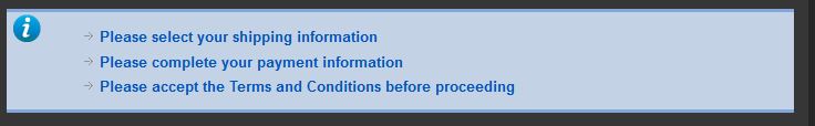

  • Posts: 21
12 years 10 months ago #126940
Mohamed,
After getting rid of the clicking next twice.. I now find that I get messages as I go to the billing/shipping part of the check out.
But they come up straight away before a user has time to make their selections.
See attached.
regards
Jeff

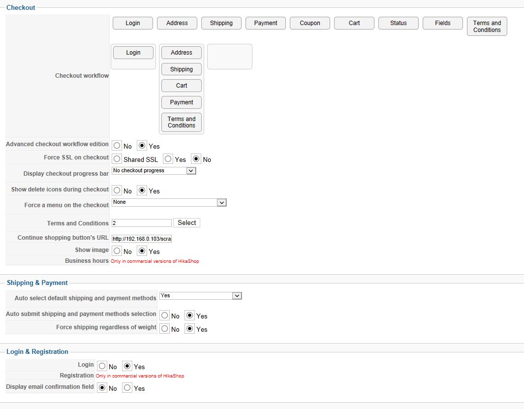

12 years 10 months ago #126941
Ok, and can you show me screenshots of how did your configured your checkout workflow through "Hikashop->System->Configuration->Checkout" ?
  • Posts: 21
12 years 10 months ago #126944
I just made a change and set it to auto select default shipping and payment. As you can see in attached file.
I think that has done the job. So I think I just need to refine my shipping rules so that it defaults to a less expensive option, or more to the point the correct option.
  • Posts: 21
12 years 10 months ago #126950
It now at times tells me to please accept terms and conditions as in the first pic I sent. But obviously when you get to this stage you want to be able to select postage and payment and then terms and conditions. obviously after you have read them.
Its like it is submitting the form before the user has a change to actually fill it out.
  • Posts: 26380
12 years 10 months ago #127052
Please update your HikaShop store with the latest package 2.2.2 (which is currently not in auto-update so you will have to download it manually in our website).
This release includes some fixes (listed in our change log) and some improvements in the checkout workflow. I think that this new release will fix your "accept terms" problem.
Otherwise, I will recommend you to put a relative path for your "continue shopping url" and not set an aboslute one (with http:// ). The current option won't work for external users who can't access to the local IP address currently set.
