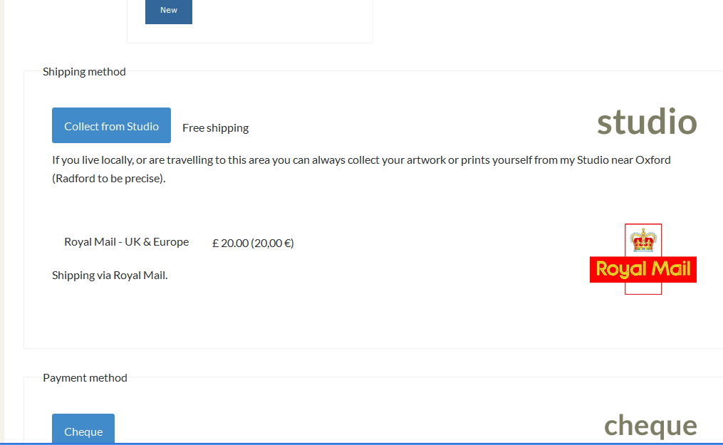

I seem to be in a catch 22 situation here..... my template supports jQuery and permits me to say whether I want it loaded or not. If I load it the checkout process works just fine with as per the attached image. However, I am then not able to upload images either via drag & drop or browsing using HikeMarket! There's no error message, indeed the message tell me everything has worked although it obviously hasn't.

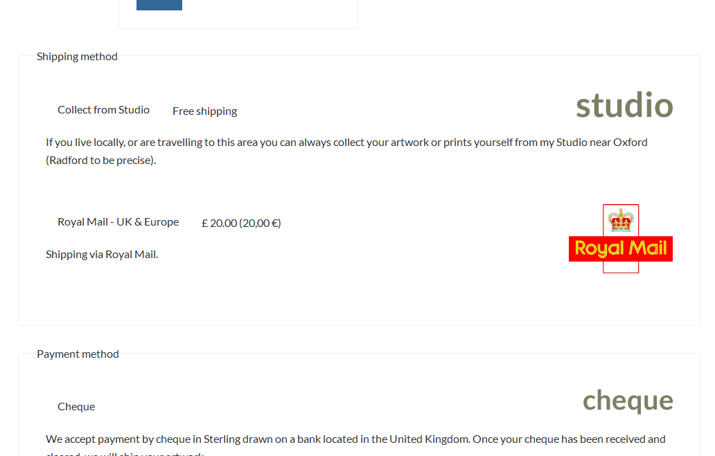

If I disable jQuery in my template I can upload images using HikaMarket, however, the buttons in the checkout process no longer change colour to indicate which options have been chosen (shipping & payment mechanism). Here's how it them looks:
I'm not sure where I go from here - any ideas on what my next step should be please?
