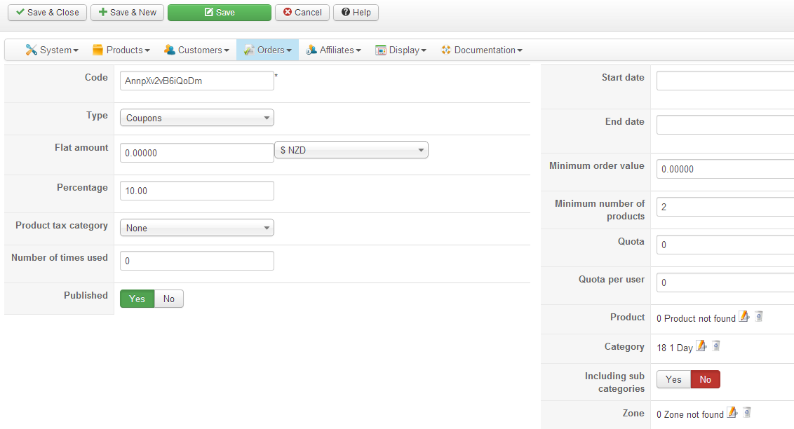

Can you please do a screenshot of all the options of your coupon ?
  • Posts: 139
12 years 9 months ago #129801

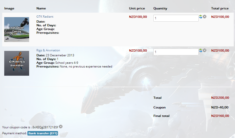

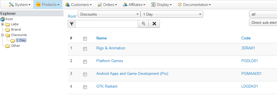

If the buyer has 2 products in the "1 Day" category" then they get a 10% discount on these products.
But from the above you will see that the wrong coupons are being applied.
Also when I add other products not in the 1 Day category, these are also discounted.

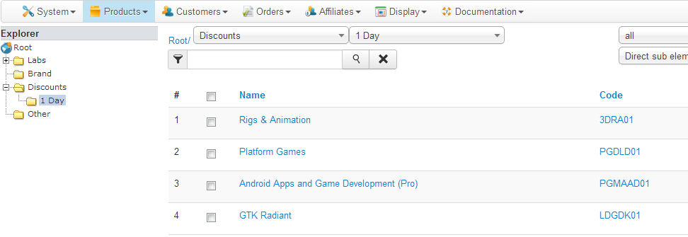

The problem was coming from the fact that your 2 product were both part of the 1-Day category, I tried it by putting one of your 2 products out of this category, and it worked fine :) :
Last edit: 12 years 9 months ago by Mohamed Thelji.

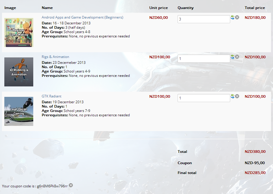

Hi that for that but the problem still exits.

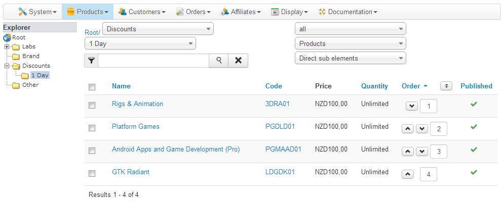

Here is a list of the products in the discount:

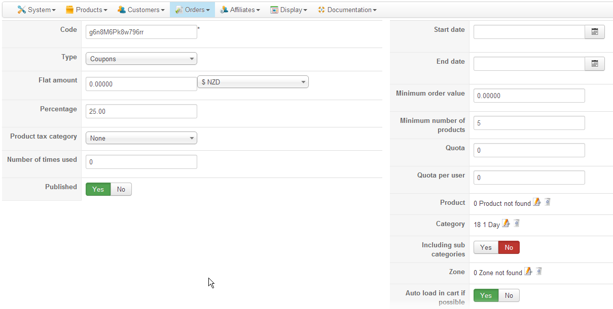

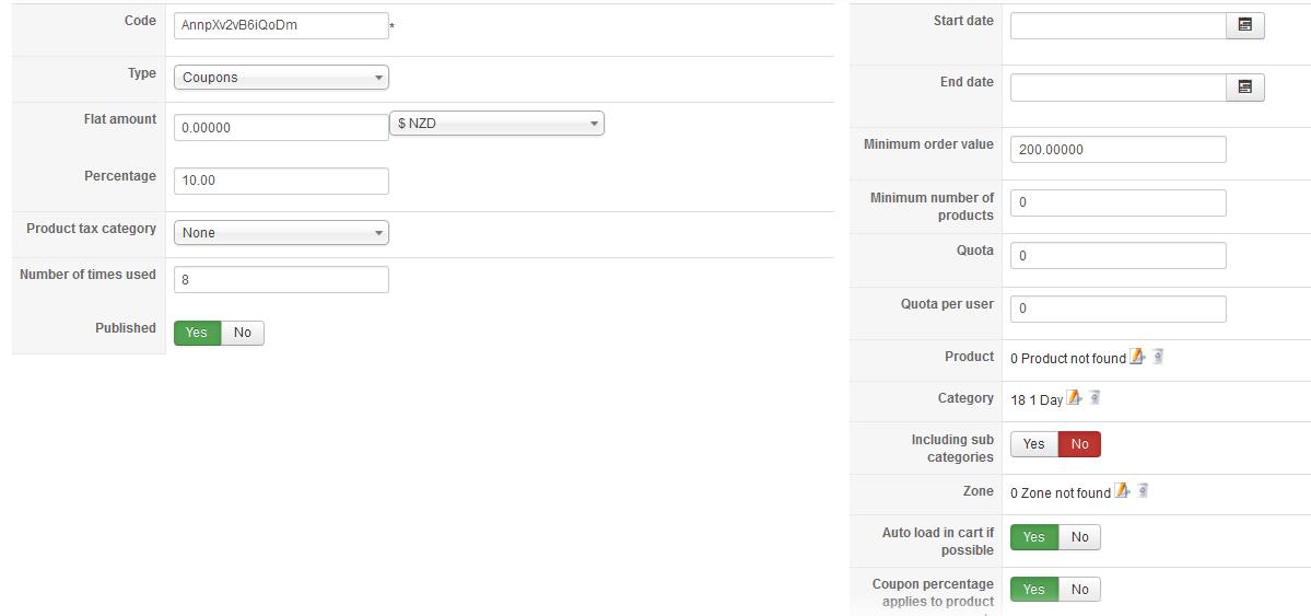

Here is the coupon that should apply when two of the above products are purchased

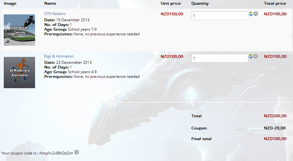

Here is what the checkout looks like
The result should be $180 (no discounted product) + $200 - $20 (10% discount on the discounted products because two of them were ordered)
This however is the coupon being applied and it's been applied to all products

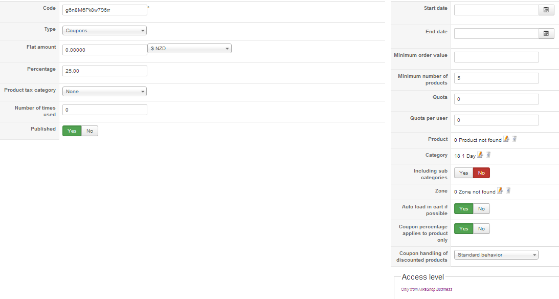

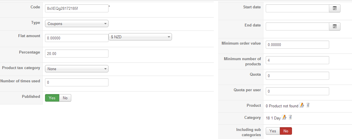

12 years 9 months ago #130222
Your problem is coming from the fact that the Minimum number of products is applied for ALL the product in your cart, so if you have 2 products in the discounted category, and 3 other products from another category, the coupon that will be auto loaded will be the 8xXEQg28172185f one.
12 years 9 months ago #130303
My bad, when you use the Category and the Minimum number of products options, you should set the Coupon percentage applies to product only option to YES to apply the Minimum number of products option only on your category.

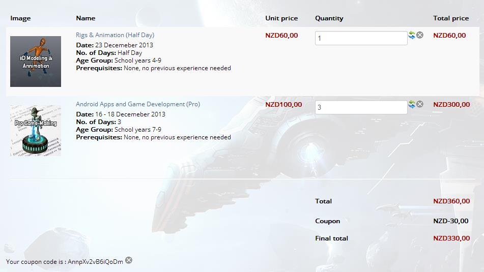

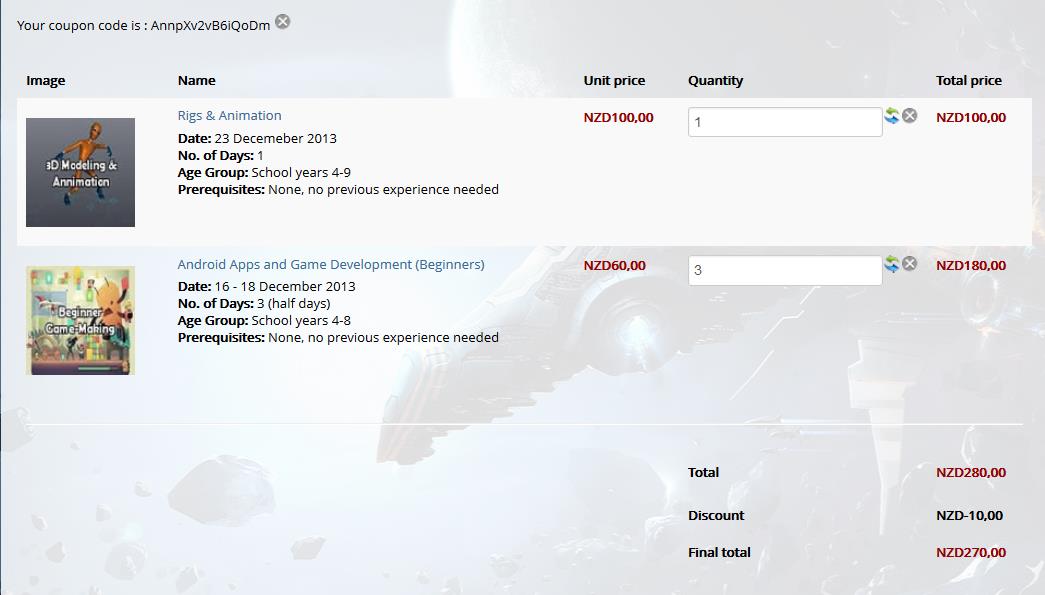

From the screen below you will see that I have two items, one of which is a discount item. The problem I have (and I am not sure if there is a way around this is that this should be seen as three items as they have purchased three). Hika however only applies the 10% discount as it sees it as a single item.
Is there a way around this as I need it to be seen as three items?
If I added another single day item I would then need the 4 day discount applied etc. Basically an order of 3 items (even if the same item) needs to been seen as 3 products for discount purposes.
Thanks for your patience and great support in this matter.

  • Posts: 139
12 years 9 months ago #130381
Alas this is still not working, see image attached.
The value of discountable products is $100, yet Hika is taking the non-discountable product into account too.. there should be not discounts (I have renamed coupons to discount in the language file) in this scenario.
The issue seems to be of a similar nature to what was happening when I was testing by product quantity.
(Just so there is no confusion, I have renamed coupon in the checkout to discount (using the language file), so wherever you see discount in the front end it is actually a coupon)
Coupon - renamed to discount in frontend
Last edit: 12 years 9 months ago by abasel.
12 years 9 months ago #130475
Your configuration seems to be good.
The coupon should be applied only on the products of the category "1 Day" if the order is upper than NZD200 and it's applying to product only.
Are you sure that the half days product is not in the 1 Day category ?
  • Posts: 139
12 years 9 months ago #130509
Yes, see screenshot
