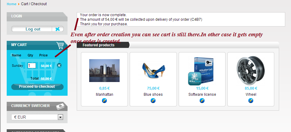

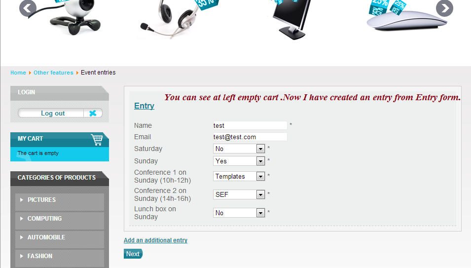

12 years 9 months ago #130098
The problem is once order is created all cart products should be removed.I have attached two snapshot.
Please have a look and let me know if not clear.
