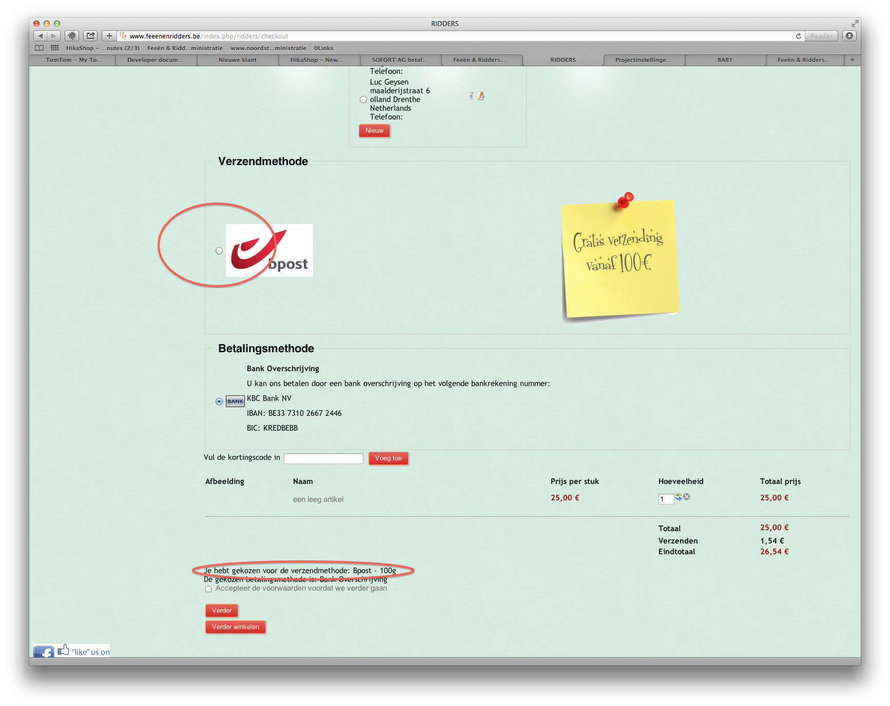

If I want to buy an article of the shop and go to the shopping cart in order to finish my shopping I get the opportunity to select the shipping and payment method. The shipping method is not selected although at the bottom of the page you can find the information that I selected a shipping method (see screen1). When I click the button before the shipping method the page reacts as I am clicking on the submit button. Any idea what is going wrong? I got this new behavior since I upgraded from 2.0.0 to version 2.2.2.
Wbr, Luc

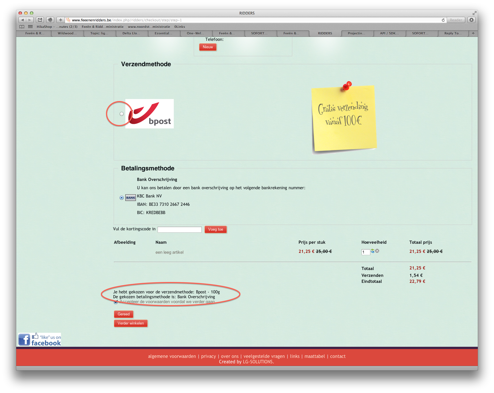

I did what you told me, but…. Now when I go to my shopping cart, I select the shipping method (in attached screenshot only one available), I select the payment method, I select the agree with conditions and press 'next' button. Then the shipping method will be unselected again and it has to be selected again before we can go further with the payment. There is no indication that the problem is that the shipping method is not selected. Please have a look at this!
Wbr, Luc

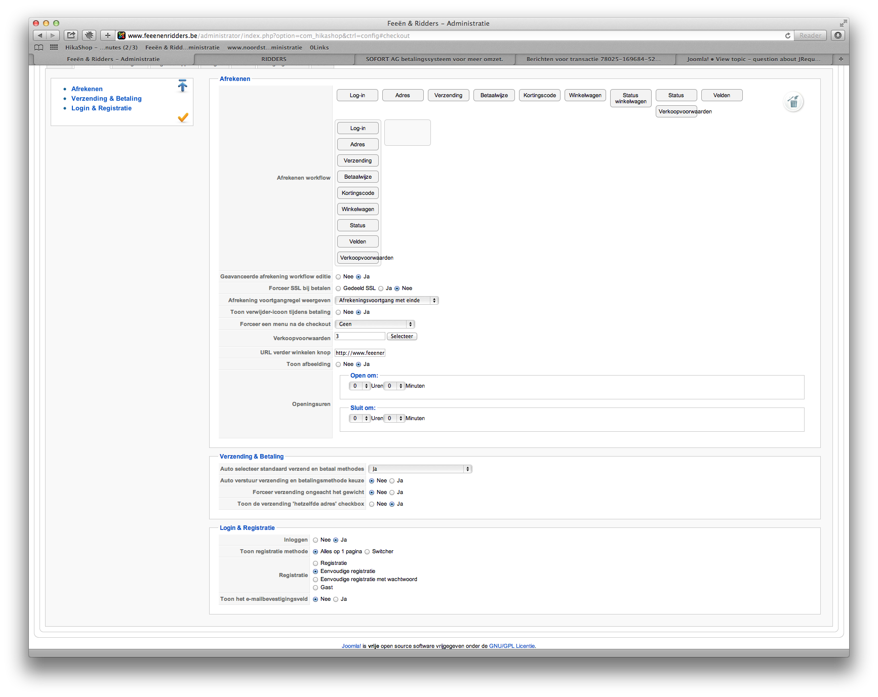

Please provide a screenshot of the Checkout tab of the configuration.
  • Posts: 45
12 years 8 months ago #133380
If I put the Auto select default shipping and payment methods to yes or to no, both settings generate same problem!
