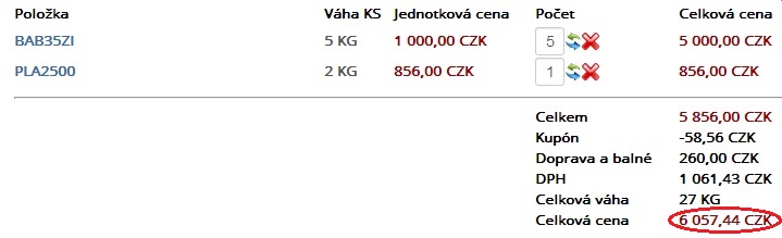

I can't find solution to round total price when using coupon. Can you please give me some advice to do that?

I'm using coupons 1%, 2%, 3% with some conditions and checked "Auto load in cart if possible". In my opinion I can't force the result of them to be always round, so I assumed that it's easier to round final price. Am I not right?

thanks for the link, but I didn't get it correctly, obviously. With high probability I have to find that part of the code that is responsible for coupons. Am I right? Can you point me, please, at that part?

The code modification proposed in the other thread will apply to all the calculations, including the coupons so that should be the correct place.
