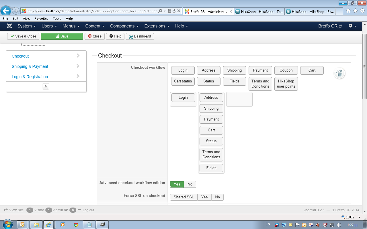

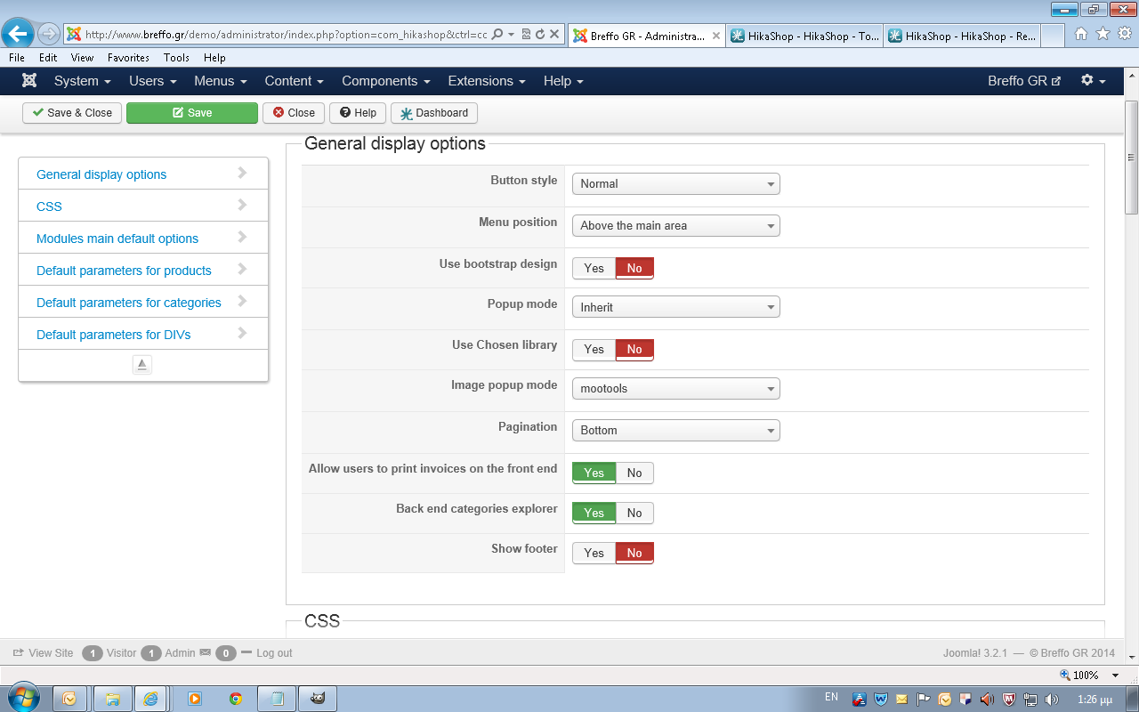

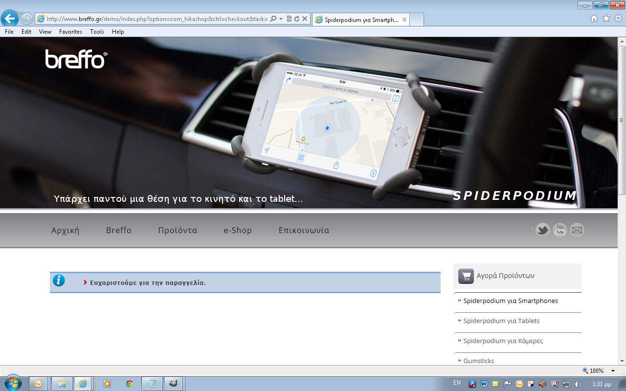

12 years 4 months ago #140336
I thought I could do it through Hikashop, without any coding.

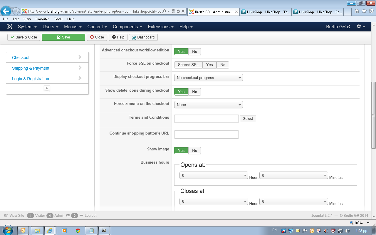

What's the meaning of "Allow users to print invoices on the front end", then ? I have enabled it and the user cannot see its invoice ant the checkout end.
Unfortunatelly the site is in Greek and although I can send you some screenshots, I don't think you can read them.
What I only get at the end of the checkound process (after the bank payment) is the message "Your order has been confirmed" (translated from Greek). I expected to see some invoice details there, not only the message.
I attach the back-end screenshots, about the checkout workflow and the display options. Also attached the final message the user gets after the bank payment (unfortunately in Greek).
If you need anything else as info, or further clarifications, pls let me know.
Charis

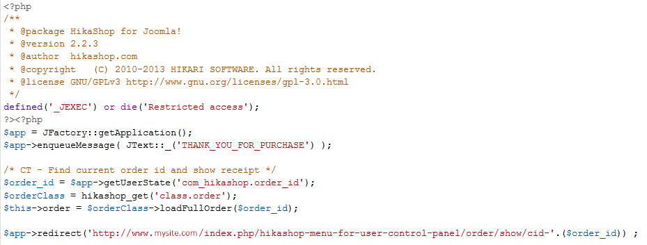

  • Posts: 11
12 years 4 months ago #141051
Hello Jerome.
Thanks for your reply. I've done it by adding some code in after_end view. In order to help everybody there, the extra code is the following one (adjust the URL accordingly) :
$order_id = $app->getUserState('com_hikashop.order_id');
$orderClass = hikashop_get('class.order');
$this->order = $orderClass->loadFullOrder($order_id);
$app->redirect(' www.mysite.com/index.php/hikashop-menu-f...ow/cid-'.($order_id) );
Charis

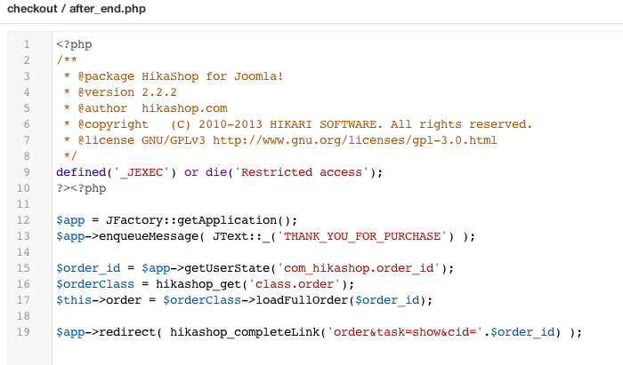

  • Posts: 35
11 years 11 months ago #161678

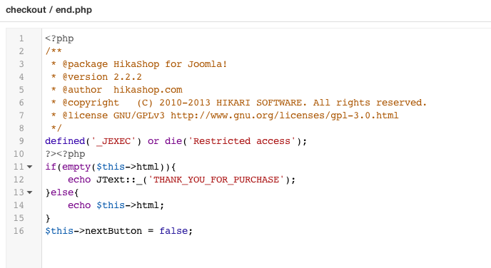

I thought I found an answer with this topic, but nothing happens when I add this code to the after_end view? (See Attached Screenshot)
Even odder is that I configured the checkout workflow to have my checkout display an end, but that just makes the checkout page never finish the checkout at all when I have this option selected? It just sits there and looks like it wants to load but never does anything?
When I convert back to display the checkout "without an end" the checkout process goes through, but I still only get the simple thank you message, no redirect to the order page?
Finally I thought maybe removing the code from the after_end view as shown below would possibly help:
$app->enqueueMessage( JText::_('THANK_YOU_FOR_PURCHASE') );
But even after I remove it I still only get the thank you message. Which completely confuses me because if I removed that code the thank you message should not appear after a payment is processed right?
I could use some assistance in getting this to work, perhaps I am missing something here?
Thank you for your time!

You may find attached the screenshot from my admin panel. (I've just only replaced the site name with mysite.com)
