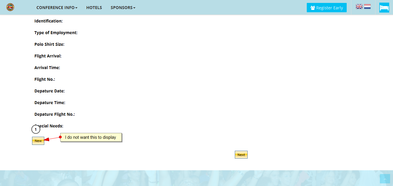

After completing the registration form in the checkout process, I click next which takes me to a confirmation page entitled "Billing Address". At the end of that form is a New button. How can I get rid of or cause that New button not to show? See attached example.

Hi there,
You should have a look at our documentation about display customization: www.hikashop.com/support/documentation/i...ize-the-display.html
In this case, adding this to your css file might do the job:
.hikashop_cart_input_button{
  display: none;

I did add code, but it does not seem to work. The new button is still there on checkout. Could you say in which css I should put it?

You should add that CSS instead in the CSS file fo HikaShop :
#hikashop_checkout_billing_address_new[display:none; }

I have added both of the codes to the frontend_custom1.css, however the "New" button is still on the page when I am checking out. Please help. The site is ready to be launched to the public, this week.

If you had look at the link we gave you twice, you could have find the answer in less than 5 minutes.
Here is the right css:
#hikashop_register_form_button{ display: none; }
It took me 2 minutes:
- Find the page of your website
- Right click on the button -> inspect element
- spot the id: "hikashop_register_form_button"
  • Posts: 53
12 years 6 months ago #142852
Thanks for the verbal abuse (LOL) Eliot but that did not work either (afterall the class of the button is hikashop_checkout_billing_address_new). But not to worry. I found an alternate fix of some sort. I went to Display > Views. In that section I selected my Front End template > Checkout > Address_view (.php).
