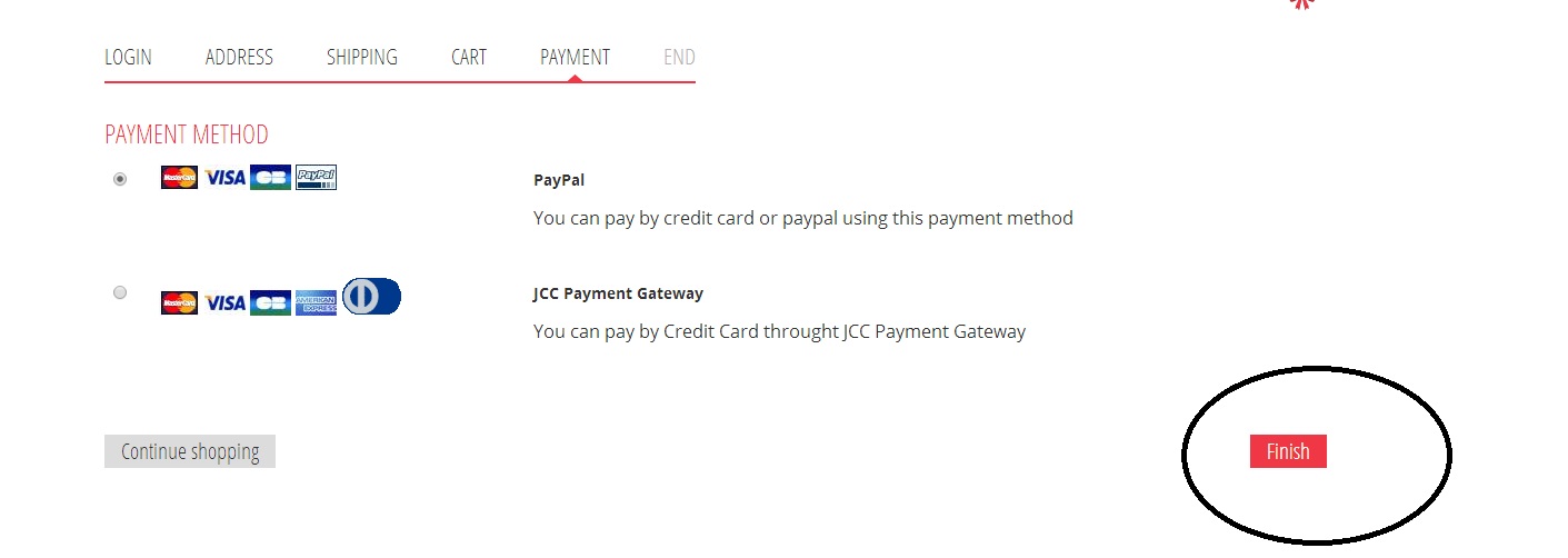

Hi ,
we face a problem on the checkout process .
when the user is to the last stage of payment he have to click two times on the FINISH button to can proceed.
the first time nothing happens and the second time proceeds.
fom our site we disable any style changes fo that page and the problem remains
could you advice pls how to fix that.
thank you .

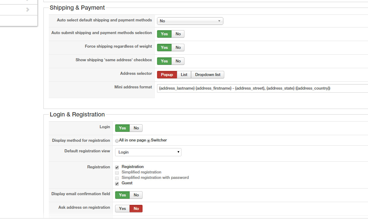

12 years 6 months ago #141659
The solution will probably be to set the "Auto submit shipping and payment methods selection" option to YES through the page "Hikashop->System->Configuration->Checkout".

12 years 6 months ago #141696
I think that you have to click 2 times on the "Final" button because :
- On the first click : you're manually submitting your shipping or payment methods selection
- On the second one : you're moving to the final step.
Did you tried it with the "Auto submit shipping and payment methods selection" option to YES ? if that's not how you want your checkout to work, can you please give me more information ?
