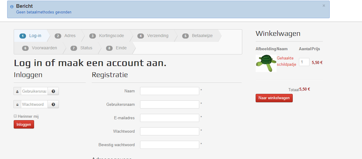

I have a question about the checkout cartstatus
- is it possible to rename it because in the front end the module name is fully written, see pic, i just want to rename it to status only
- is it possible to change the position of login and register, i want login above register instead of side by side.
Thanks, michel

1. Your can rename it by adding a translation override like that:
HIKASHOP_CHECKOUT_CARTSTATUS="Cart status"
2. You can change their position like you want as explained here:
www.hikashop.com/support/support/documen...tml#registration_box

Stil i dont understand where to change the layout of the hika shop checkout page, when i start to check out i dont want the side bar with the module add to chart. (for the cutomer i prefer page with only the hika shop checkout page
see attachment "winkelwagen at sidebar 2 , that one has to go when people go to checkout

  • Posts: 7
12 years 5 months ago #143739
thinlk i solved it, it cant be in a seperate module at all
now the add to chart is a popup, that works fine and the checkout page is a single page
