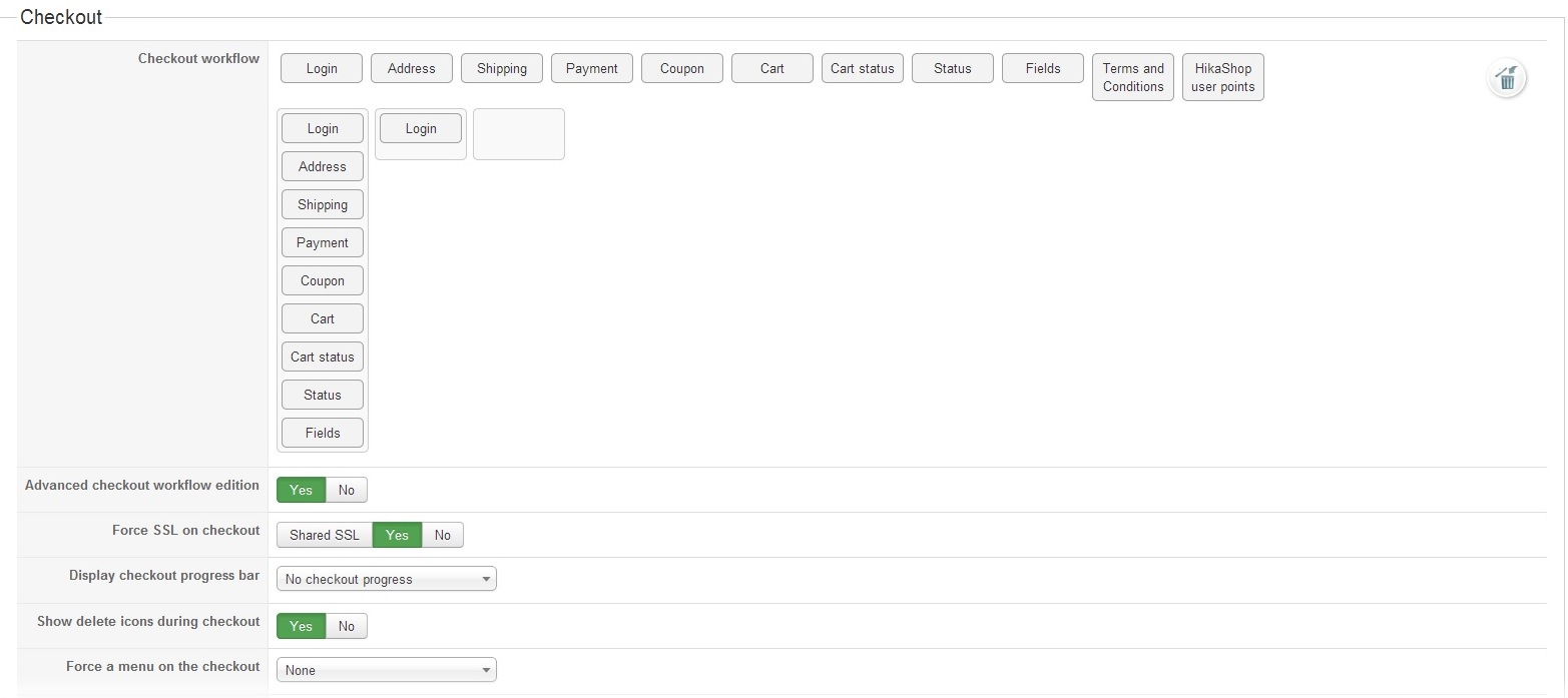

Customers cannot complete checkout. Get caught in an endless loop of "select billing address" --> next --> "select payment method" --> next --> "select billing method" --> next --> "select payment method"--> ... etc...
Never ending loop.
Just upgraded. Previously used to work just fine before I changed to "guest" registration
How can I get them through checkout procedure?

I'm not getting a loop on your checkout. I just did a test and I got to the paypal payment page.
It's a bit strange though to have the login view on a second step all alone. Even more so that you need to be logged in to go to the second step and thus the second step just displays the "finish" button.
I would also recommend to turn back on the "auto submit" option of the checkout tab of the configuration so that the payment and shipping methods selection is a bit easier for the user based on how you configured your checkout.
