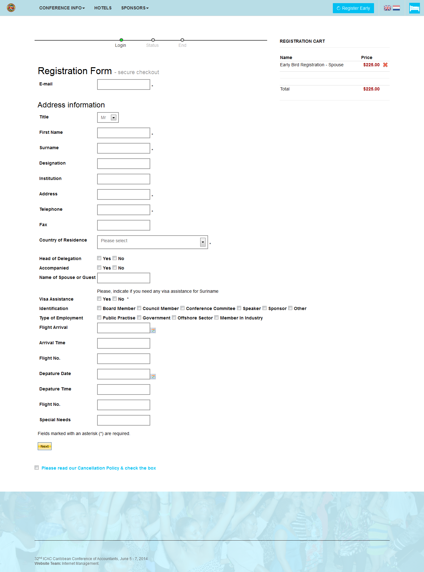

Great. I have created the new form, but how do I link it to the product? When I create a form, by default (via the no registration option) it calls the address table. How can I get the product to call the "product" form I created using custom fields?

Thank you Eliot, You have been remarkable with your assistance, but can I give you access (via PM) and you may inform me what may be wrong. It is just not working properly for me.
Even if I un-publish the fields from address and place under the "table" product, upon checkout, the user would still see/use the same form. I wish for a different form for the product Spouse, then another form with differing custom fields for the other two products, Non-member & Member.

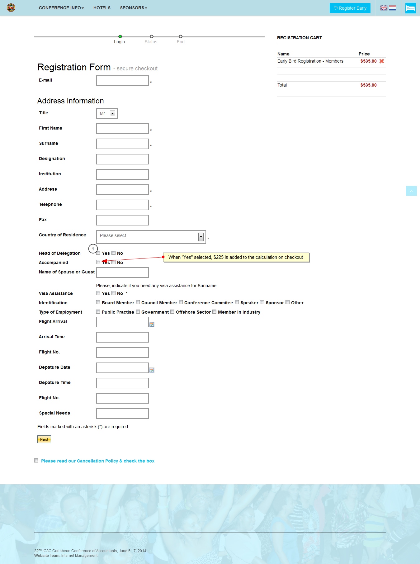

Sorry, I may be getting it all wrong B) . Is there a demo I can see?
When I set it up, I do not see the fields or the new form on the Product page. See my test page I set up with your instructions ( 2014conference.icac.org.jm/android-2.html ). There are no fields there. And when I click on "add to cart" I get the same form.
Let me try to explain a little more clearly. I wish to have 2 different checkout forms. The one that is currently there (hf85a1b0.png, it appears after you click on the "add to cart" link) and another form with different fields, when you click on another product.
If that cannot work, then how can I develop the current form so that the checkout form can add the price of $225 to the existing calculation if "Yes" is selected. See image attached (ha3f9095.png)

  • Posts: 86042
  • Thank you received: 14174
12 years 5 months ago #144041
This is the registration form, it displays on the checkout not on the product page and thus it is common to all the products.
I'm talking about the product page which is where you see the add to cart button. there, above the add to cart button, you'll see your custom item field after you create it and you can have there different fields for different products.
