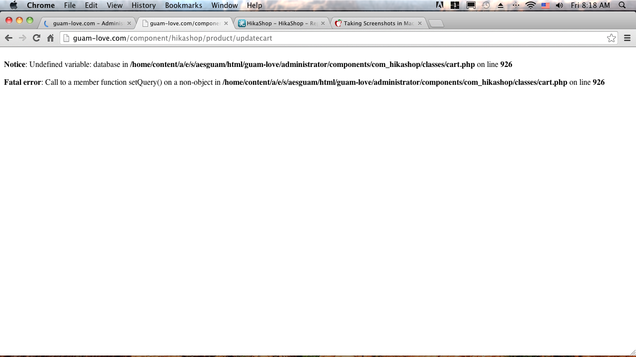

Also, can you :
- Active the Joomla debug mode ("Administration->Global configuration->System->Debug System/Language")
- Set the "error reporting" option of the Joomla configuration to "maximum"
- Test it again so that we can see if it display an error message.

12 years 5 months ago #143959
hi mohamed
the error still persist but after setting to what you tole me to set it to i now get this when doing the same function

  • Posts: 86042
  • Thank you received: 14174
12 years 5 months ago #143975
Please download again HikaShop on our website and install it again and that should solve the problem.
