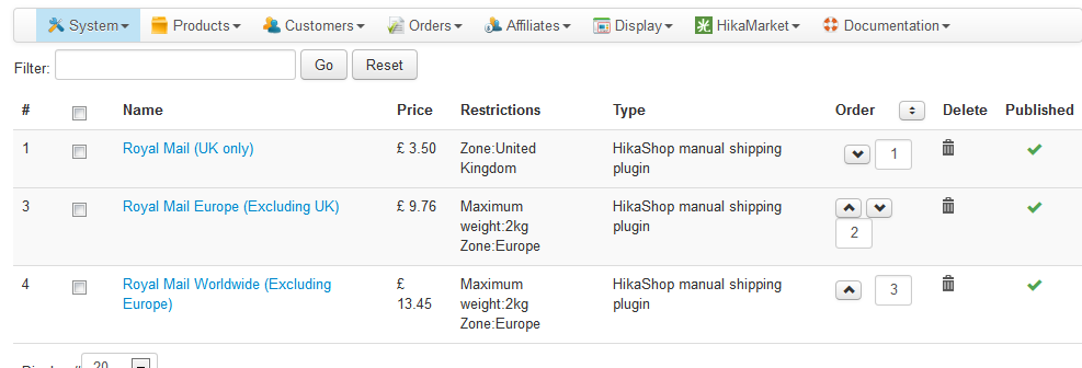

Here is my shipping methods:
Trevor

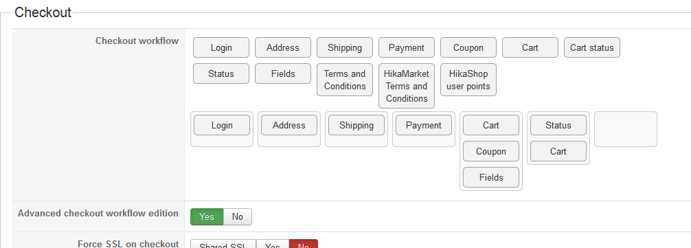

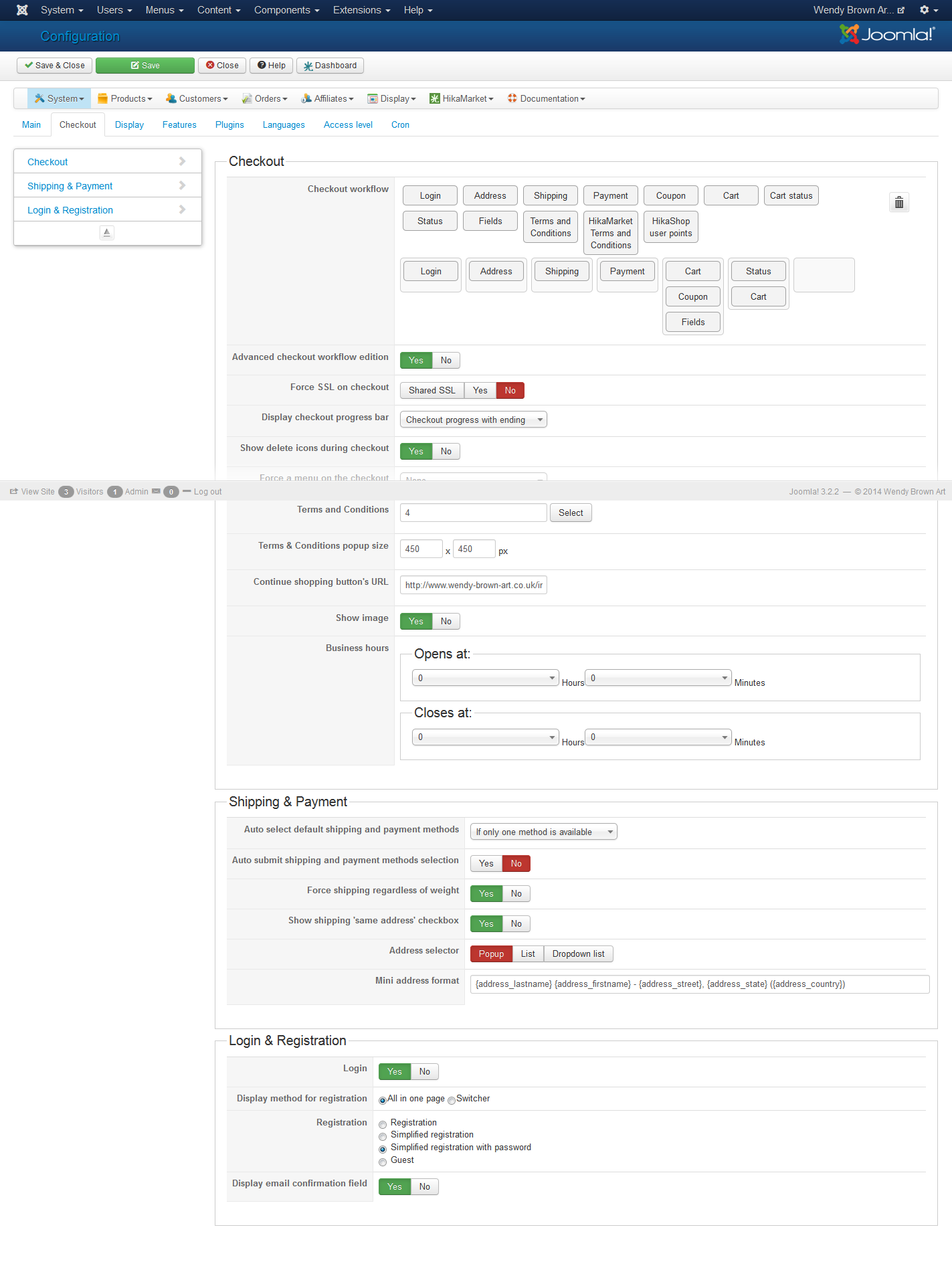

Could you check that your template able to display system messages ( www.hikashop.com/support/support/documen...tibility-issues.html ) and could you also provide a screenshot of the rest of the options of the Checkout tab of the configuration ?

12 years 3 months ago #145265
The display does show system messages but I switched to the Beez template and tried the checkout but no messages were displayed.
Here are the full settings for checkout tab:

12 years 3 months ago #145291
Tried a few things without success. . .
  • Switched to the Beez template to see if it made a difference
  • Rearranged the checkout layout so that everything is in one step but I am returned to the address each time
  • Renamed the com_hikashop folder in the template/html folder to make sure my customisations were not causing it.
  • Created a new shipping method without any restrictions.
  • Disabled Admin Tools just in case it was having an effect.
Trevor
