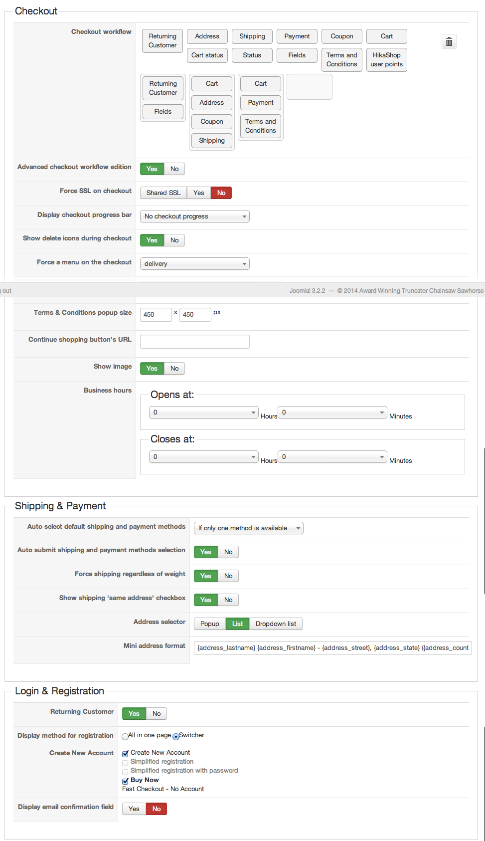

12 years 5 months ago #145898
Can you show me how did you configured your checkout workflow ("Hikashop->System->Configuration->Checkout") through some screenshots ?
  • Posts: 28
12 years 5 months ago #145900
I have attached here. I have played with the check out config
Returning customer on/off
And checking/unchecking the following
Create New Account
Simplified registration
Simplified registration with password
but all with guest ask for name field.
This is an Edit
It's not working so I've turned of Guest as I think it's losing sales. I'm happy to turn on again just give me a heads up so I can turn on
Edit number 2!
I really like the guest login and I believe that customers should have the choice.
I now have the set up running
with create account running with Simplified registration so the fields are the same and therefore the checks are not conflicting. I'd love the switcher to work as it was. Please give me a shout and I'm happy to put it back to the above config to get it working

  • Posts: 28
12 years 5 months ago #146074
It is because I have set the system to simplified registration rather than normal. as the fields are the same as guest it's working!
If you can PM me a time you could take a look I'll switch it back to the normal account set up.
Sorry but we are taking orders.
All the best
Steve

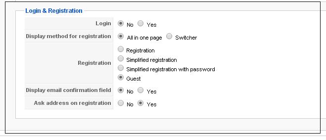

  • Posts: 10
12 years 5 months ago #147414
I think HikaShop is trying to register the email and you hit the error that the User is already registered.
Is it not possible to skip the registration when the configuration is set to Registration=Guest.
OK, stepping back our requirement is that we do not require the user to login but like to capture the email and address in the order. It is not possible to create a workflow which has address without login in the first place. Can that restriction be lifted? Guest users can provide the address which is saved as part of the Order, simple. Makes sense?

  • Posts: 10
12 years 5 months ago #147474
Whether the visitor is a Guest or a Registered User, I do not control that as a site developer. They simply enter their email and address as part of checkout and Hikashop should make no attempt to register the email ID and fail the checkout. It should simply record it as part of the Order, that is what I am asking for.
  • Posts: 10
12 years 5 months ago #147482
I found a workaround for this.
1) Delete all customers from Hikashop
2) Disabled user account plugin in Joomla, so no new customers are created.
3) Set login to NO and use only Guest option on Checkout.
Works for my use case for all users.
Cheers
