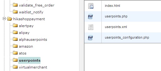

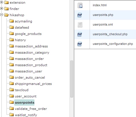

  • Posts: 26381
12 years 5 months ago #146189
"userpoints.php" in both folders.
You will find two lines with the part of code I pasted. Please be careful to just replace the code I pasted with the other code block, do not remove more content, do not replace the all line.
You can do a "search & replace" with the exact content if you want..
