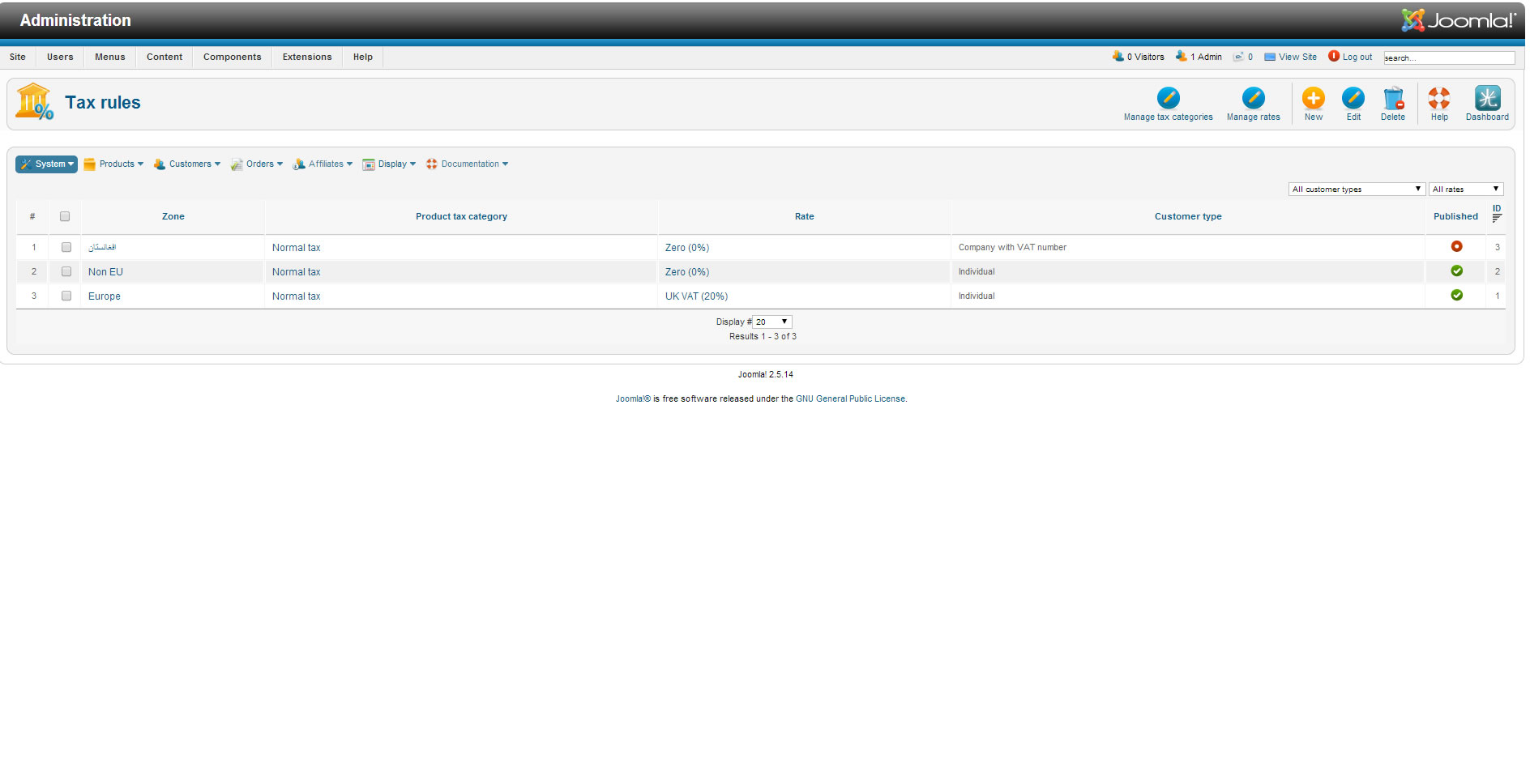

We would need more precise information on your setup in order to help you.
Could you provide a screenshot of your tax rules ?
  • Posts: 234
  • Thank you received: 4
12 years 4 months ago #151618
Hello
I hope this helps.
Yours
Iain
12 years 4 months ago #151644
Thanks to check if there is no countries not desired in your Non EU zone, and that all the desired countries are present in the Europe zone.

Yeah all fixed. My issue was that I didn't need a Non EU zone, because by default anything not in a zone is classified as zero rated.
