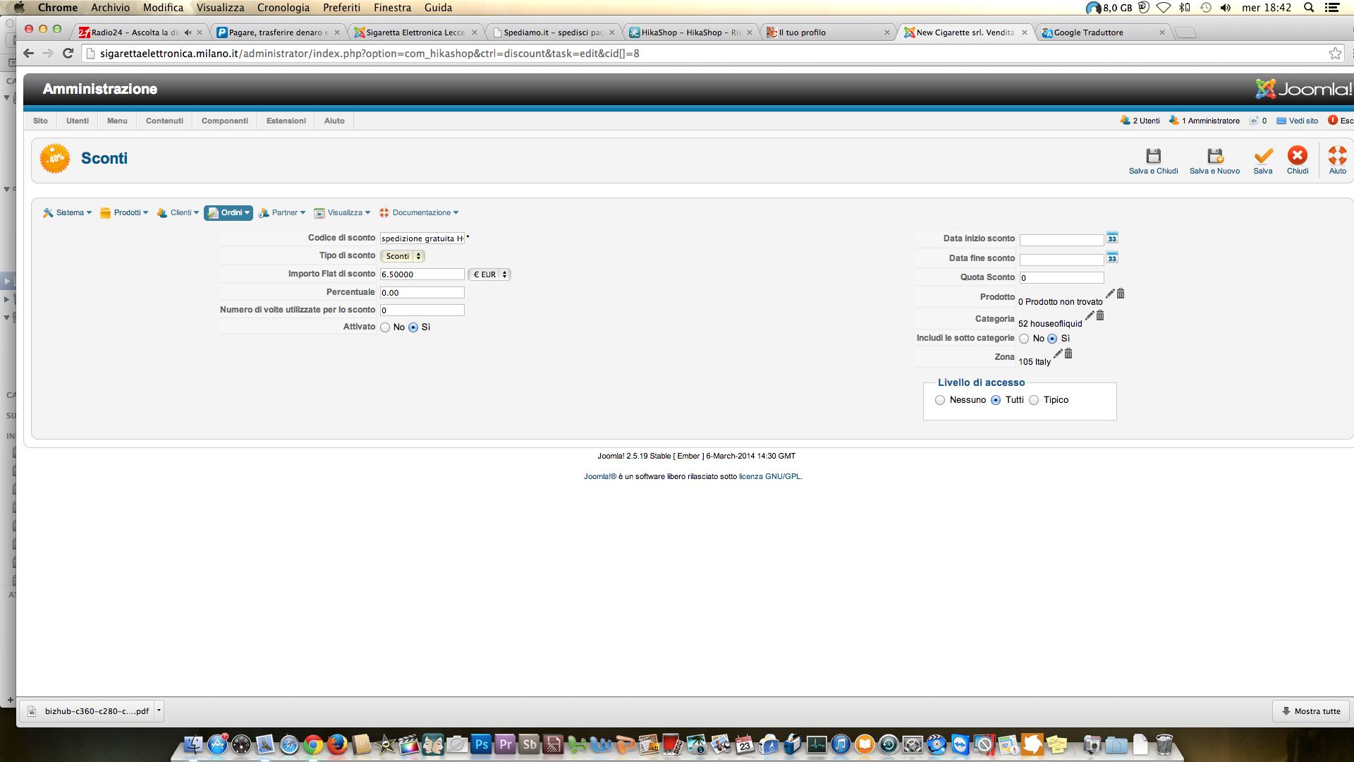

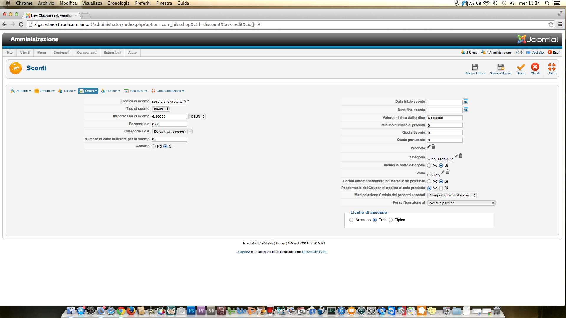

  • Posts: 17
12 years 3 months ago #153297
HELLO
thank you for your reply but creating a DISCOUNT do not have the ability to enter a maximum amount (like 40 €) beyond which the discount is applied

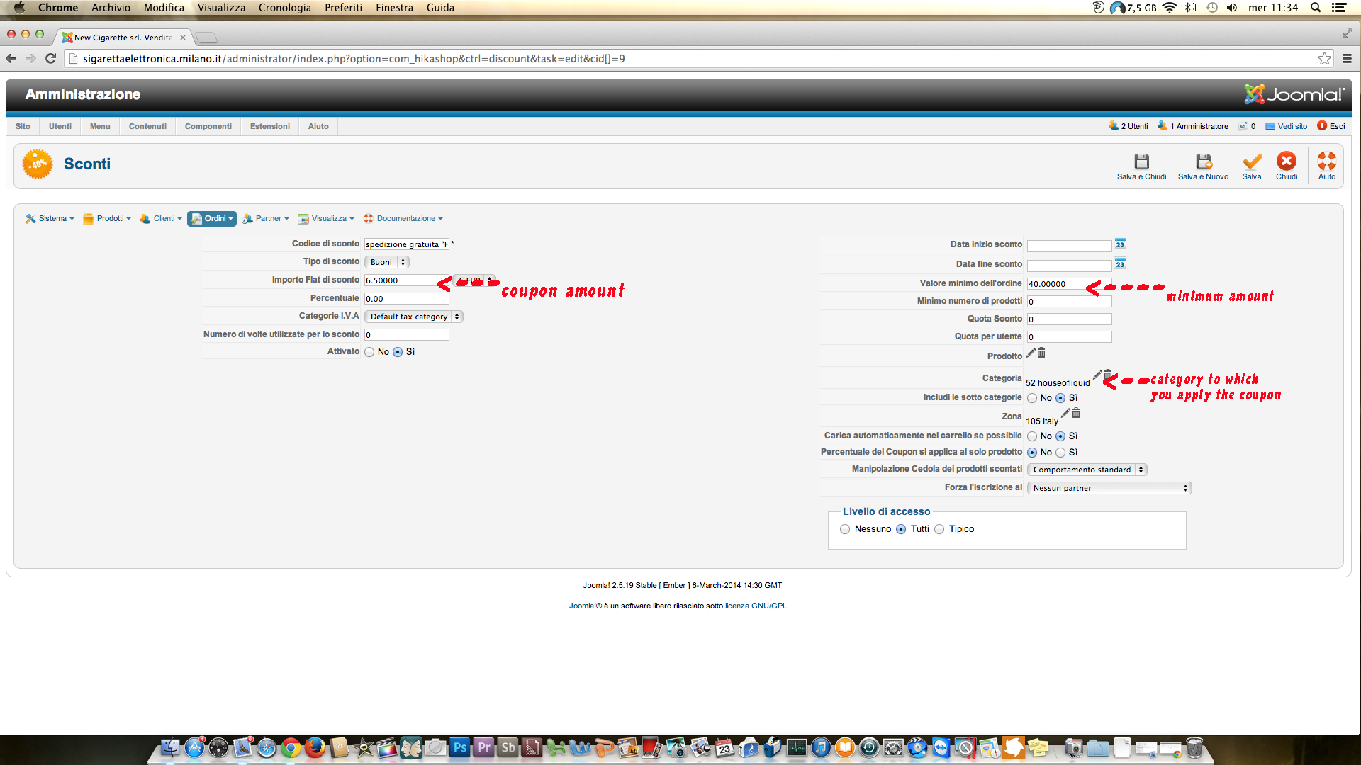

  • Posts: 17
12 years 3 months ago #153302
I'm sorry but I still wish that it worked out this form attached with the settings inserit: coupon amount, the category to which you apply the coupon, limit to apply the coupon.
unfortunately is not complied with the minimum liminite (40 €) set

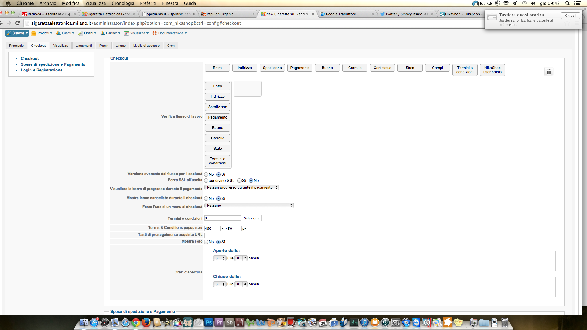

  • Posts: 26381
12 years 3 months ago #153300
Ok I see, you want an auto-loaded coupon, not a discount.
Please provide
- a link to your website
- some information about your Joomla and your HikaShop versions
- some details about how accessing the products which are in the targeted category for your auto loaded coupon.
- a screenshot of your checkout workflow
Please note that a coupon will be loaded when the step "coupon" is in your checkout workflow
Please note that you put a restriction on the address, the customer should be logged and should use an address in Italy.

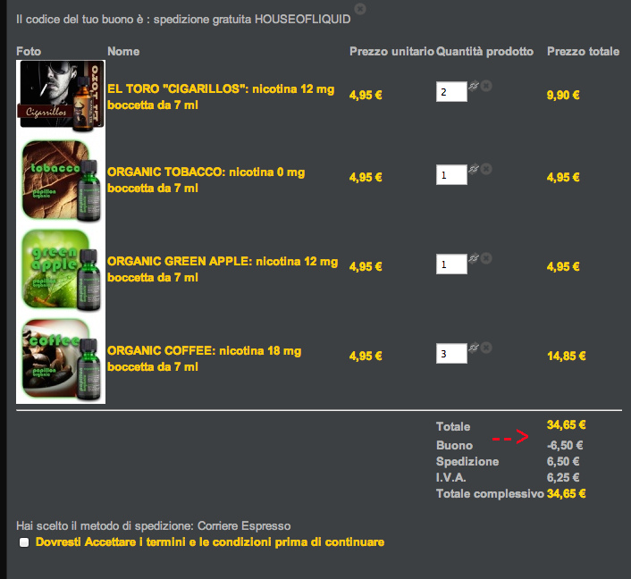

  • Posts: 17
12 years 3 months ago #153639
Hello, thank you for your answer and proof that you did.
I have to tell you that but it is not always as it should be in the form does not always work properly
I attach a photo as you see the coupon is activated even under 40 €

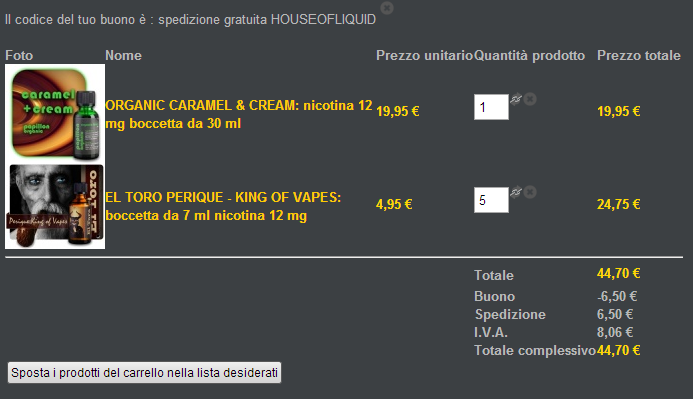

  • Posts: 17
12 years 3 months ago #153640
I have to tell you that but it is not always as it should be the module does not always work properly
I attach a photo as you see the coupon is activated even below 40 €
12 years 3 months ago #154315
Hello and sorry for the late reply,
That's maybe a cache issue, can you disable the Joomla cache, and clear it ? You'll also have to disable it in the joomla config, and unpublish the cache plugin. Also can you clear your browser's cache and try it again ?
