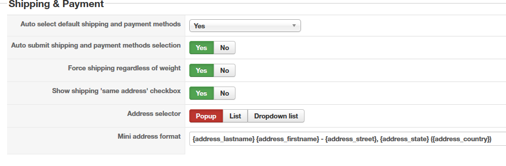

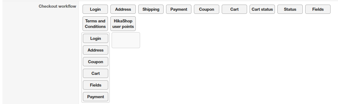

I have had a site up and running for a few months witha few orders.
Today I received a call from my client saying that a customer could not pay. There is only one payment method which is Paypal.
I logged into the site and created an order but when trying to pay the page remained on step/step-1 and would not submit. I eventually removed the shipping options from the workflow (noticed this was posted on the forums elswhere) and the problem appears to have been resolved for the time being at least.
Is this possibly a bug?

Was there any system message displayed ?
Do you have shipping methods set ?

I doubt that this is a bug. Probably a configuration issue with the shipping methods.
Normally it should display an error message on the checkout explaining the problem, but maybe your template is not displaying error messages:
