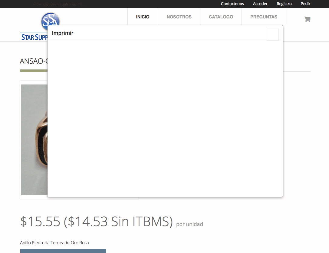

But you have a different problem:
As soon as anything gets added to the cart, an "invisible" popup of immense size blocks out the main menu and other stuff.
Its HTML:
<div id="modal-hikashop_print_popup" class="modal hide fade" style="width:780px;height:570px;margin-left:-390px">
You can only make it visible by removing the class "fade" (which has a "top:-25%;" from bootstrap.css, so it slides down a bit when "fade" is removed), and then it looks like in the attached screenshot.
I'm the last one to know where that's coming from, but it seems to be there as soon as something is in the cart, and gone when the cart is empty.

What error do you get exactly ? Could you do a screenshot ? Could you try with the error reporting and debug mode options of the configuration of Joomla turned on ?
It's probably a memory limit error, and in that case, the solution would be to increase the memory limit parameter of your php.ini.
For the popup issue, it's usually a problem with the template of the website. Changing the "popup mode" option of the configuration usually circumvent the problem.

Regarding the popup, I just checked your website but I don't see the overlay problem anymore.
