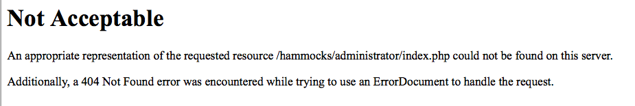

Thanks for that, when I try to make the changes to the email templates I get the below error, I literally deleted 2 TDs with the billing address information? any ideas?
"Not Acceptable
An appropriate representation of the requested resource /hammocks/administrator/index.php could not be found on this server."

This is probably the server security module which is refusing the request to modify the email because of all the HTML/PHP code in it.
You'll have to directly edit the email files in the folder media/com_hikashop/mail or see with your hosting company if the security system can be configured to not refuse the request.
