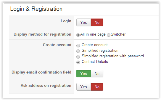

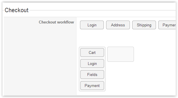

My Workflow is as follows
Login Requirements
Current checkout

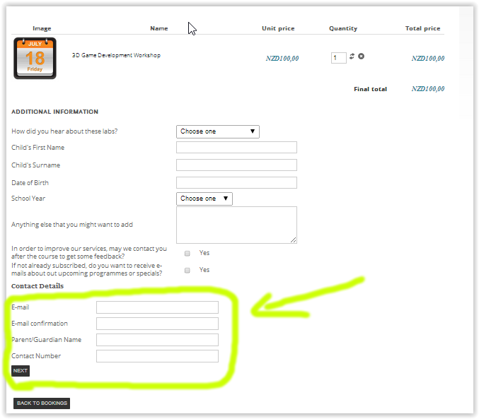

The issue I have is that when the user clicks on next it takes them back to the checkout page (with the user details removed) which can seem a little confusing.
Am I able to achieve one of the following:
1) On clicking next the user is taken directly to the next step in the process
or
2) The login page is on it own page so that the user gets the sense of moving sequentially through the checkout.
Not sure if I am making sense :-)

The whole process is working fine but some clients are finding the process confusing... the easiest way to explain is via this youtube video http://youtu.be/0p_RpEGRFQ8 .. sorry the sound is a little loud

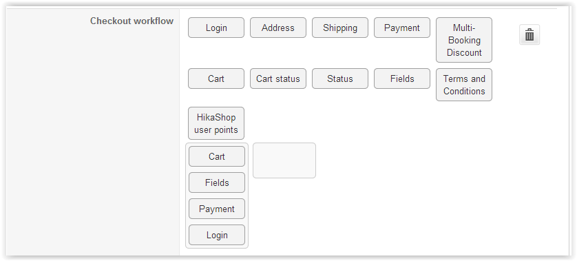

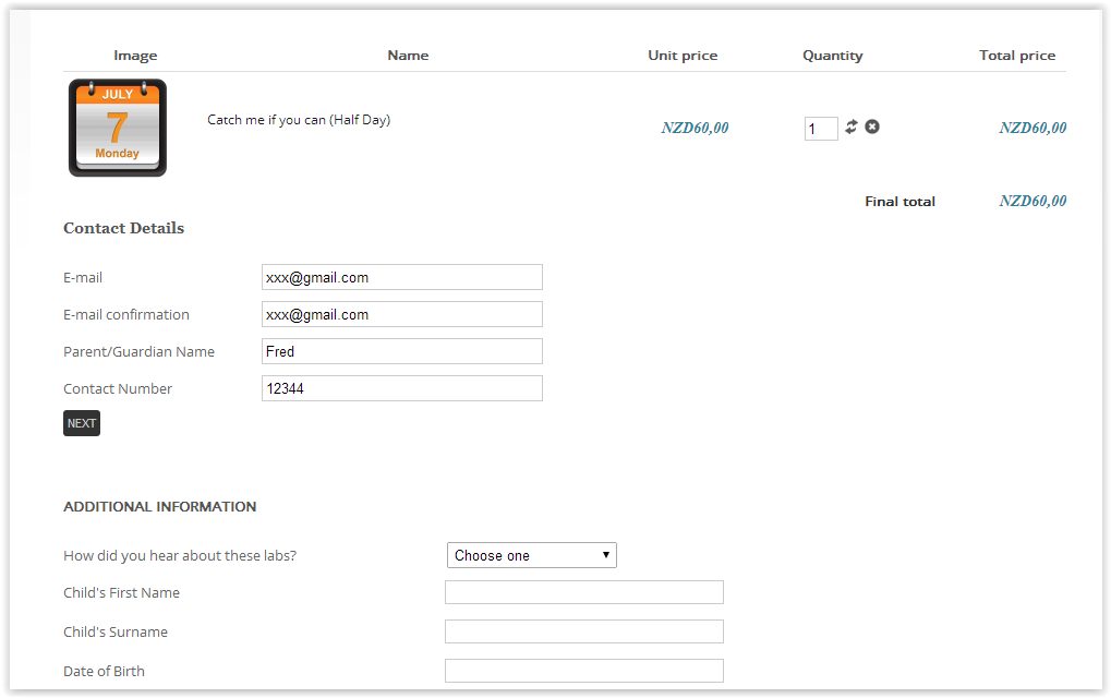

Ok, I think I have worked out how to explain what I am trying to achieve.
I have changed my workflow as follows
Checkout View
What I would like to happen if for the Additional information to appear only once the contact details have been entered. This would achieve the desired result as described in the video.

Thanks this is exactly what I was looking for, with respect to "checkout | fields",
I added
if($this->identified) {}
And it worked just perfectly.
