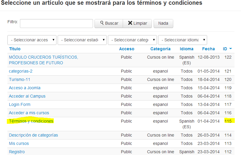

Hi:

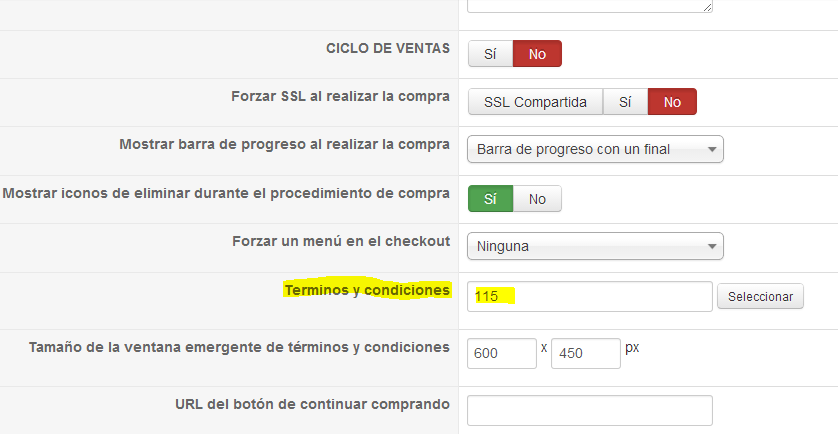

The 2nd step on checkout. would have to show the "Terms and conditions" article but its link is wrong.

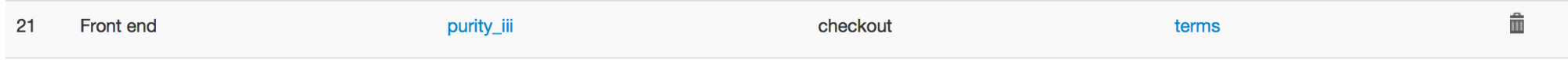

It's probably because the URL of the popup doesn't have an Itemid. In some cases, the SEF system of Joomla doesn't like that.
Edit the line:
JRoute::_('index.php?option=com_content&view=article&id='.$terms_article.'&tmpl=component'),
of the file "terms" of the view "checkout" via the menu Display>Views for your frontend template and add the parameter &Itemid=XXX where XXX is the id of a menu item displaying a joomla article and that should help avoid the 404 error for the T&C popup.

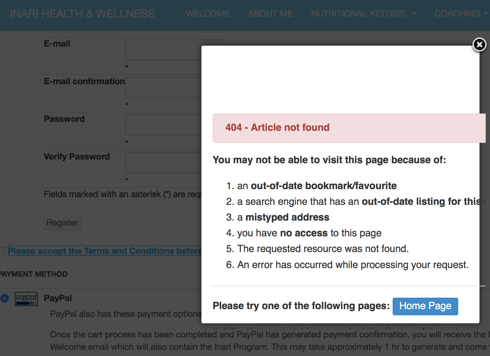

10 years 2 months ago #235183
Hi. I have this same issue. I have done exactly what Nicolas said to do, but it's still showing up with the 404 dialogue box.
-- url of the page with the problem -- www.inarihealthandwellness.com
-- HikaShop version -- : Starter: 2.6.1
-- Joomla version -- : 3.3.6
-- PHP version -- : x.x.x
-- Error-message(debug-mod must be tuned on) -- : Error 404

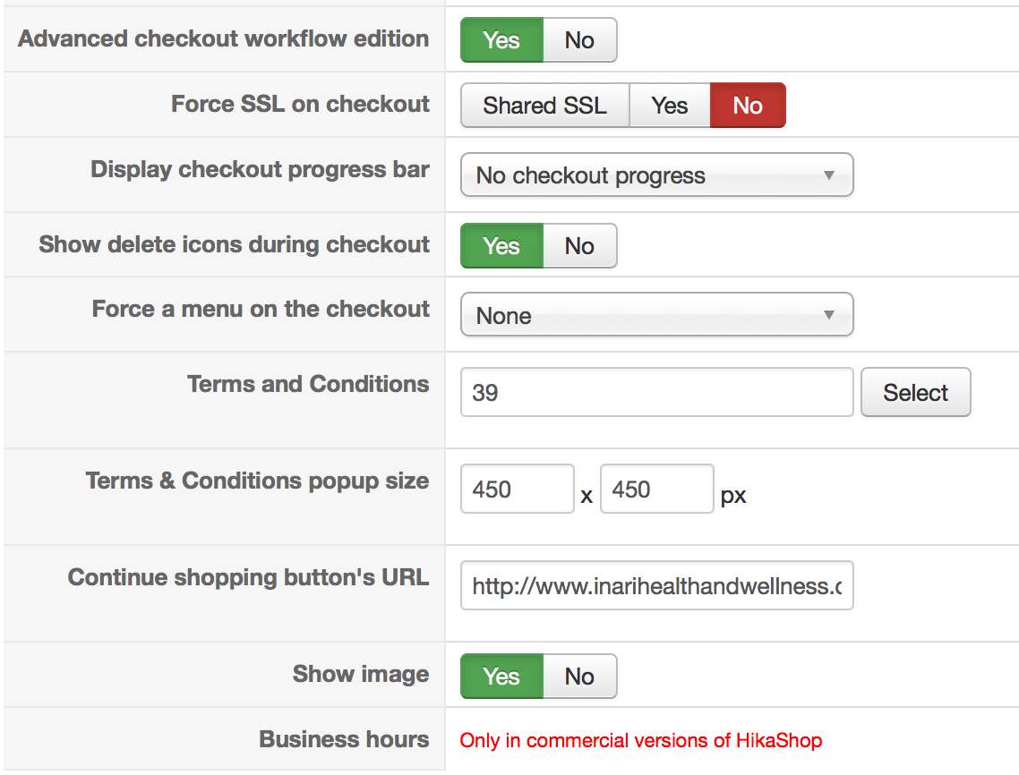

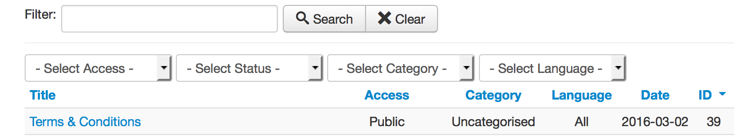

10 years 2 months ago #235216
Can you make screenshot of your configuration, especially your checkout, in Components => HikaShop => Configuration in Checkout tab AND the article (your terms and conditions) ?
Awaiting news from you,

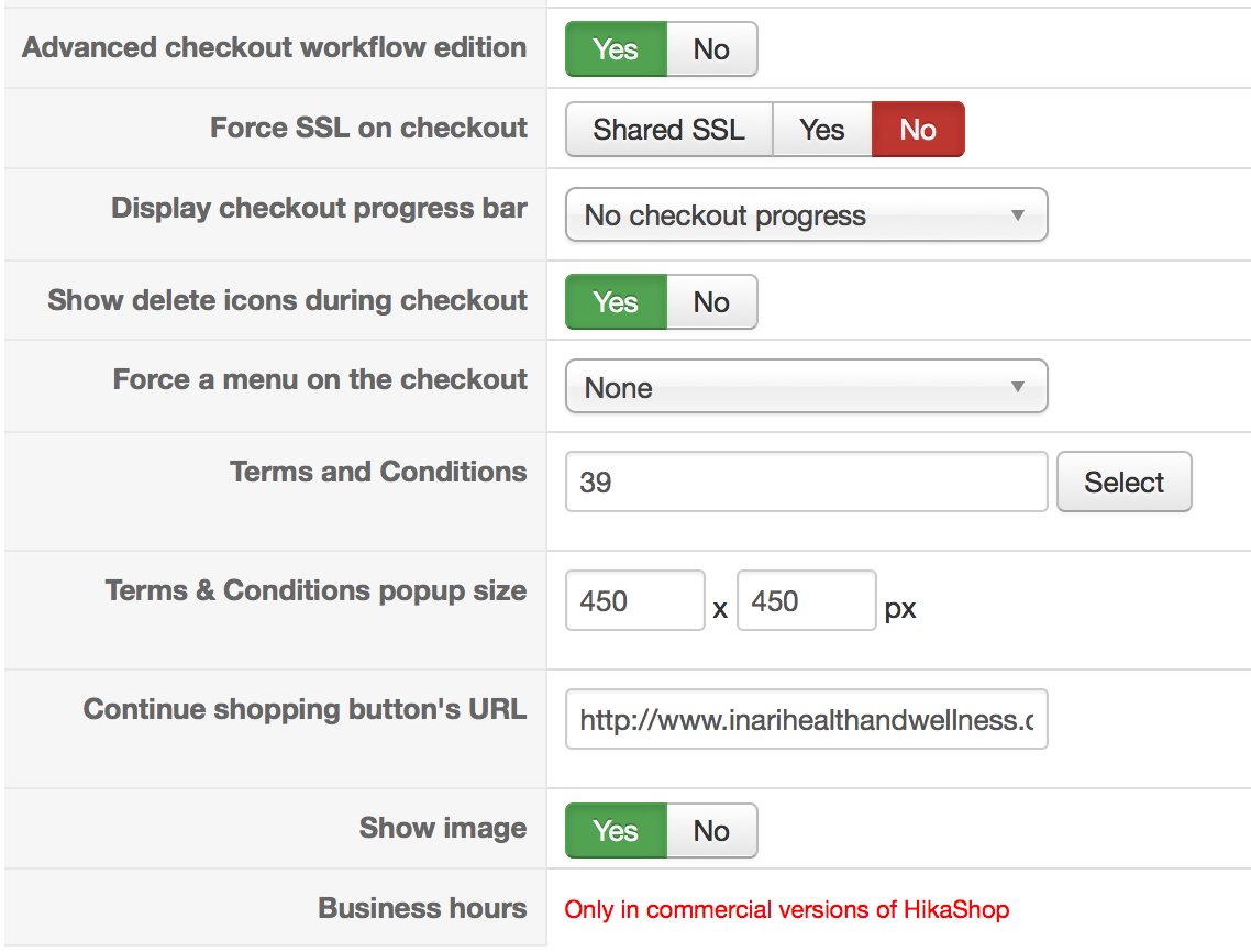

  • Posts: 10

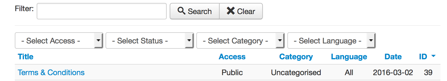

10 years 2 months ago #235294
Thanks Philip. Here are the screenshots.

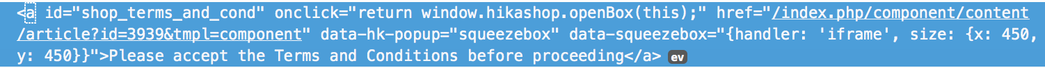

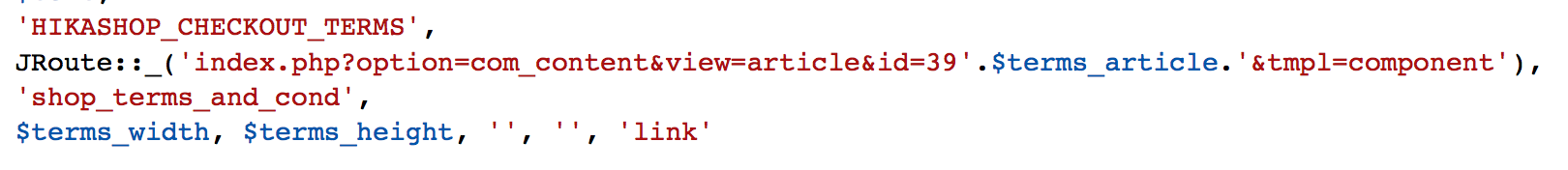

10 years 2 months ago #235314

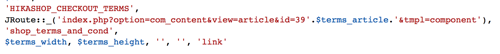

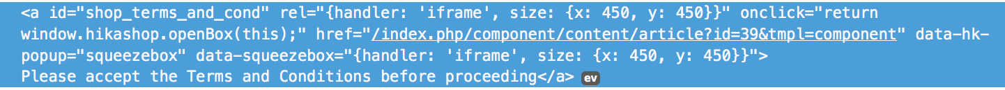

The issue is that in the view that you edited, the link is not correct.
You are forcing the id of the article, and using the option value, so the id is no "3939" instead of "39" that's why it can't load the content.
So in your edition you have to remove "39" from the url.

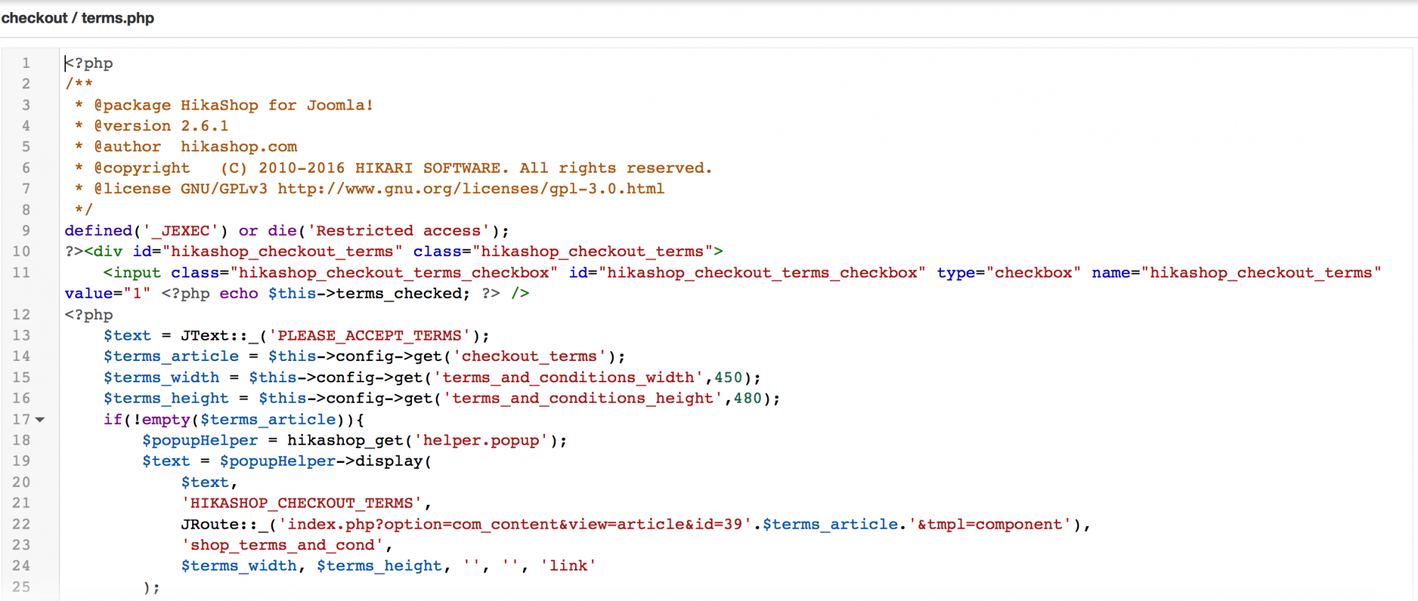

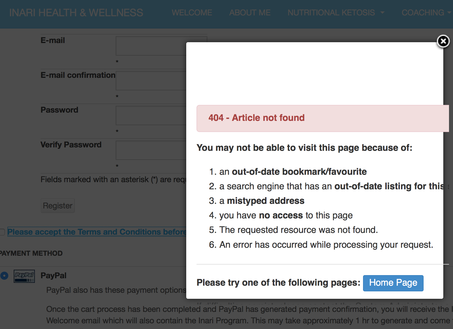

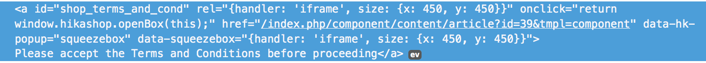

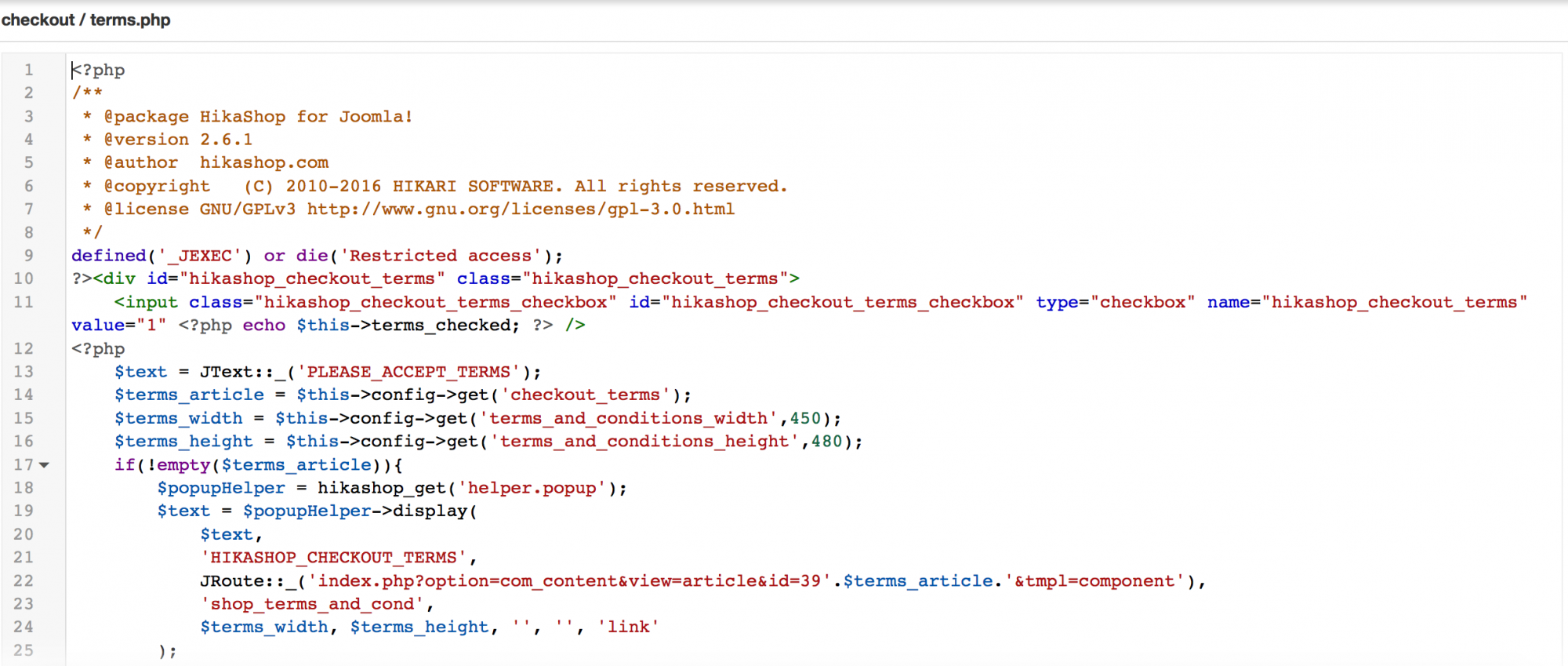

  • Posts: 10
10 years 2 months ago #235442
Ok, so I have attached screenshots. Without the customisation, the browser code (inspect element) shows correctly, but when I add the article ID to the checkout / terms.php, the browser code shows 3939. Both options, I am still getting 404 error.

10 years 2 months ago #235655
I found and fix your terms & condition issue.
To explain what I have done in Display -> Views and your terms in checkout view I replace the line :
JRoute::_('index.php?option=com_content&view=article&id=39'.$terms_article.'&tmpl=component')
By
JRoute::_('index.php?option=com_content&view=article&id=X'.$terms_article.'&tmpl=component&itemid=39'
And I set a category for your Terms & Condition Article (without this that won't works)
Hope this will fit your needs,
