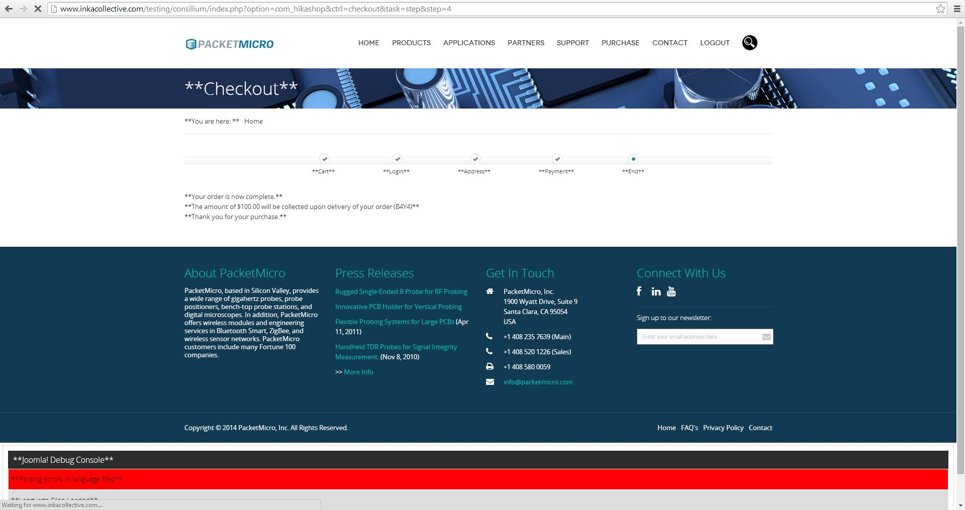

  • Posts: 75
11 years 11 months ago #161028
I cannot copy and paste it, the redirection happens too fast but I have included a screenshot of the page before the redirection. Also, the problem may be the after_end view however the back-end does not show any changes have been made to it.
