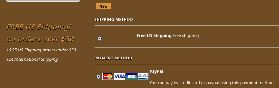

-- url of the page with the problem -- : www.buffalobuckscoffee.com/component/hikashop/checkout
-- HikaShop version -- : 2.3.1
-- Joomla version -- : 3.3
-- PHP version -- : 5.4
-- Browser(s) name and version -- : all browsers
We are using Paypal to calculate shipping so we would like the "Shipping Method" option turned off. (Or we would like to edit the text if this first option is not possible or advisable.)
Thank you
Last edit: 11 years 11 months ago by sedonasky.
  • Posts: 85725
  • Thank you received: 14054
11 years 11 months ago #160868
Remove the "shipping" view from the "Checkout workflow" option of the HikaShop configuration and you won't see that on your checkout anymore.

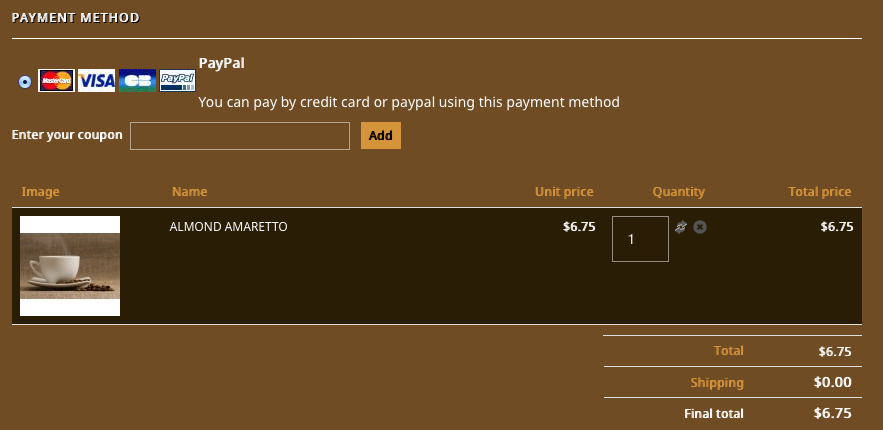

  • Posts: 63
11 years 11 months ago #161066
Thanks that worked. However, the cart still shows "$0 Shipping" but we plan to set Paypal to calculate shipping which will of course confuse shoppers. How do we remove the "Shipping" option at the bottom of checkout. Or, better yet, how do we set up these shipping variables in Hikashop so we do not need to use Paypal?

11 years 11 months ago #161071
So you should not have it displayed.
You can configure any shipping methods in HikaShop, you can use manual shipping, and set 3 shipping methods with the desired restrictions.
When setting up a shipping method, you can find a "restriction" part, just check the checkbox and then fill the minimum price value field, etc depending on your needs, and restrict the shipping method to a desired zone.
