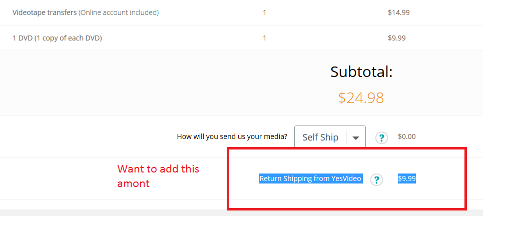

Hi nicolas,
Can i add fix amount in order total at the end of check out page if yes please guide me how i can do this.
I attached a screen sho0t to show you what i want.
Mujahid

11 years 11 months ago #162792
A solution could be to use the coupon, set a negative amount in the coupon, and in the options in Configuration > Checkout make the coupon as auto loaded in checkout.
Or you can potentially make a little plugin which will add this fixed amount to the order.
And editing the view "checkout / cart" will allow to display this amount directly in the checkout.
Here is some documentation for the plugin:
hikashop.com/support/support/documentati...r-documentation.html
And here for the view edition:
hikashop.com/support/support/documentati...ize-the-display.html
