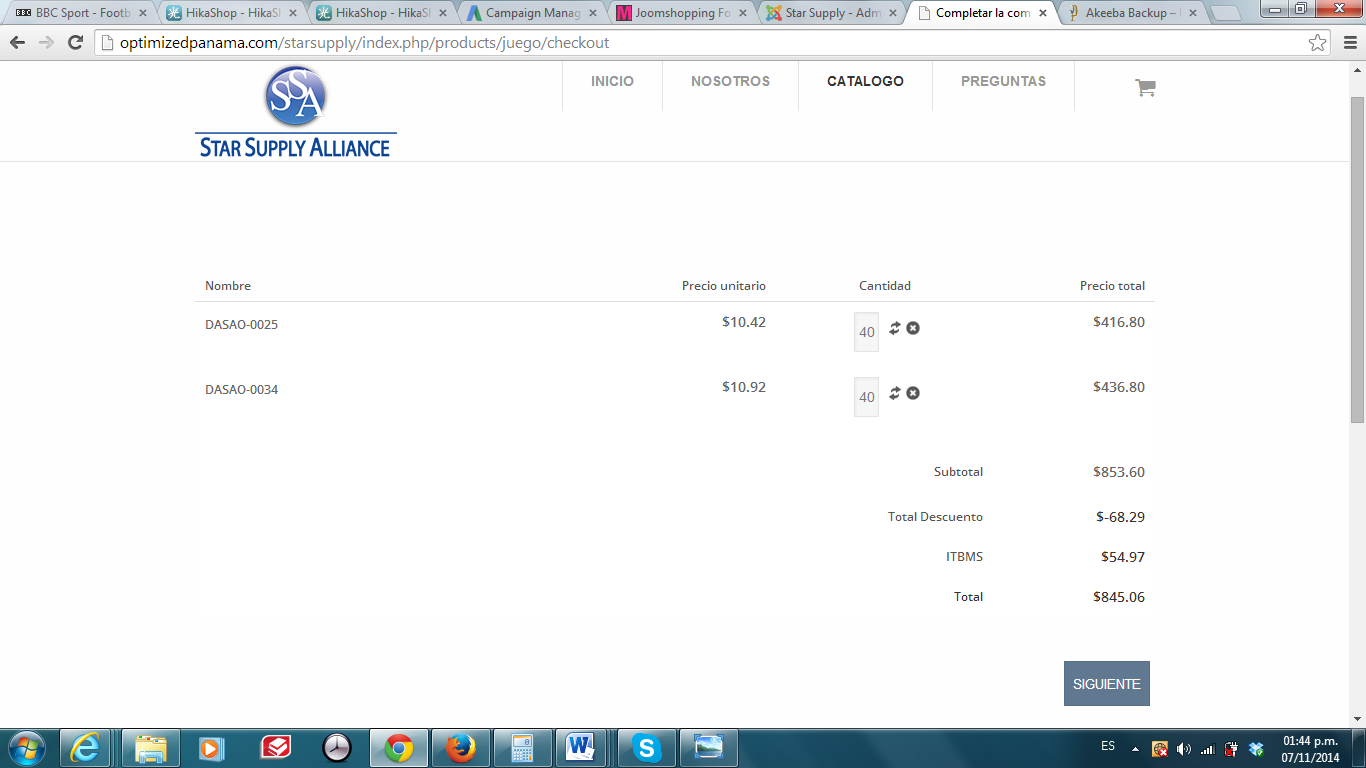

As you can see from the attached screenshot the calcualtion is incorrect. The total should be 1305.27
The individual line items are correct but the component is calculating the total based on the non discounted value.
Mike

  • Posts: 122
11 years 11 months ago #163867
Hi Jerome,
I have installed the new version but the problem persists as seen on the attached screenshot
The new version was installed at optimizedpanama.com/starrsupply
Thanks,
Mike

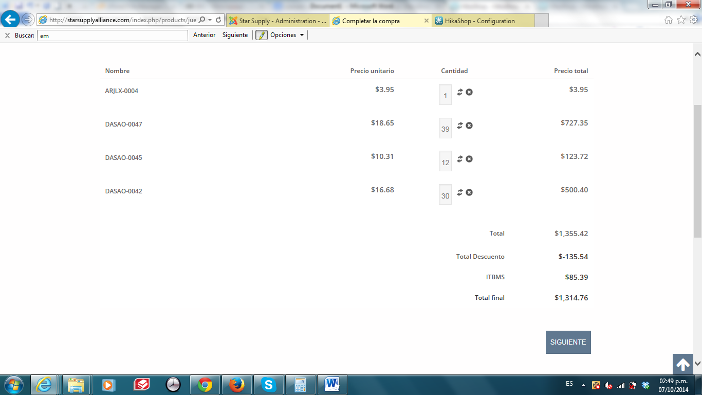

  • Posts: 122
11 years 11 months ago #163949
After further investigation - this problem only exists when there is a discount applied.
Without a discount the total is correct.
Please see attatched screenshot.
Obviously we cannot sell on line with this issue
Thanks,
Mike

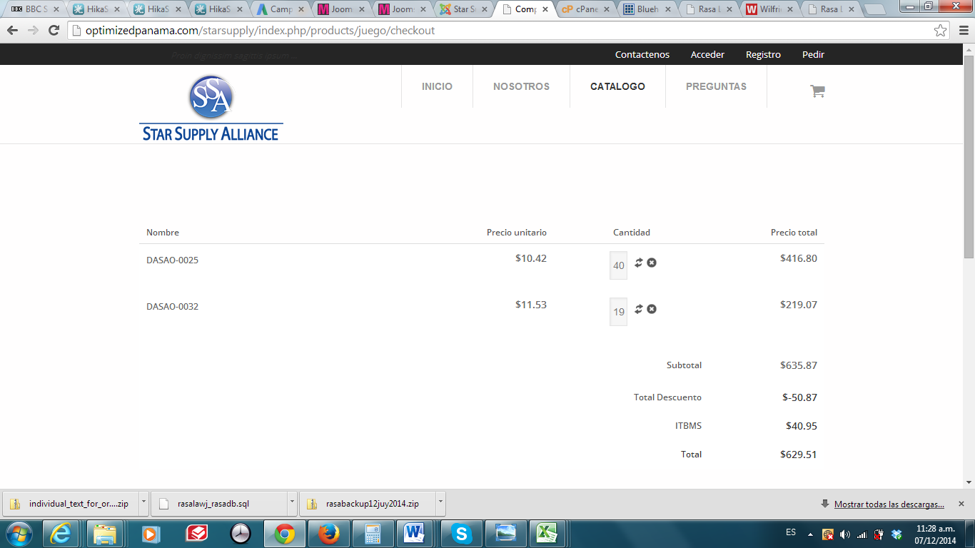

  • Posts: 26355
  • Thank you received: 4068
11 years 11 months ago #163981
First, I wanted to ask you more details about your configuration : products, general configuration, discount configuration.
Because like that, except telling you that, "yes the price calculation is not correct". I don't have any tool to work and help you to fix it.
But I check other thread you wrote in order to get other details and I found this thread :
www.hikashop.com/forum/checkout/868264-d...vidual-products.html
And some other thread about some tax problems.
Regarding these threads, I thing your discount configuration is wrong.
In the discount configuration screenshot you posted, we can see that the coupon have a tax applied.
But you want that the discount be applied before the taxes.. So why putting a tax on the discount ?
Nicolas told you to remove that in your coupon configuration but, I don't know if you did that. We do not have "recent" screenshot of your discount configuration (or general configuration).
So, would it be possible to have some information about your actual HikaShop configuration ?
The price calculation can be wrong if you apply a discount before the tax but that discount have a tax, because discount being applied before taxes shouldn't have taxes. I guess you "gap" is there.
