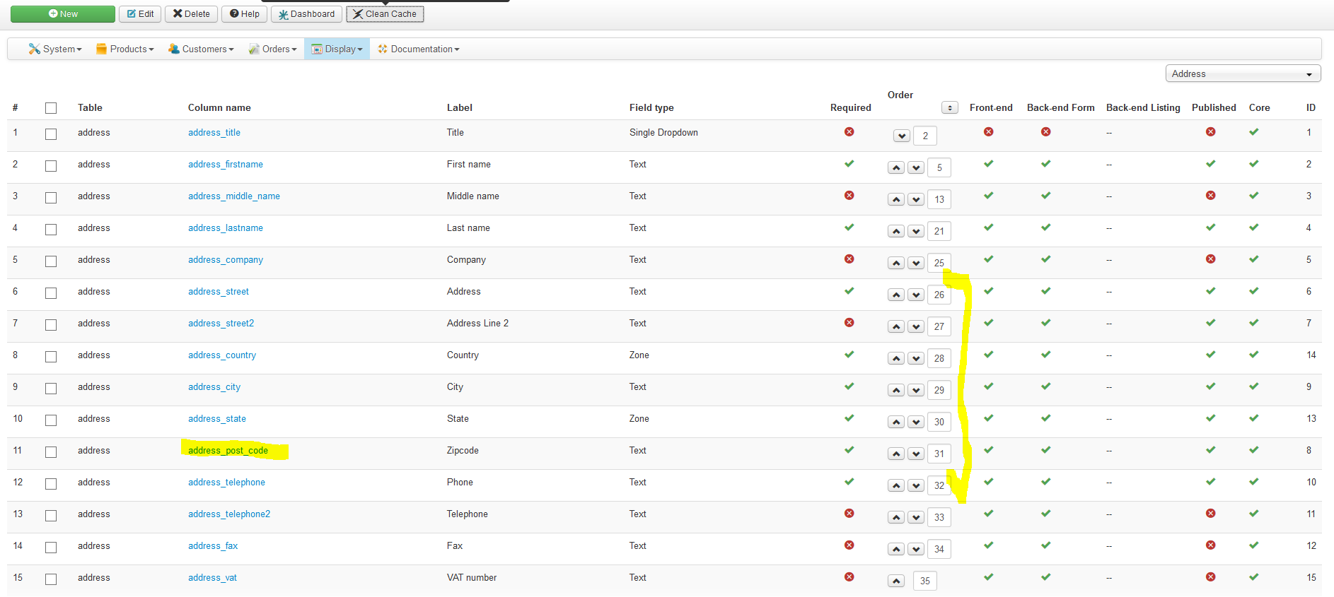

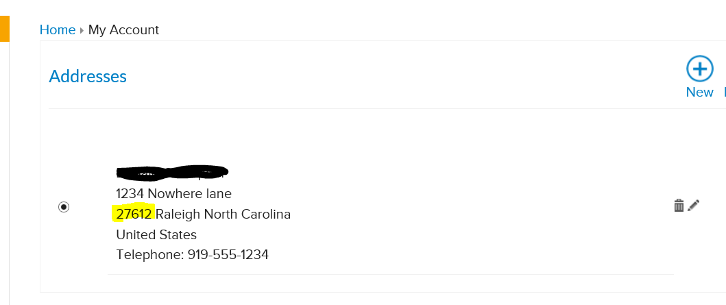

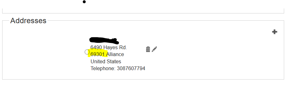

So supposedly the ordering should automatically address this issue, but it's not. We'll go look at the template, but attached are screenshots from our custom fields ordering, and both backend and frontend address views.
Everywhere the zips are showing in front of the city names, across the whole site. Seems like this should be corrected with a configuration fix, rather than have to go into several templates and modify them all.
