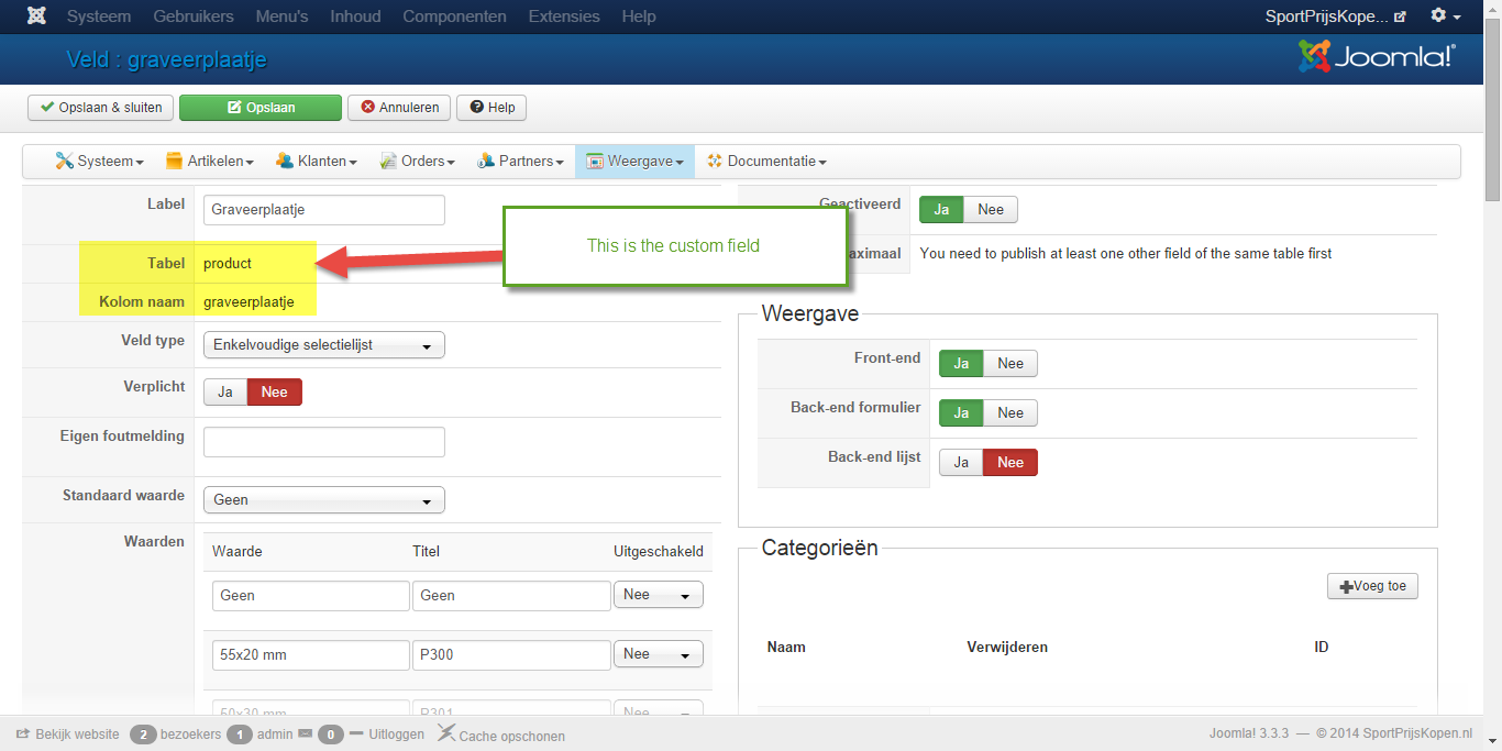

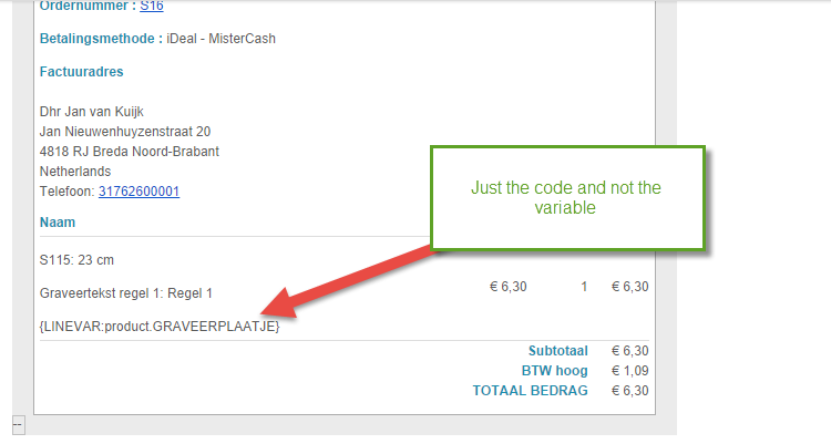

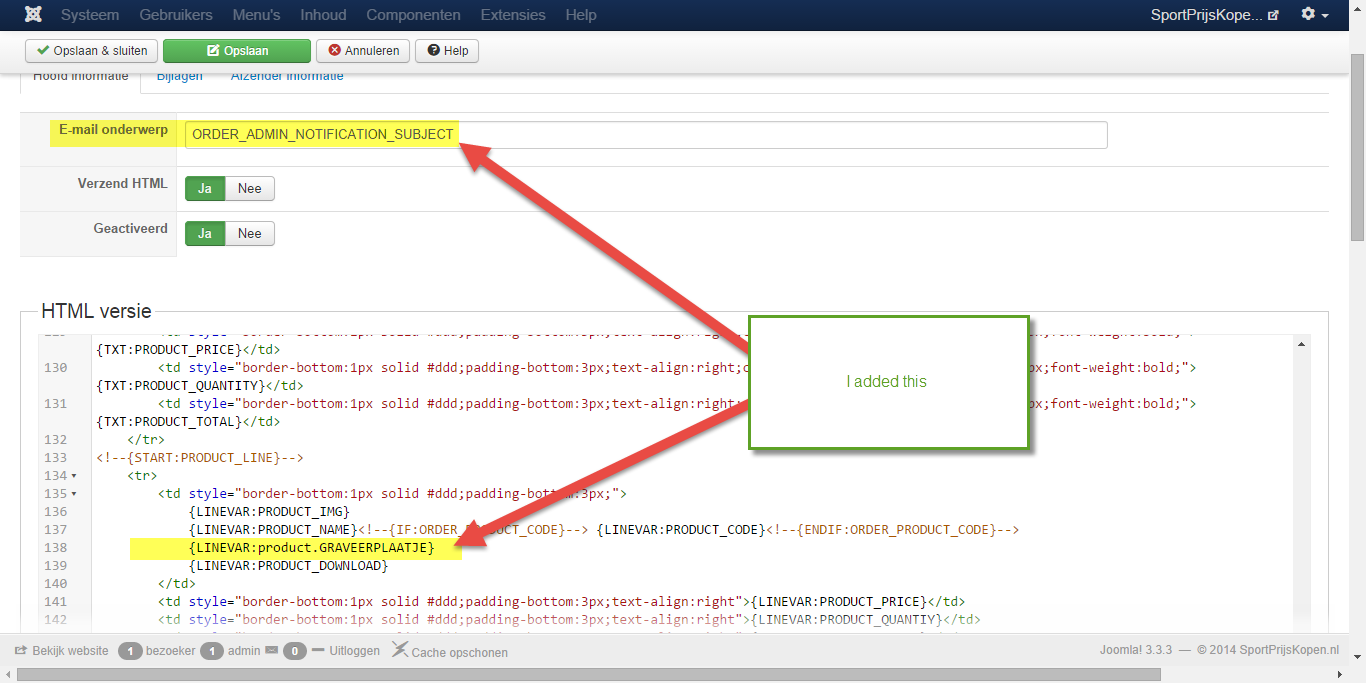

I added this line: {LINEVAR:product.GRAVEERPLAATJE}
But without any result. Only the code is on the order e-mail and not the variable. See attached images.

The custom field column name needs to be like you have it in your custom field so the tag should be:
{LINEVAR:product.graveerplaatje}

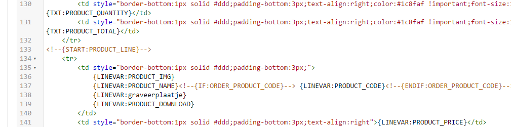

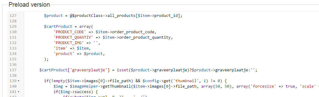

11 years 11 months ago #170610
Thanks to replace the currently added code by:
{LINEVAR:graveerplaatje}
And in the preload part, add:
$cartProduct['graveerplaatje'] = isset($product->graveerplaatje)?$product->graveerplaatje:'';
After:
		$cartProduct = array(
			'PRODUCT_CODE' => $item->order_product_code,
			'PRODUCT_QUANTIY' => $item->order_product_quantity,
			'PRODUCT_IMG' => '',
			'item' => $item,
			'product' => $product,

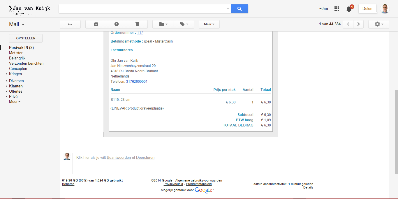

11 years 11 months ago #170732
Xavier no :-(
See attached files, but there isn't an text on the e-mail.

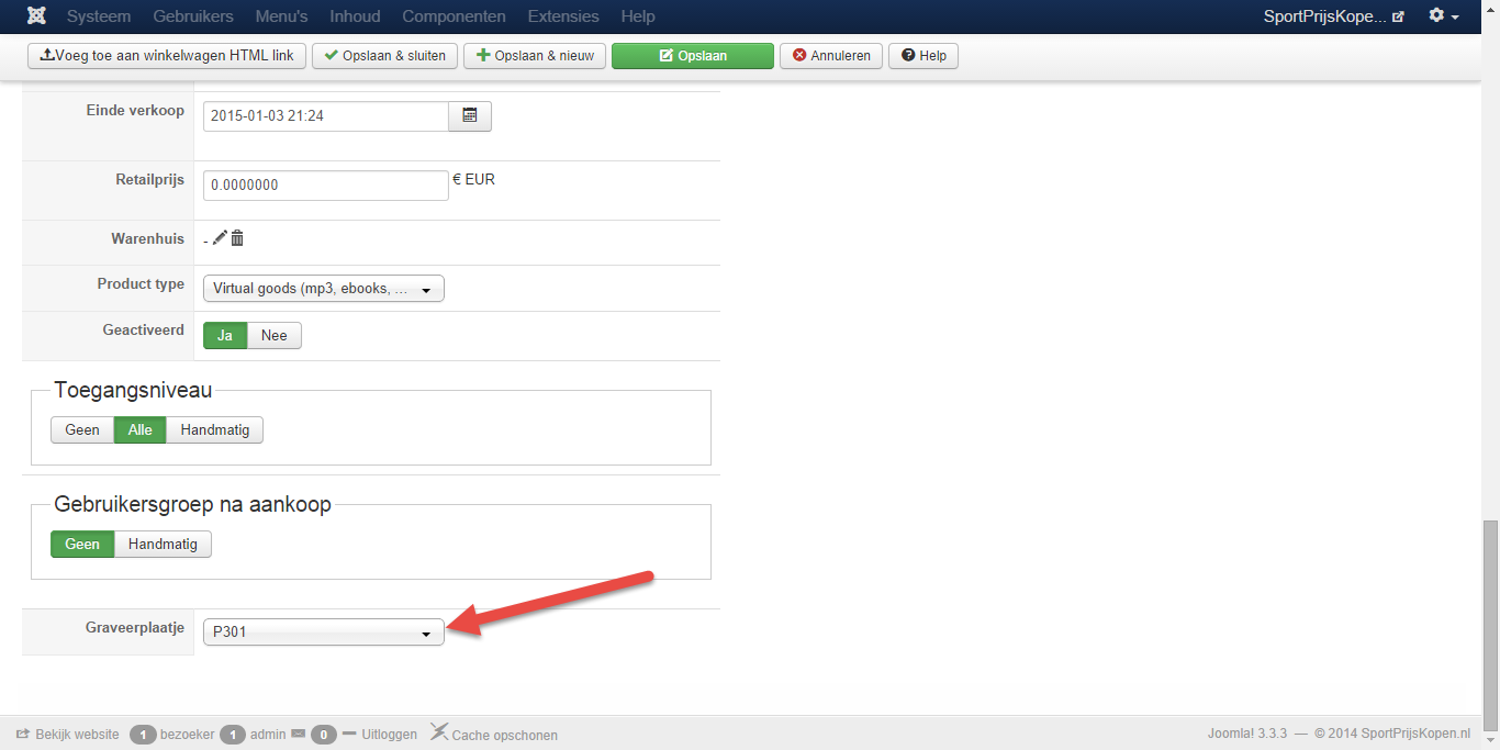

  • Posts: 235
  • Thank you received: 4
11 years 11 months ago #170840
There is a custom. See attached print screen.
Maybe I will sent you login details?
Jan
11 years 11 months ago #170917
Could you try to set the custom field type to text instead of dropdown in order to see if it's working ?
If it still doesn't work, yes thanks to provide access to backend via private message, don't forget to give us the url of that topic.
