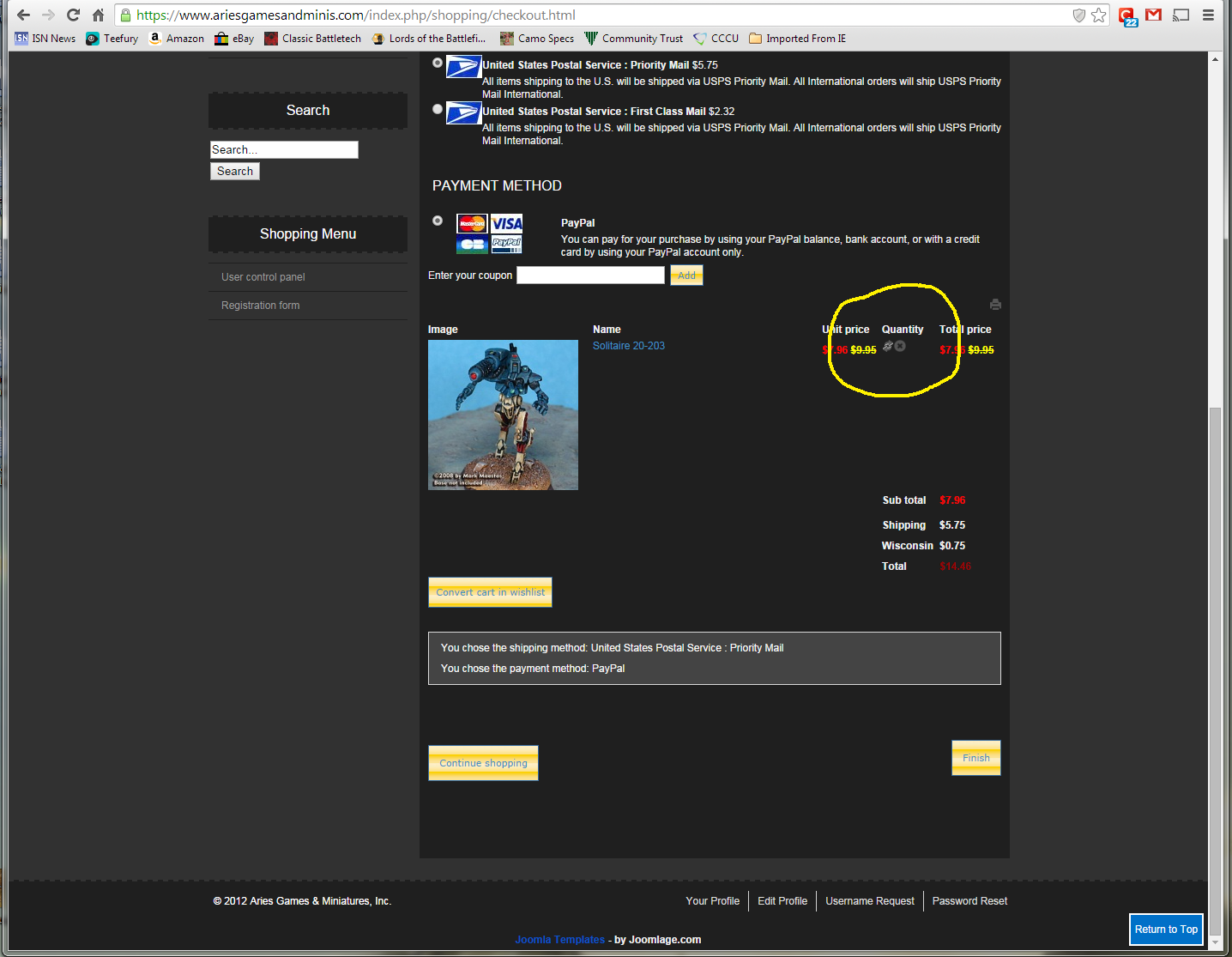

I don't know if this is a feature of the cart, or not, but I'd like it if the quantity of the item purchased shows up in the cart with the ability to increase or decrease the quantity. Is there a way to do this?
Currently all that is shown is an X circle button, and another button I can only describe as two arrows in a circular pattern with one going to the right and the other going to the left. Please see the "Quantity" image attached, these buttons are shown in the yellow circled area. I purposely selected an item that I had 2 in stock of so I could try adjusting the quantity.
11 years 10 months ago #172839
The field should be displayed by default, it's a basic input field with the current quantity, so to change the quantity the customer just have to change the value in the field and click on the "two arrows" which in fact are a refresh button.
You have to check via your browser console if the template is not hiding this field.
Or check if the view "checkout / cart" has not been edited.
hikashop.com/support/support/documentati...ize-the-display.html

Xavier, it is not being displayed, that's why I'm asking for help.
How do I check via my browser that it's not being hidden...and if it is, how do I un-hide it?
11 years 10 months ago #173008
Thanks to the given link you should be able to find it by yourself.
Everything is explained ;)
I just checked on your website, and indeed the field is just hidden by some CSS.
Thanks to add the following code at the end of the frontend_custom css file via Configuration > Display > CSS:
.hikashop_product_quantity_field, .hikashop_product_quantity_field_change {
    display: block !important;

Xavier,
#1 - I apologize, I should have looked closer at the link you provided.
#2 - Thank you, I've added that string to the end of the CSS and it's now working!
I sincerely appreciate your help!
