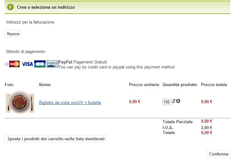

I have some problems with VAT and checkout.
For example:
Italy VAT = 22%
if the price of product is 0,09 cents and I buy 100 pieces...
the final price is € 9 and the VAT is € 1,62...
but...
in the checkout the VAT results € 2.
How do I do?
Can someone help me?
Mimmo

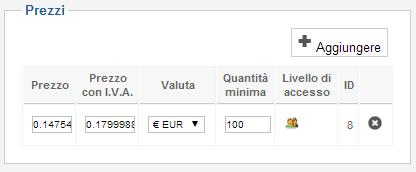

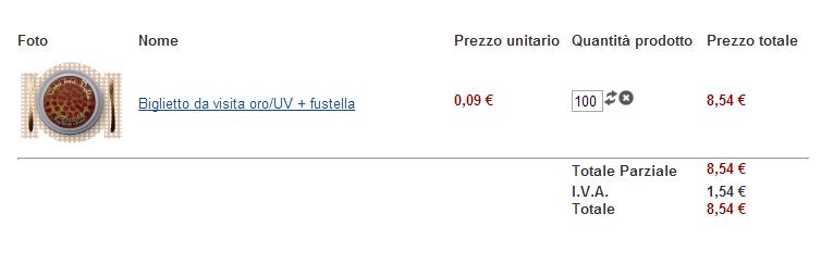

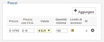

I did how you said but now there is another problem...
The total price is wrong:
I think because when I decide the prices in the administration
after saved hikashop change the prices
It's possible the calculation of taxes on the total of prices?

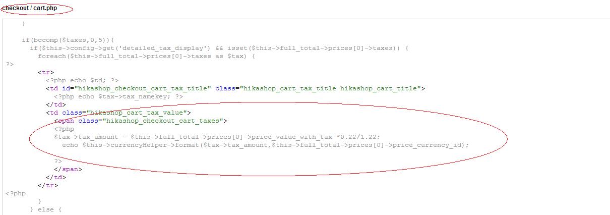

What you can do is to turn on the rounding in order to get the correct total, and then override the different views via the menu Display>Views in order to change the display of the taxes and recalculate it yourself the way you want.
For example, for the checkout, it's the file "cart" of the view "checkout" that you want to edit and add the line:
$tax->tax_amount = $this->full_total->prices[0]->price_value_with_tax *0.22/1.22;
before the ilne:
echo $this->currencyHelper->format($tax->tax_amount,$this->full_total->prices[0]->price_currency_id);
And it will display the amount you want.

11 years 9 months ago #175621
I turned on the rounding taxes and edit the file "cart".
But nothing is changed.
Maybe I have to do something still?

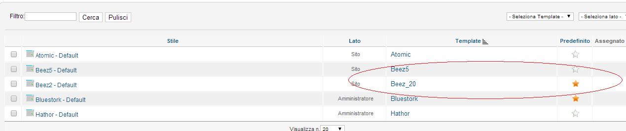

  • Posts: 26381
11 years 9 months ago #175743
You're editing the right view but, are you editing the right view for the right front-end template like Nicolas asked you in his last message ?
  • Posts: 8
11 years 9 months ago #175792
Hi Jerome,
yes... I did so...but...I don't understand why don't work...
this is my template:
this is the file that I edited:
maybe I have to uninstall hikashop and later I have to install the new version?

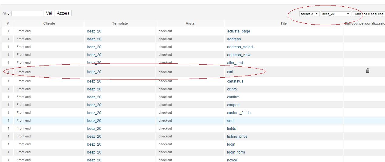

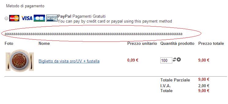

11 years 9 months ago #175994
If you're editing the good file of the good view of the good front-end template via "Hikashop->Display->Views" can you write a text at the beginning of your file and tell me if that text is displayed on the front-end ?
Thanks.
  • Posts: 8
11 years 9 months ago #176029
yes...
I did
the text is displayed on the front-end
You can see the image:
