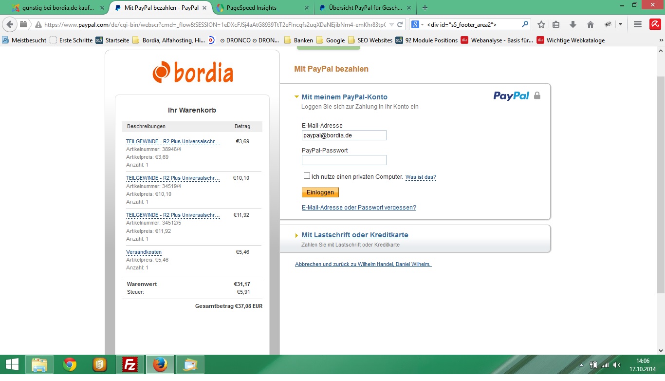

a customer has ordered today. The customer paid with the payment method Paypal. The money is of inputs and the order was switched automatically in the system to be canceled. Reason was a difference in price from the shop system and Paypal.
see photos ...

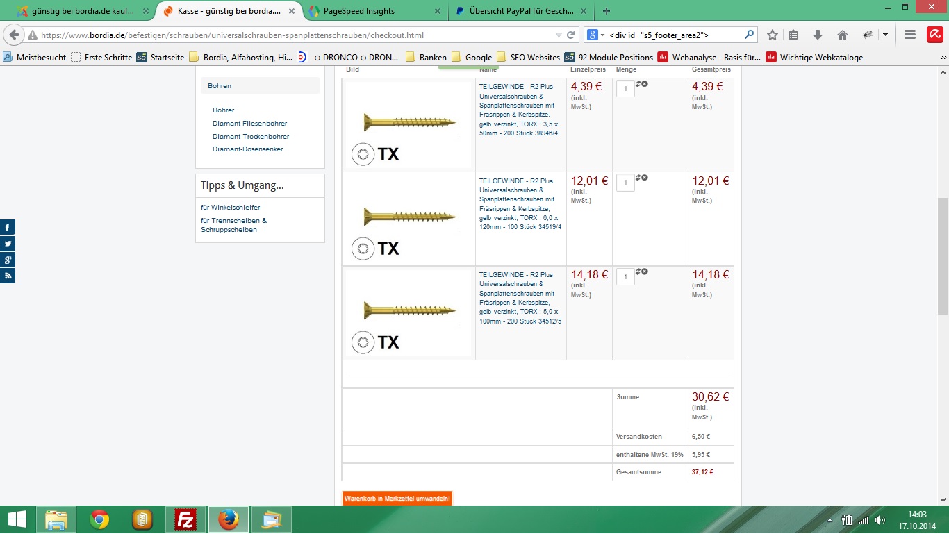

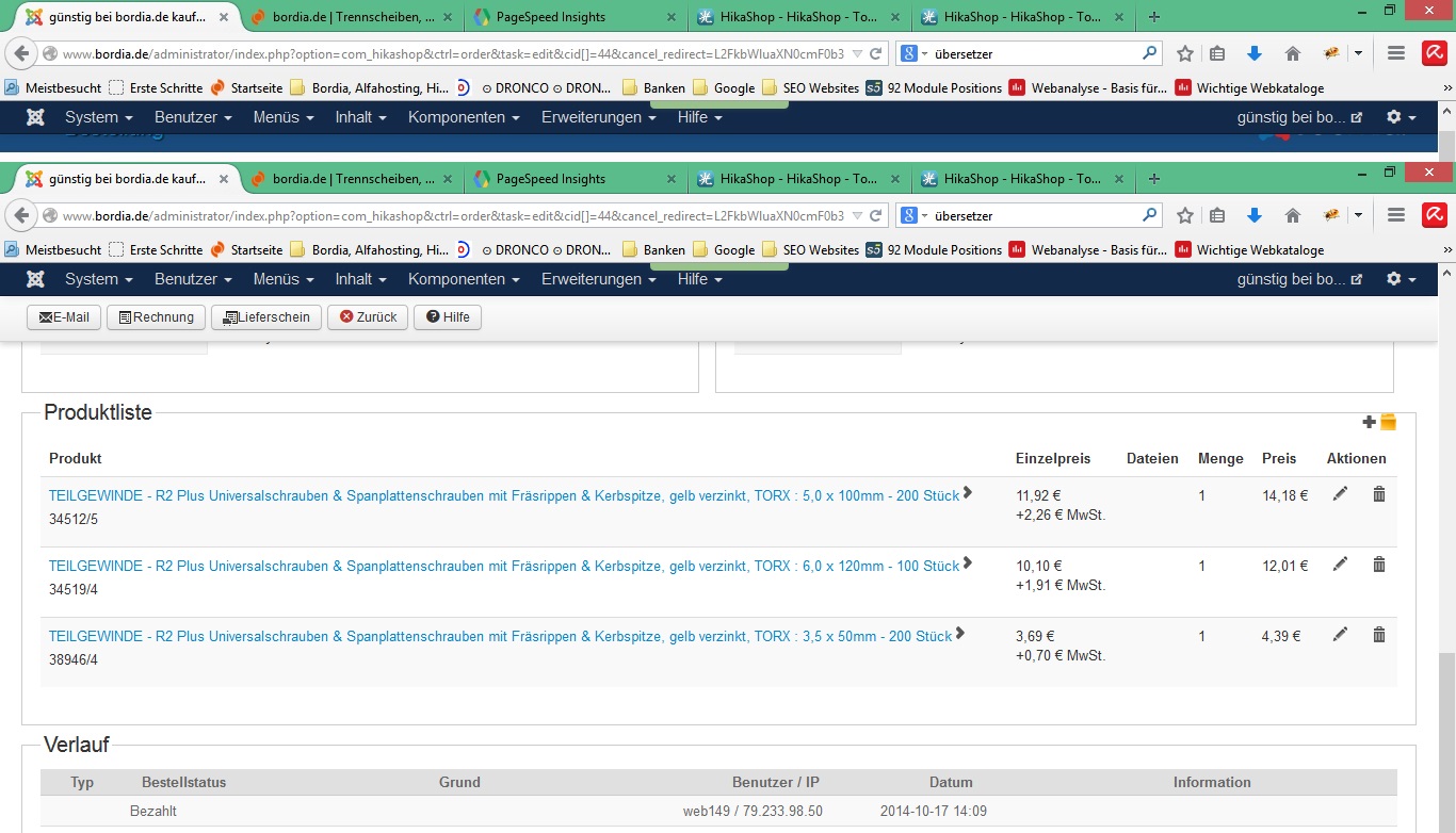

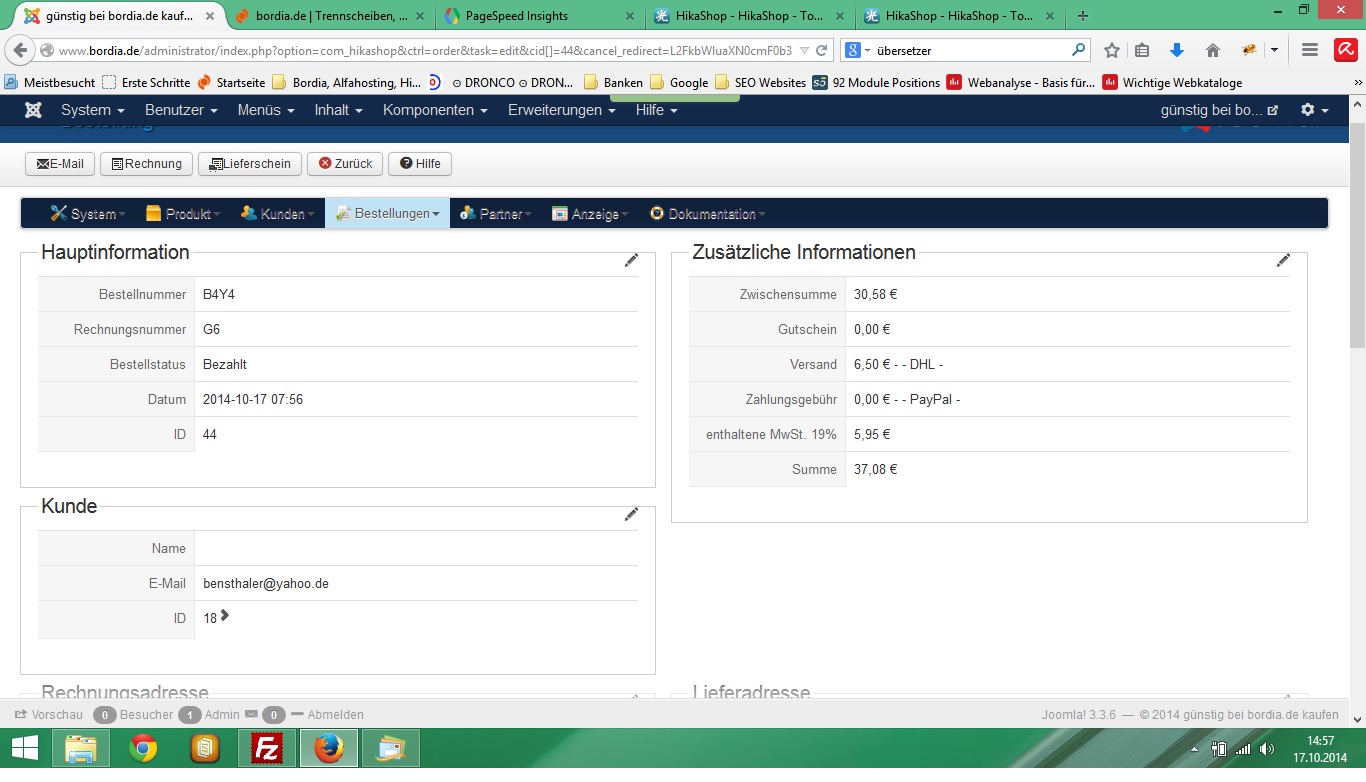

in the backend on my site under the Bstellung the price appears to Paypal is sent. Why a different price is in Fronend at checkout angeizeigt?
Frontend during checkout = € 37.12
backend order = € 37.08
11 years 9 months ago #175998
Can you set the "Send details of the order" option to NO through your PayPal configuration page and test it again ?
Thanks.
  • Posts: 81
11 years 9 months ago #176200
I've changed it like you said. The invoice in the backend now matches the checkout in the frontend. But with the payment method payment in advance is still the difference there.
