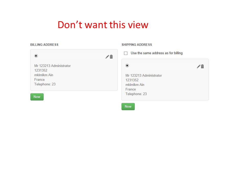

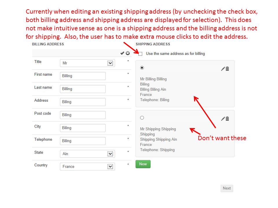

Please could you tell me how I can make the view for billing address to be in the edit mode all the time?
Also, the shipping address (when the the " Use the same address as for billing" checkbox is selected) should be in the edit mode as well.
There rule will be that a customer will only ever have maximum of 1 billing address and/or a maximum of 1 shipping address only.
Please let me know which address view file/code to change?
Thanks.

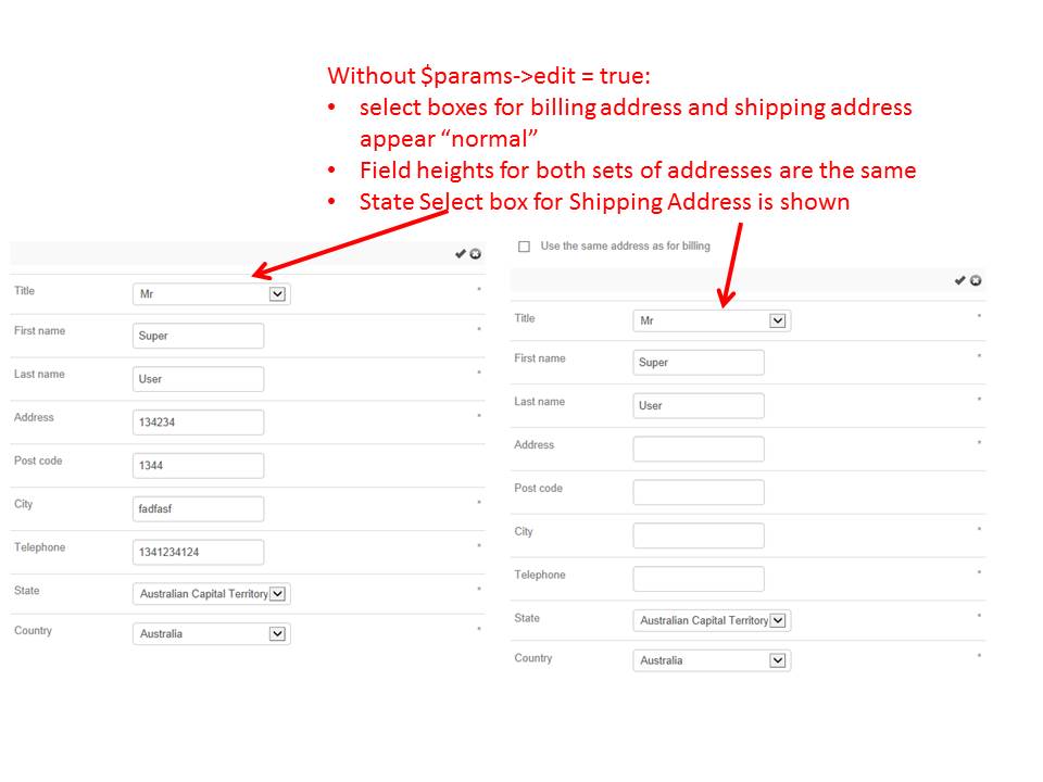

Hello, Jerome.
Good evening!

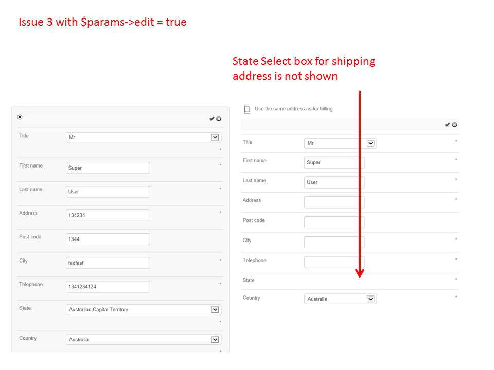

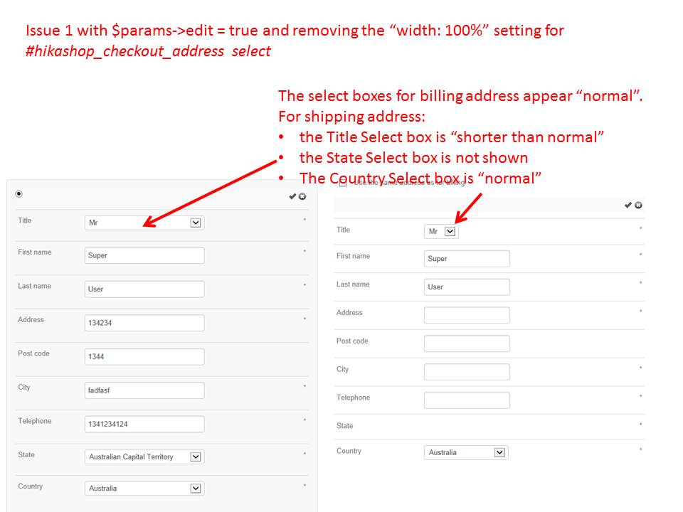

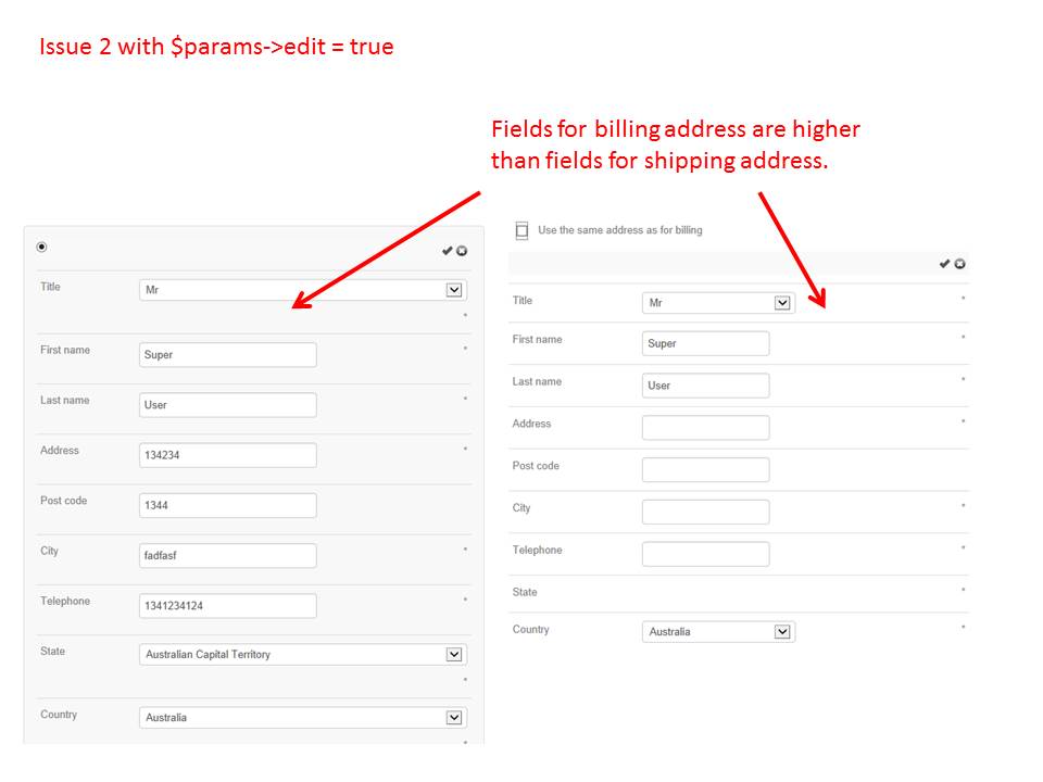

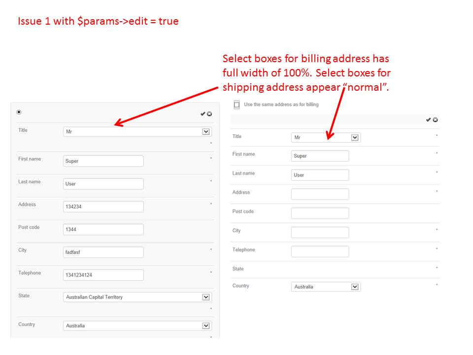

The proposed solution works but I have spotted the following issues, which I can't seem to explain nor find a fix. Please could you could provide a suggestion on how I can solve them?
The issues are:
1) the Select boxes have different width
2) the fields have different heights
3) the State select box for Shipping Address doesn't appear
Please refer to the attached images.
Thanks.
Take care!

11 years 10 months ago #179033
The display issue for the size of the inputs (or dropdown) is linked to the CSS.
In the checkout, when you edit an address the edition part is displayed in a different section than the section which display the addresses ; that's why you might have some differences for the CSS.
The line which is higher it just that the dropdown is taking all the width so the asterisk which should be display on the right is display below.
If you want to hide the asterisks, you have to set the field as not required during the call of the display function.
	echo $this->fieldsClass->display(
		$field,
		@$this->address->$fieldname,
		'data['.$name.']['.$fieldname.']',
		false,
		' ' . $onWhat . '="hikashopToggleFields(this.value,\''.$fieldname.'\',\''.$name.'\',0);"',
		false,
		$this->fields,
		$this->address,
		false // this parameter is added
The other solution is to use a CSS in order to hide the span with the classname "hikashop_field_required" in the specific container.
And for the design, the best will be to change a little more the view in order to have the same classes for the container elements.

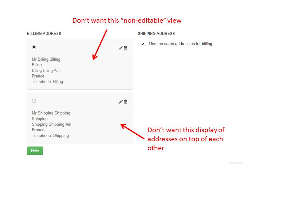

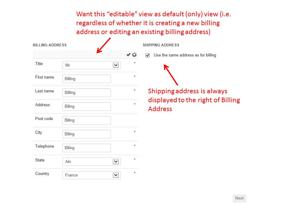

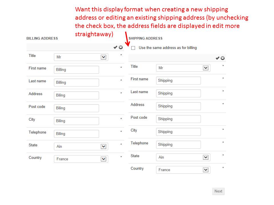

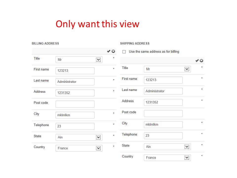

This issue is driving me crazy! Apologies for not explaining the situation clearly before but when the line of code ($params->edit = true;)
is used, the display is different from when the code is not used and subsequently the pencil/edit button is clicked. In my simple mind, these two display modes of editing the same address should be the same.
I have since tracked down to the difference.
a) when the ($params->edit = true;) is not used, the address block falls under the "hikashop_checkout_billing_address_zone" div tag
b) when the ($params->edit = true;) is used, the address block falls under the "hikashop_checkout_billing_address_selection" div tag
Not sure why Hikashop was designed this way; I am sure that there must be a good reason. In any case, this solution is not ideal because once the shipping address is filled in, there will be 2 address blocks displayed one on top of the other and the address management doesn't appear intuitive.
So, I thought it would be prudent to return to the actual requirements that I have. It's to make the address management intuitive and easily navigable by the following requirements:
a) do not display the "non-editable" views for billing address (and also for shipping address - see d) below)
b) always display the billing address and shipping address side-by-side (i.e. never one on top of the other)
c) always display the billing address and shipping address in "editable" views
d) the shipping address block is toggled by the "same as billing address" checkbox.
When the checkbox is unchecked, the shipping address block is displayed to the right of the billing address block.
When the checkbox is checked, the shipping address block is hidden.
There is no need to display a set of addresses for selection when the "same as billing address" checkbox is checked (similar to see a) above)
e) there is only ever a maximum of 1 billing address and/or 1 shipping address per user
Please see attached for an illustration of these requirements.
Hope I have explained the requirements clearly; apologies if it's too muddled.
Thank you very much for your attention and for your help.
Take care!

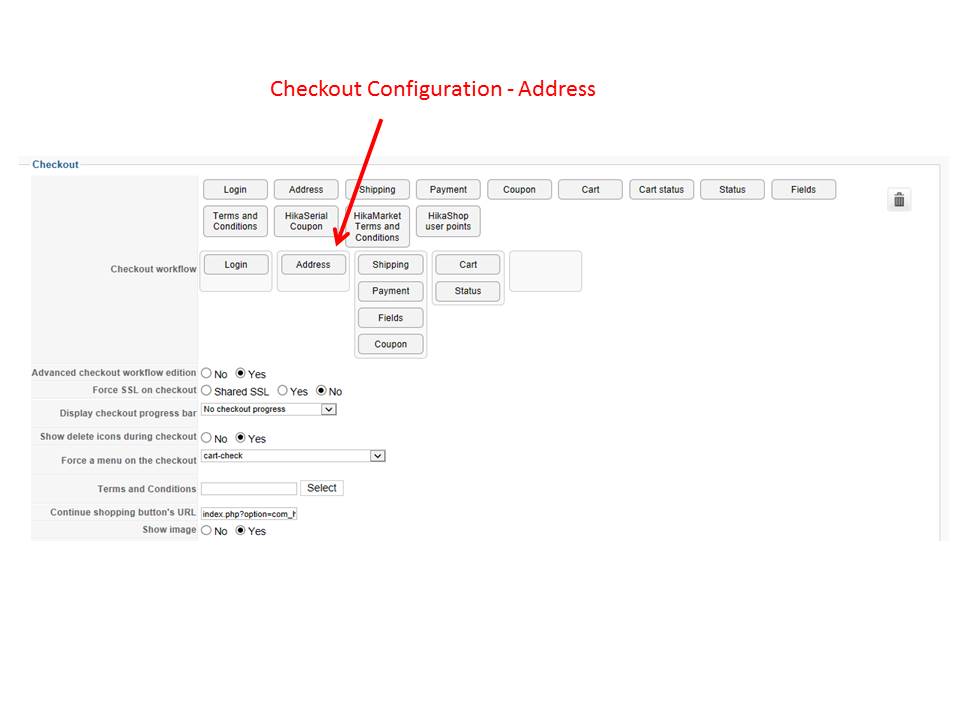

The following discussion assumes that the Address task is the only task in its step (see attached).
Setting "$params->edit = true" (to always display the addresses in edit mode), the user always have to click the "Next" button twice to move to the next step. The first click on the "Next" button brings the user to the address selection mode and the next click brings the user to the next step. As I prefer the user to always be in the edit mode (by setting "$params->edit = true"), the first click is redundant (and confusing to the user).
How can the user be progressed to the next step in the checkout process with only a single click on the "Next" button?
Thanks for your help.
Take care!
  • Posts: 86179
  • Thank you received: 14217
11 years 9 months ago #181995
1. In that case, what I guess you could do is add some code in the after_address function of the file components/com_hikashop/controllers/checkout.php in order to check whether the data received in the POST is different than the data in the database and if they are identical, don't save.
2. In the same function of the checkout controller, the system will stay on the current step or go on the next step based on whether you return true or false. So you can change that behavior like that.

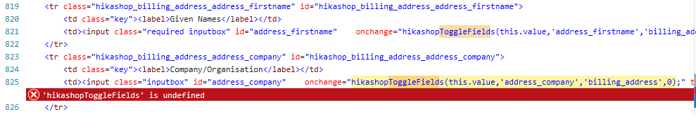

I have one last hurdle (hopefully) regarding displaying the address in edit mode. I am going back to Jerome's recommendation of using
When a field is changed, the function hikashoptoggleFields is not found.
Please could you let me know what function to call so that the hikashopToggleFields function can be found (i.e. I do not want to remove the call to the hikashopToggleFields function (in address/show.php)? Just want to know why Hikashop cannot find this when $params->edit is set to true and how to fix it.
Thanks.
Take care!
  • Posts: 26386
  • Thank you received: 4078
11 years 7 months ago #190197
Regarding the "views/address/view.html.php" ; if you are in edit mode or not, the javascript should be added in the page header.
But the easier solution will be to call the getLayout function without displaying his return and with the "edit=false" ; so you will sure that you will have the required JavaScript.
I will continue to perform some tests in order to be sure that the problem will be correctly solved in the next HikaShop release.
