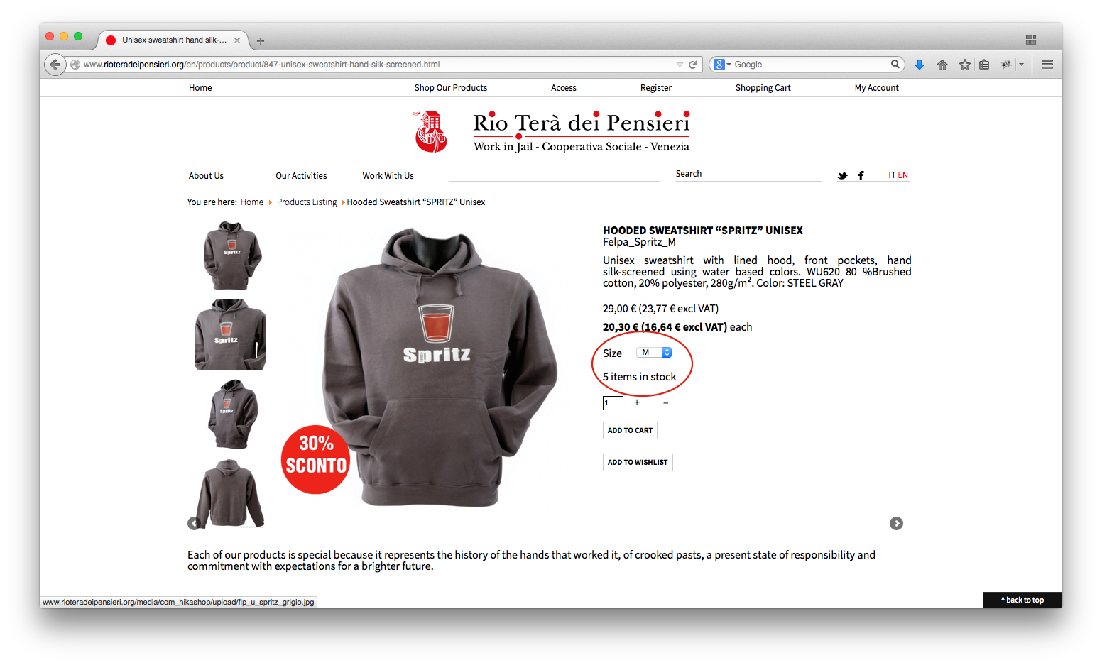

I've this issue.

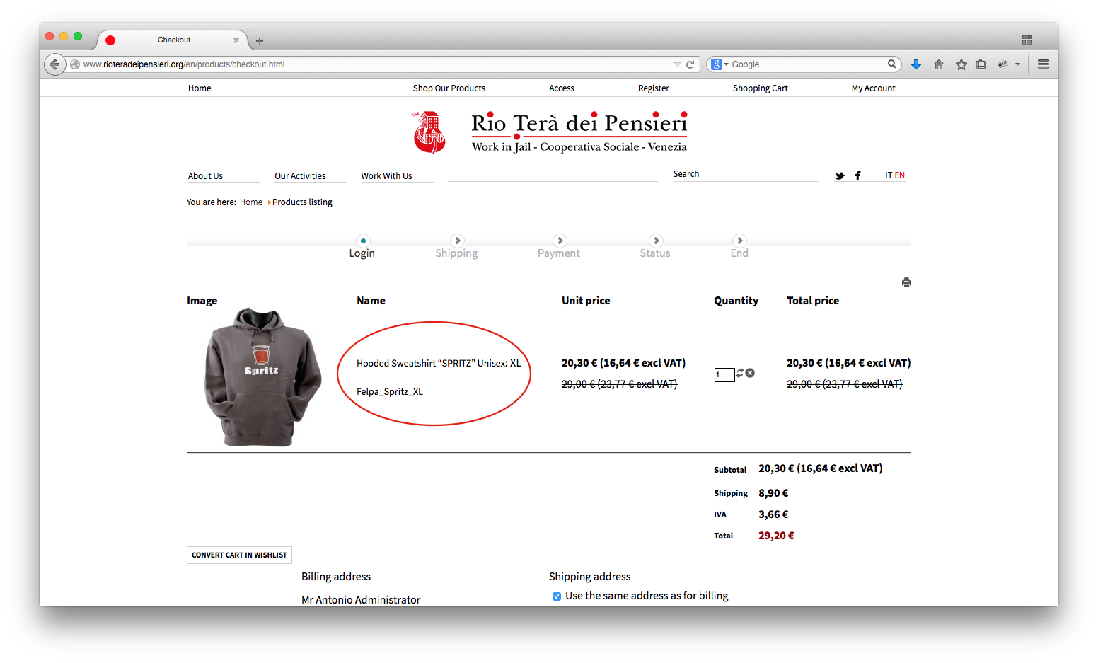

If I selected a size M in product page, and them I click on "ADD TO CARD", the system writes a wrong size in checkout page (XXL), as you can see in the screenshot that I've attached.
Can you help me.
Thank you
Antonio

Hello Antonio,
Your issue is probably coming from some file customization of the "product" view via "Hikashop->Display->Views", Can you check it and test it without your customization ?

11 years 8 months ago #182084
HI I've tried to use the original "product" view, I have a backup file, but problem is still there.
How can I do?
Antonio
11 years 8 months ago #182143
Can you directly go the the "Hikashop->Display->Views" page and directly check that you don't have any modification through the files of the "product" view of your front-end template and then remove it to test it without any customization ?
Thanks.

11 years 8 months ago #182192
It's right!
I've deleted all custom display views in staging site and now it works well.
Thank you
