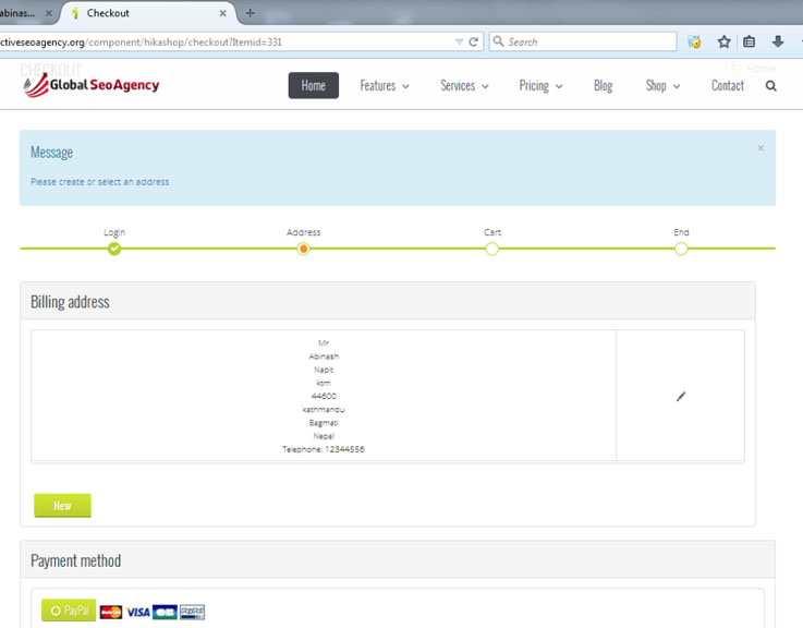

OK look at this image , I have set checkout in default setting that you have it.
1. Account Detail
2.Cart and Selection Payment option
3. Final Check out.
Now look at the picture when i finally check out then a message appears
"Message Login or create an account" But i have already filled the detail in Guest Checkout but also it come same message and checkout cannot be success.

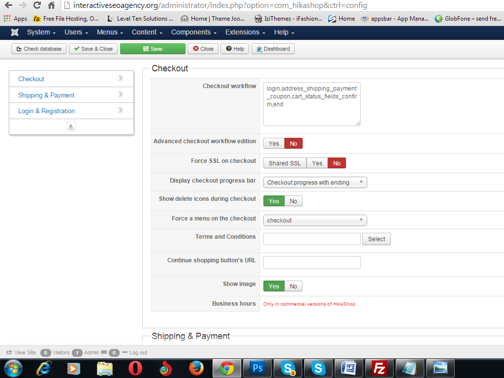

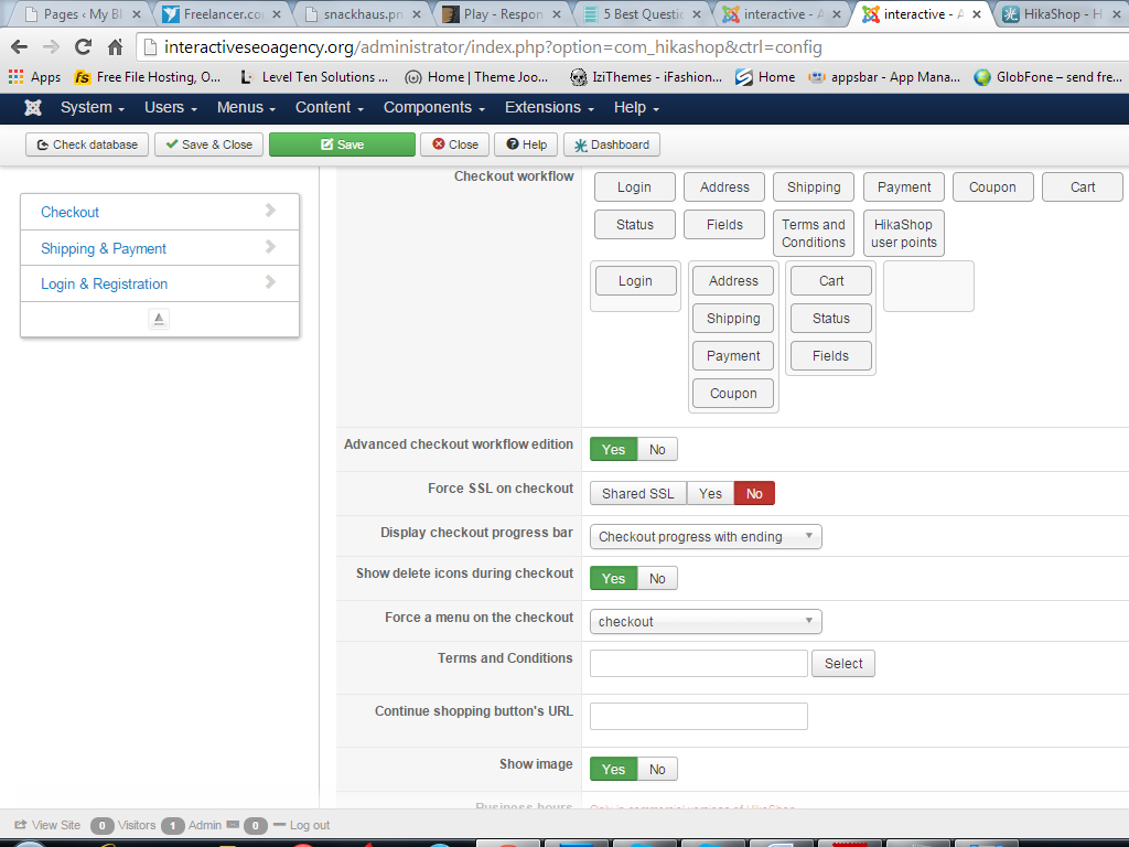

Can you set the "Advanced checkout workflow edition" option to "No" and then show me what do you have through the "Checkout workflow" option via "Hikashop->System->Configuration->Checkout" ?
I just wanted you to show me some screenshots of your "checkout workflow" via "Hikashop->System->Configuration->Checkout" when the "Advanced checkout workflow edition" option was turned off :).

Sorry for late problem i am send you the picture of check out option please check

It's really strange. It sounds as if the user session was not working.
Try to change the "session handler" option of the Joomla configuration and see if that helps.
If not, try to remove the code:
if(empty($shipping_address)){
			JRequest::setVar( HIKASHOP_COMPONENT.'.address_error',1 );
			$app->enqueueMessage( JText::_('CREATE_OR_SELECT_ADDRESS') );
			return false;
from the file components/com_hikashop/controllers/checkout.php
