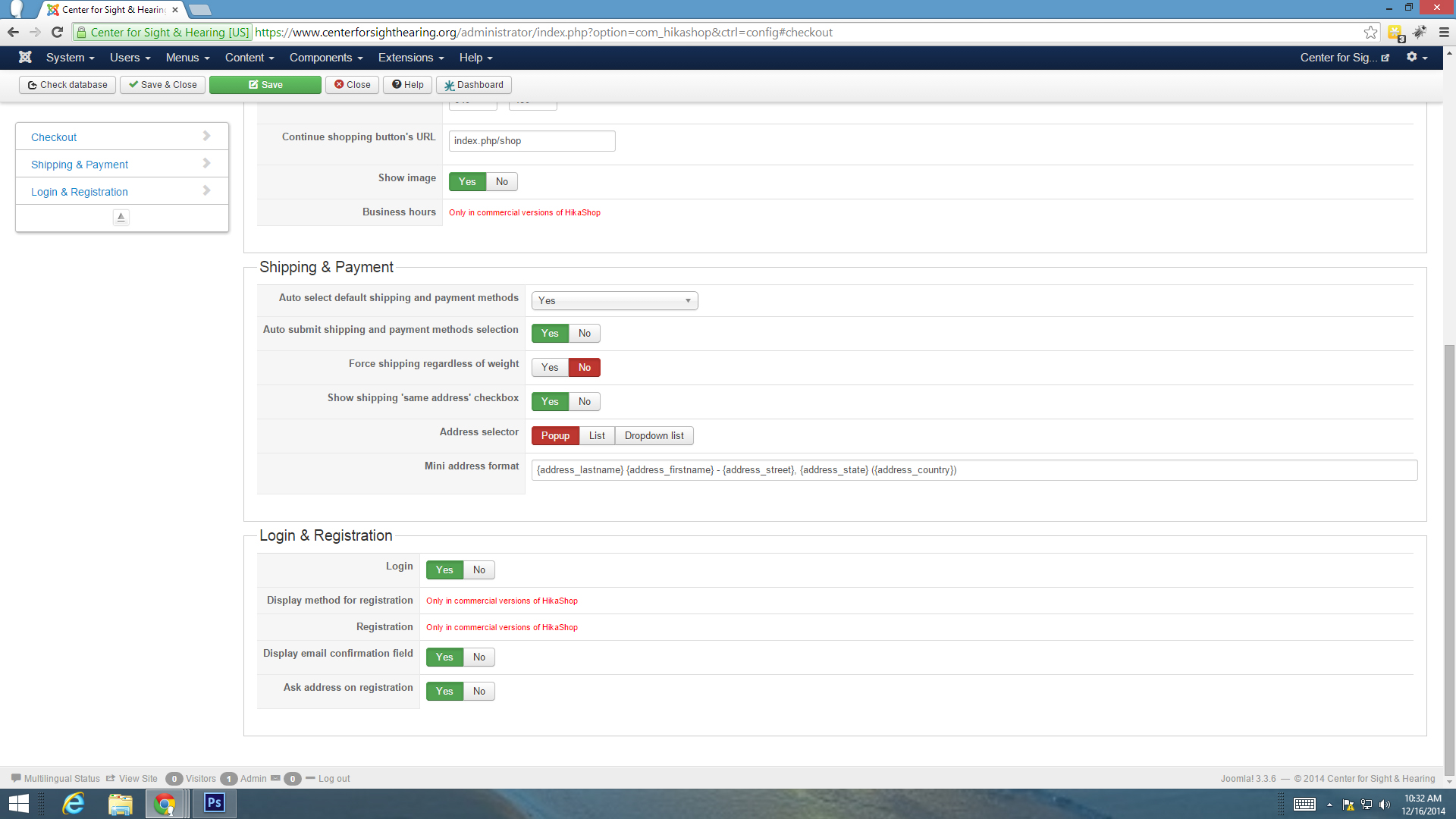

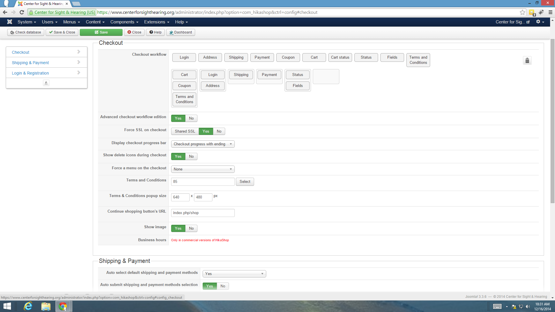

I have disabled SEF and you will notice that Hikashop is appending itemID 1029 which is the ID for the Miscellaneous menu, not sure why this is happening. anyway I am including screen shots of the Cart Configuration, it is set to Multi cart and the check out is a multi step checkout process.
Thank You for your help.
Anthony
