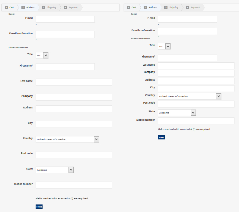

Hi - Where do i need to go to change the layout of my address fields during checkout. I've been at this for hours and hours and just can't find the right css code to do it with.
The attached file shows what it looks like on the left and I want it to look like the one on the right.
Also the asterisk. I managed to find the css for that for the contact informaiton fields and gave it a value of "hidden" but I would just rather get rid of it altogether. I could not find anything for the asterisks for the email fields above. How do I get rid of these?

Did you try inspecting the page with Firebug or a comparable browser console? It's fairly simple to find the classes and simulate changes.
To be able to help you and give you the correct CSS, it'd be good to see the site because the present CSS might well come from your template.
If you posted a link to your site in the hidden section of this post, then us regular humans can't see it and the official support team might take it from here.
Otherwise just post a link?

It can be done with some simple CSS code that you can add in your template's main CSS file:
.hikashop_field_required {
display: none;
#hikashop_checkout_login_right_part .control-group{
margin-bottom : 0 !important;

That worked perfectly well! thank you. One more thing. What about the email section? both the asterisk and the spacing.

hi, thanks for the response. I'm actually not talking about the system emails that are being sent. I'm talking about the form that the user uses to create an account as a guest. like on the top part of the previous attachment.

You can try to use such CSS:
.hikashop_registration_email_line .controls, .hikashop_registration_email_confirm_line .controls{
color: transparent !important;
height: 30px;
.hikashop_registration_email_line .controls input, .hikashop_registration_email_confirm_line .controls input{
color: black !important;
