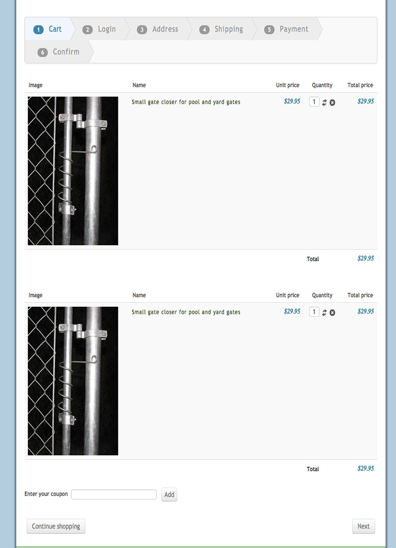

When I add 1 item to the cart it show duplicates (2 of the same items).

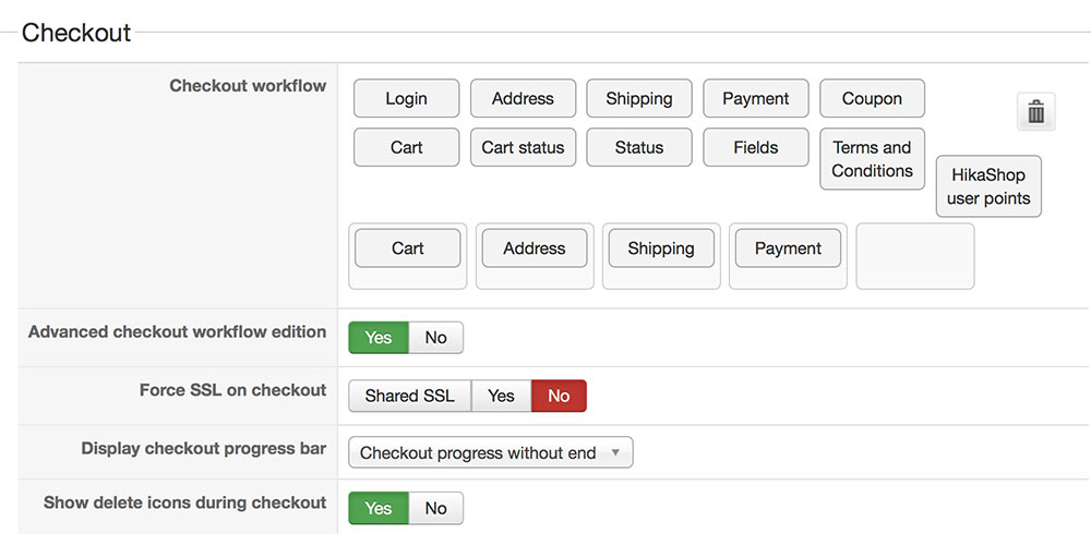

Your displaying the cart twice in your checkout workflow.
Please check your checkout workflow configuration.

11 years 6 months ago #187190
Checked that and it looks fine?
Still seeing double in cart?
See picture

Did you override the "checkout | cart" view ?
I saw that you remove the coupon step under the "cart" one ; so the coupon is no more displayed in the first page.
The most appropriate solution will be a view override.

I don't have any overrides, I disabled everything but the cart in the checkout so I could try to isolate the problem.
I also disabled all hikashop modules that might be loading on the page and I disabled all hikashop content menus except the one I am using... maybe I need to re-upload all the hikashop files?

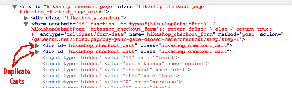

Attached is the firebug code from the page, there are 2 cart divs loading in the content area

Your checkout workflow seems to be correct.
Don't you have any cache enabled ? You can try to download again our latest package from our website and install it over the current install.
