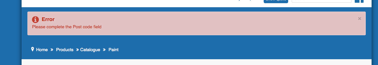

In the check out process of the site I am working on if you don't fill out all the required fields for a shipping address or a new billing address it gives you an error message but still passes you on to the next stage of the checkout and allows you to finish the order without completing the required fields.
Is there a way to turn on the same warnings you get if you miss a required field when you fill out the initial address and/or warn them they must save the address before proceeding?

The biggest problem now is that a large red error message comes up with no way for the customer to go back and fix the problem.
