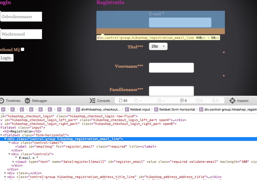

I'd like to re-arrange field-layout of address fields on checkout page. Can't find the right view.

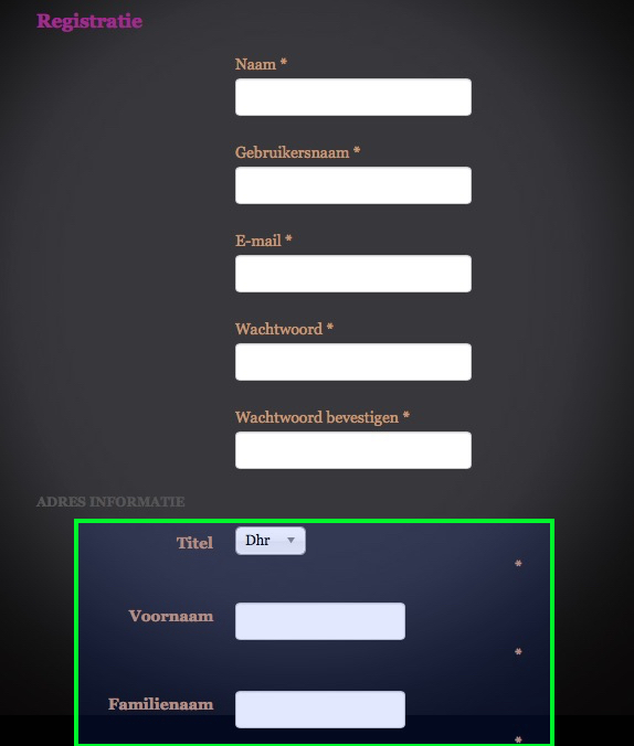

I've managed to do the same with the user-fields on the checkout-page but the address fields seem to be rendered different.
See screenshot please
thanks in advance.
Mark

The ordering is not a problem, I do want to rearrange the label / input field / asterisk (on one line) like the user-fields above the address fields. See the attachment in previous post.
Mark

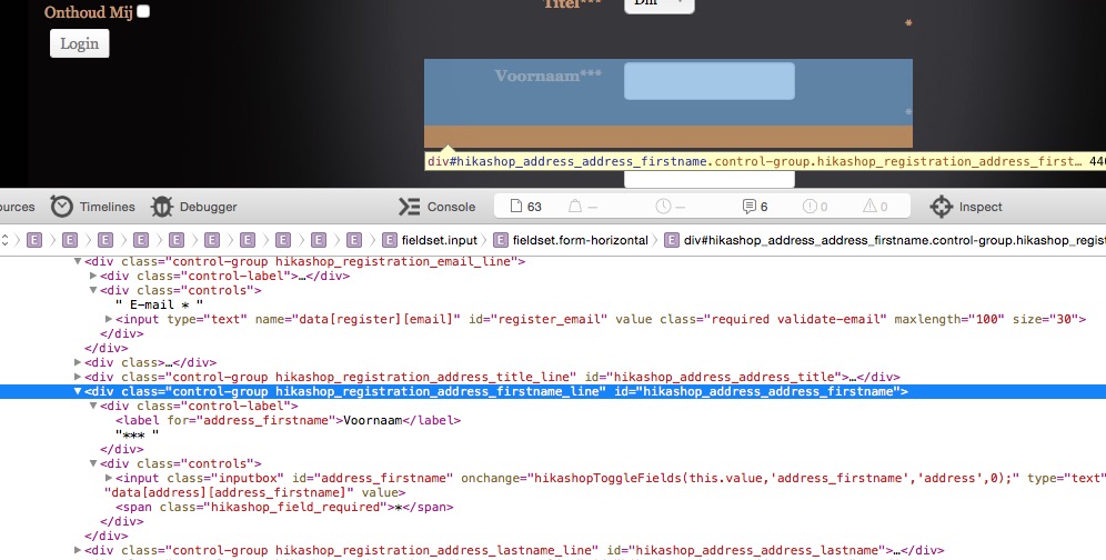

That is what i was thinking also but whatever I change in the registration-file nothing happens.
Also the way the user-fields are displayed is different then the way of displaying the address-fields.
That is why I was able to change the layout of user fields (see first attachment) but I'm tucked with the address-fields.
Seems there is another file loaded which I can't find?
Any ideas?
Thanks again.
Mark

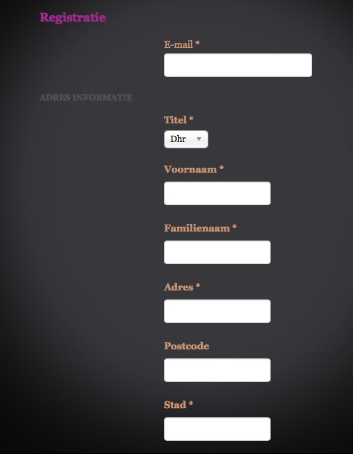

Thats fine, but I do need a div-structure which is different than the core structure.
See my screen print and watch the e-mail-field. This is what I want for the address-fields to display like.
The label and asterisks are placed just before the input-field (see the e-mail-div-structure which I altered myself in the view).
Thanks so far.
Mark

So what is the problem with that ?
Just change the div structure in the view file to have what you want.
It is not related to what I said in my previous message with the * placement.
You want to move the lines:
<?php echo $this->fieldsClass->getFieldName($oneExtraField);?>
<?php if($oneExtraField->field_required) echo '*'; ?>
after:
<div class="controls">
in the view file as far as I can see in your screenshots.
The following user(s) said Thank You: squareweb

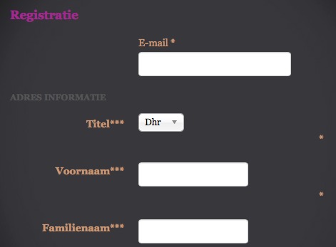

Your totally right, sometimes I'm thinking to difficult....
I've done it (see screenshot).
Thanks again.
Mark
