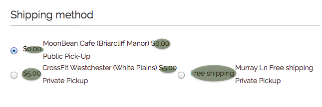

  • Posts: 12
11 years 7 months ago #189259
I highlighted the info I want removed.
I hope this helps.
Thanks you
11 years 7 months ago #189266
To remove the prices in the shipping method selection part, you will have to edit the view "checkout / listing" and add $price_text = ''; after all the $price_text definitions.

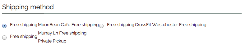

I made the changes (lines 172 -175)and I'm still having the same problem . Any other thoughts on how to fix my issue?
11 years 7 months ago #189833
It's working for me so you're probably editing the wrong file or the file of the wrong template, note that you can also just use some CSS code to hide what you don't want to be displayed by using the "display : none" property.

I've attached screen shots of the steps I took.
1) before screen shot of what I want to change
2) the file I edited
3) before shot of edited section
4) after shot of change
5) After screen shot of what was suppose to change (as you can see there was no change)
Please let me know what I did wrong.
Thank you

It's strange,I'm not sure why it isn't working. I made the changes to the correct template (sorry i sent the wrong screen shot.)
Are these the only lines that needs to be changed :
$price_text .= '</span> ';
$price_text .= JText::_('PRICE_END');
By :
$price_text = '';
11 years 7 months ago #190045
Yes, and it worked on my end, note that you can also do what you want by using some CSS code maybe : www.hikashop.com/support/documentation/1...the-display.html#css

11 years 7 months ago #190094
I found the problem. If I add a shipping fee, then the changes you suggested works. My issue was I had no fee and it showed "Free shipping" ("free shipping" was what i wanted to get rid off). So, I had to add a fee for it to not report it (if that makes sense).
