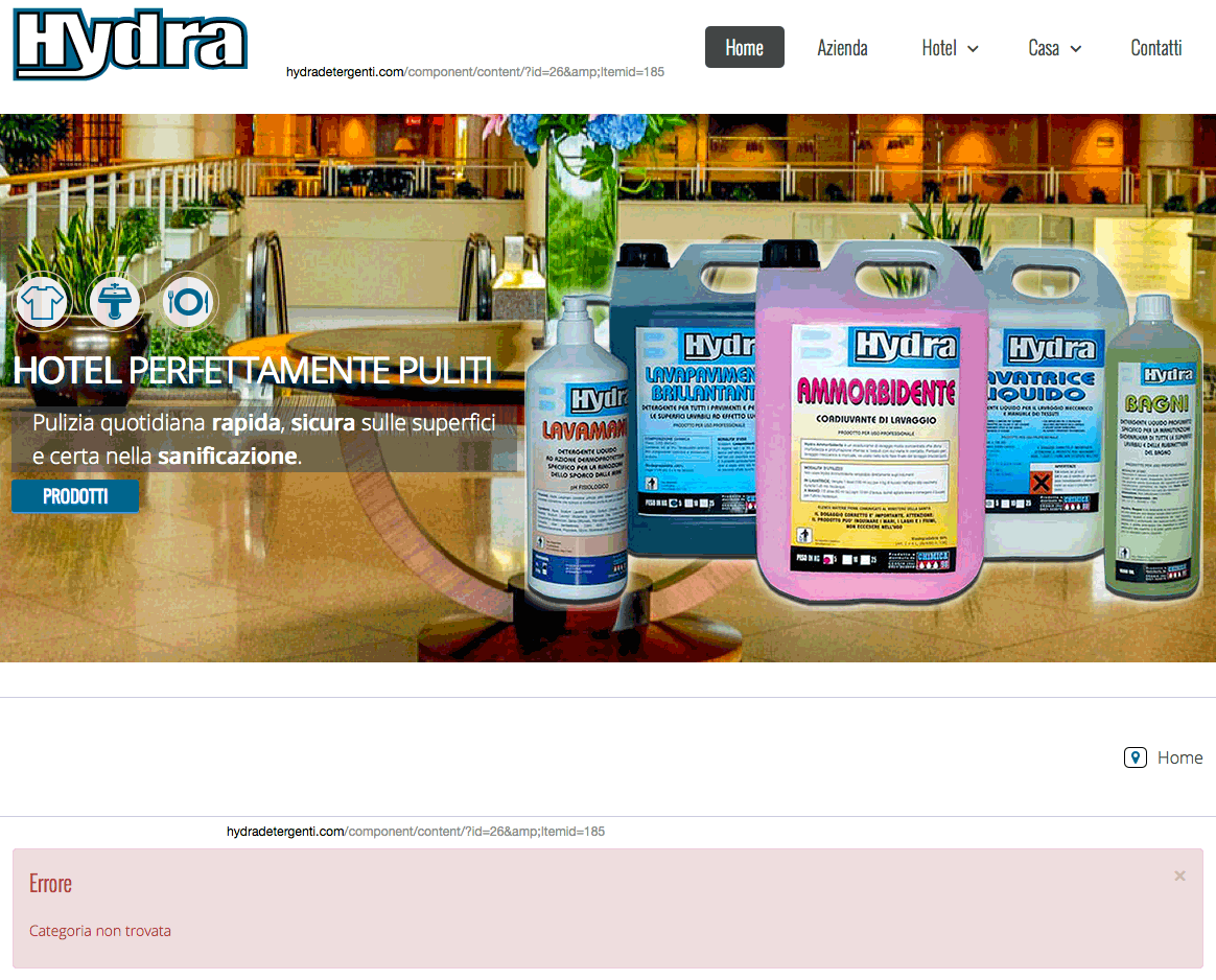

I've a problem with popup checkout.
- in home page when I add a product from a product module in the popup doesn't appeared the "go to checkout" but the home page (I can't desable the "add wishlist" button in the module)
- from a page article in list (hotel or casa menu) when add a product at checkout the popup open the correct window but when I click "go to checkout" button they don't go in the correct page but return at the home page. The product add in the cart.
How I can correct thi points?

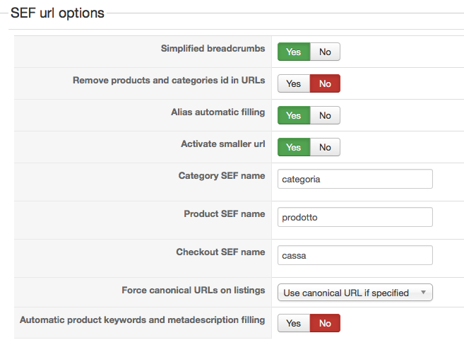

The issue is with the configuration of your SEF settings in HikaShop and the way you setup your menu items in the Joomla menus manager.

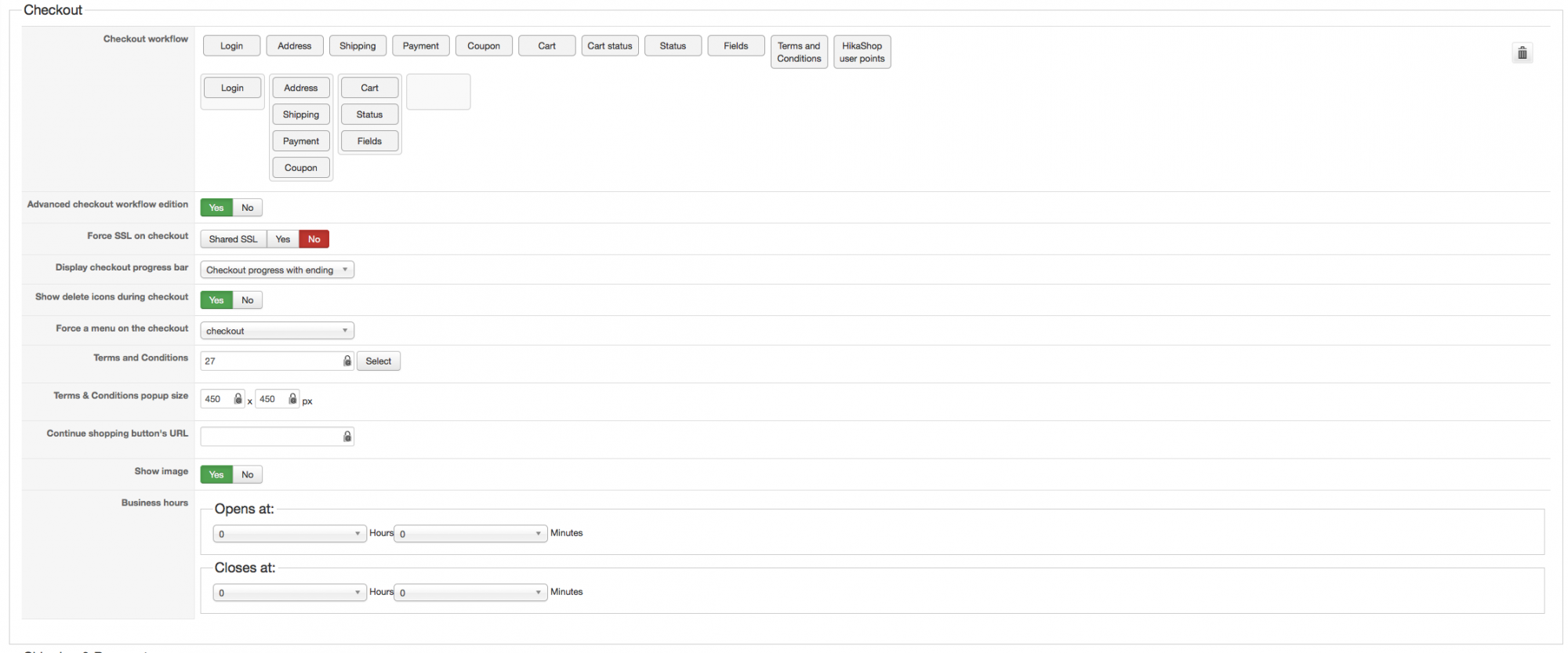

Could you do a screenshot of the SEF section of the Display tab of the HikaShop configuration ?
Also, did you configure the "force a menu on checkout" option of the Checkout tab of the HikaShop configuration ? If so, how did you configure the menu that you selected there ? Is it a menu item of the type "hikashop checkout" ?

yes I use a forced menu, is it a checkout type.
I give you the screenshot:
- error.png (the messag is:"error, category not found") appeared when I click checkout in the popup in product view
- sef.png settig of URL SEF
- checkout.png setting for checkout

Try to change the option "Use AJAX when possible for add to cart buttons" of the HikaShop configuration and if that doesn't help, please check if you hav ethe issue with the protostar template instead of your current joomla template

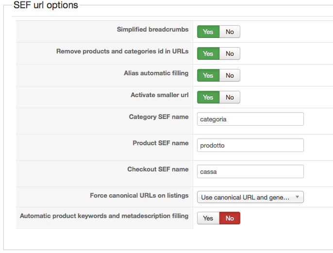

thanks for your attention. This is my sef configuration in Hika, I think everything is ok, for you?

The SEF settings of the HikaShop configuration look correct.
