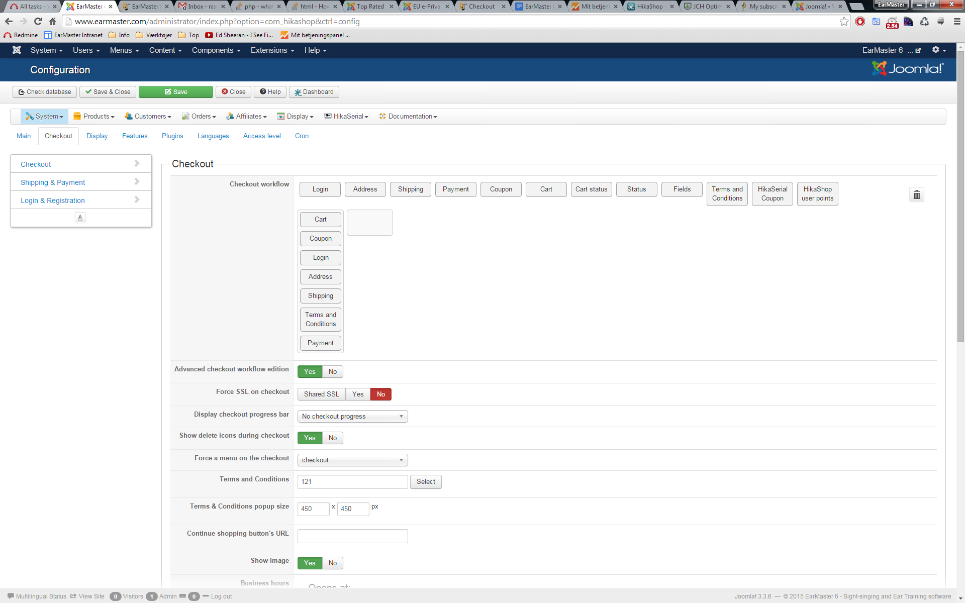

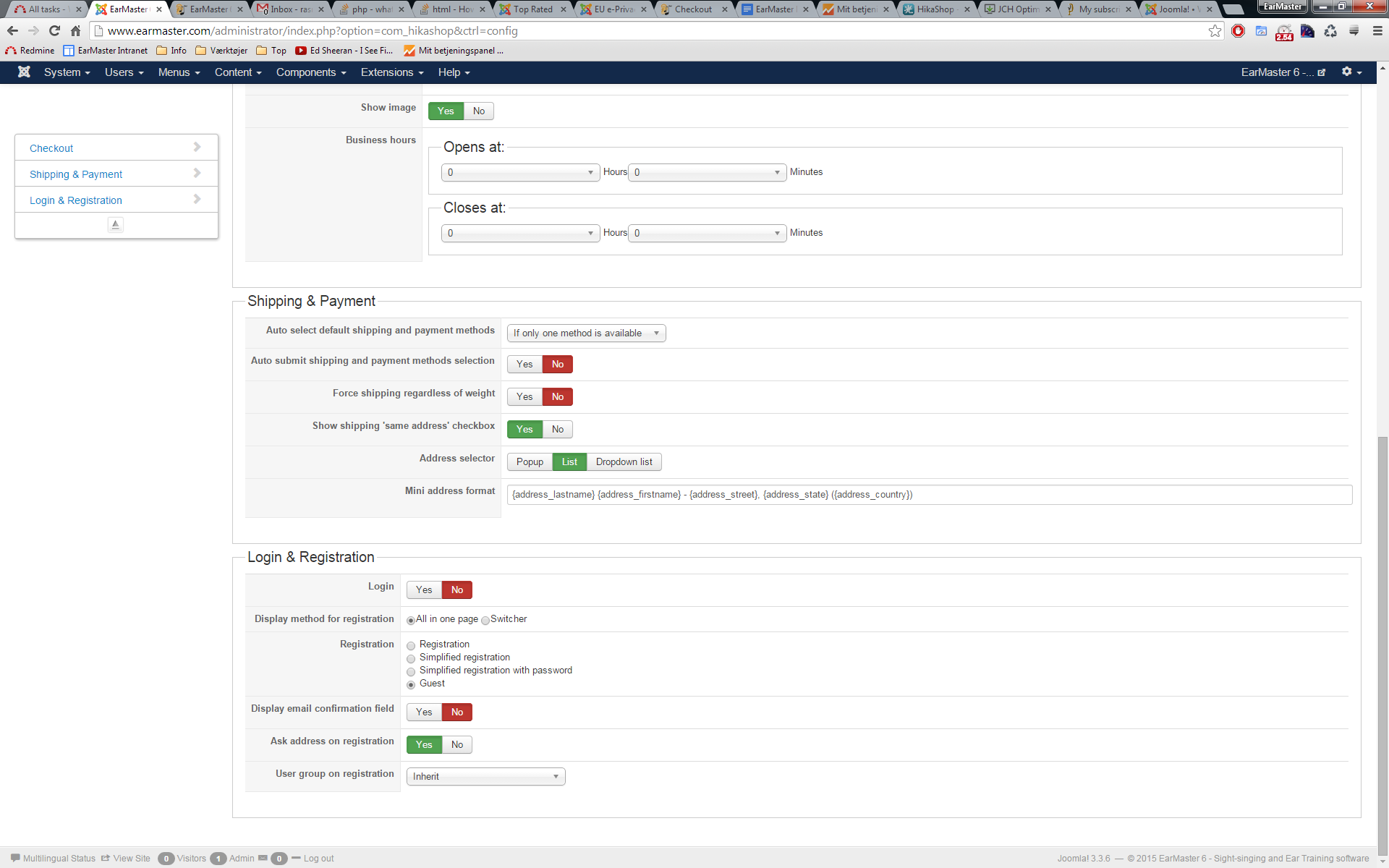

Please provide a screenshot of all the options on the Checkout tab of the HikaShop configuration and a link to the shop so that we can look at the issue.
  • Posts: 135
11 years 5 months ago #191911
Hi!
Part 1 of the Checkout conf:
Part 2 of the checkout conf

The error is happening when the "List" option is selected, which was our first choice. The current "Dropdown list" option, which is the one you found in our shop, seems to be working as intended.
We can revert it temporarily to "List" so you can have a look at the error we get. If we set it back to "List" today between 1pm and 4 pm, would that be enough for you to check it, or would you prefer a different time?
