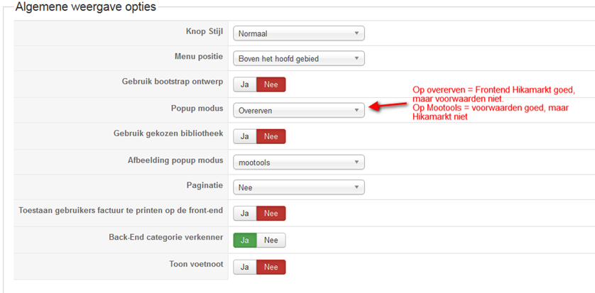

11 years 5 months ago #192248
Your template and the selected popup mode under "Display" in the System Configuration are not compatible. Change it to Mootools, and eventually it'll work.
www.hikashop.com/support/support/documen...html#display_general

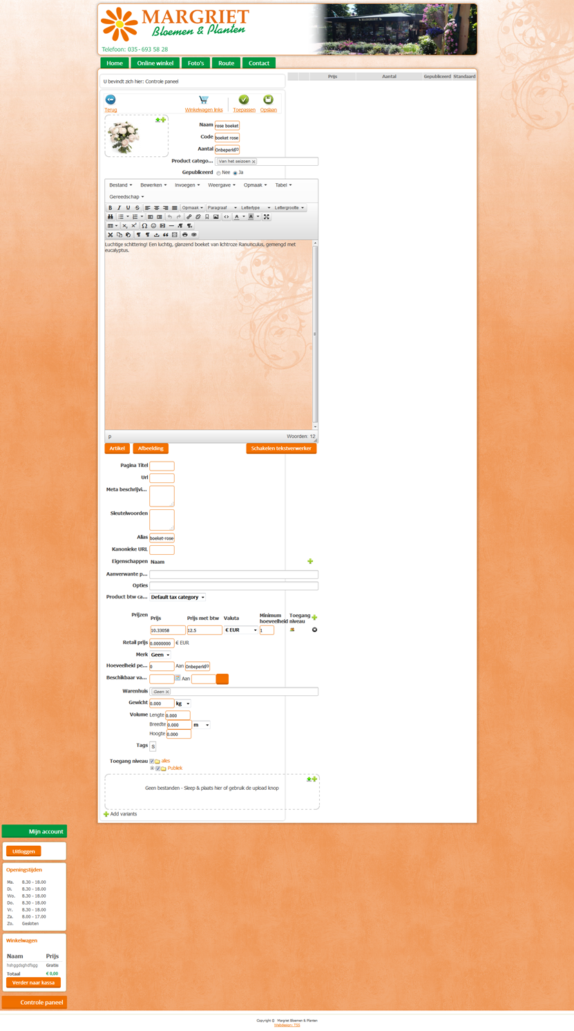

11 years 5 months ago #192340
thank u for this answer, we've changed the setting to mootools. and the terms now is showing ok in the popup but because of this the front end editing of the products layout becomes a mess. see image001 which i attached. image002 is the setting which we changed to mootools. But in the front end editing we also cannot create a category or upload an image for that category. please help. We need the shop to go online. :unsure:
  • Posts: 26381
11 years 5 months ago #192369
I'm afraid that I don't understand your new problem.
Can you please be a little more specific ?
I see that the layout is not good but I don't understand why the popup will be "responsible" of that.
At this moment, with some explanations and with an access to see it directly will be useful.
