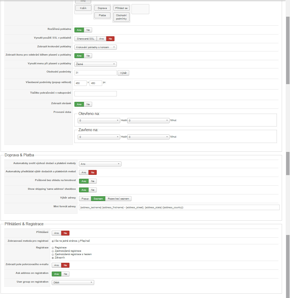

2. How did you configure your checkout settings ? Can you do a screenshot of that tab of the HikaShop configuration ?

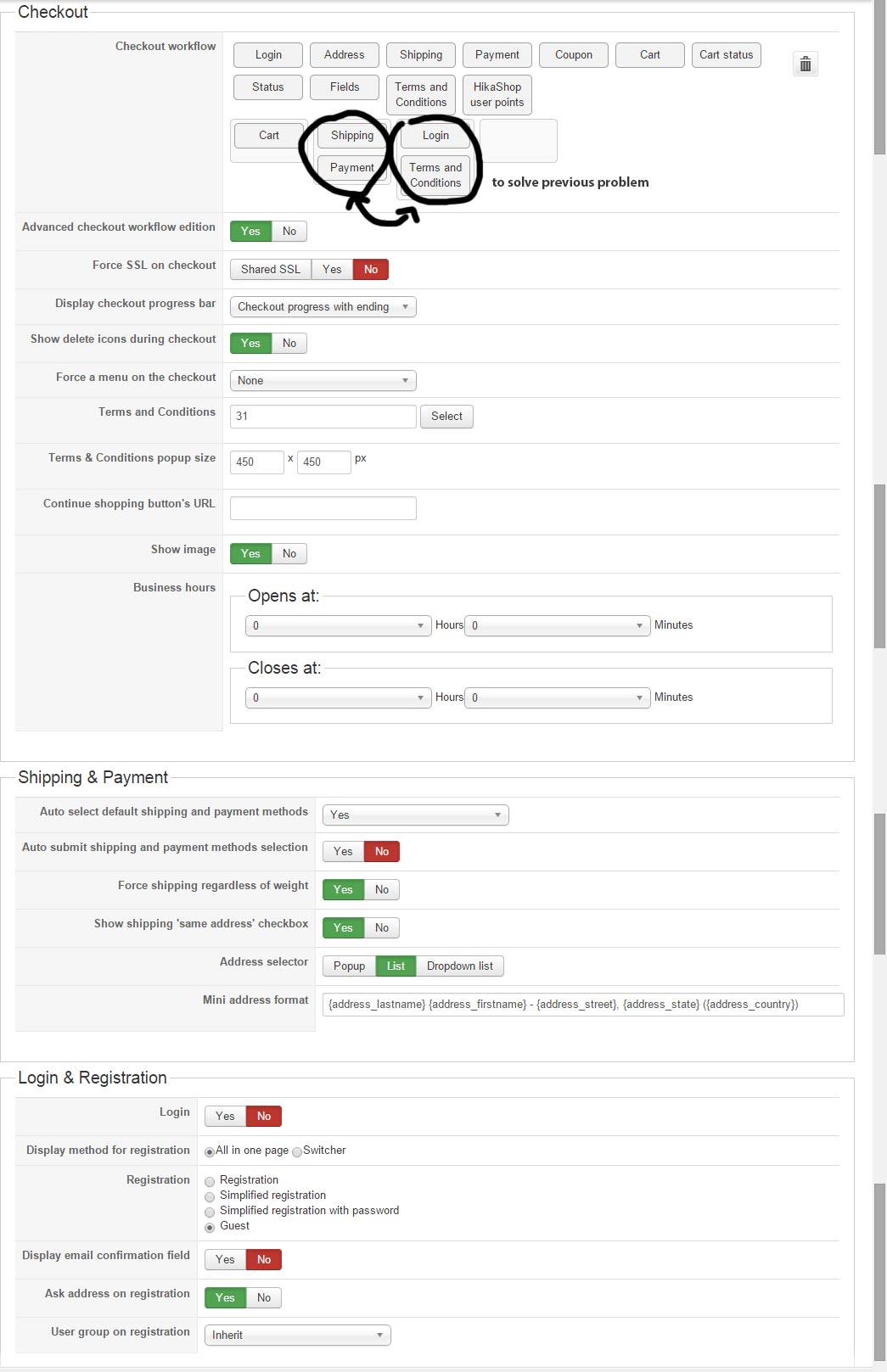

1. the changes doesn't apper. In the order detail and notification email are always default shipping and payment methods.
2.

1. I just tested it on you website, and your payment/shipping methods seemed to be correctly configured, can you test it again by choosing different Payment / Shipping methods than the default one, and check if you have the good methods on your order configuration page via "Hikashop->Orders->'Your Order'" ?
2.
Regarding your checkout workflow, can you change your back-end language to "English" and send another screenshot of your checkout configuration ?

1. I have found source of problem - it was connected with my second issue
logining in at guess checkout reseted shipping and payment methods to default.
So I just swaped those two steps and it solves both two problems
