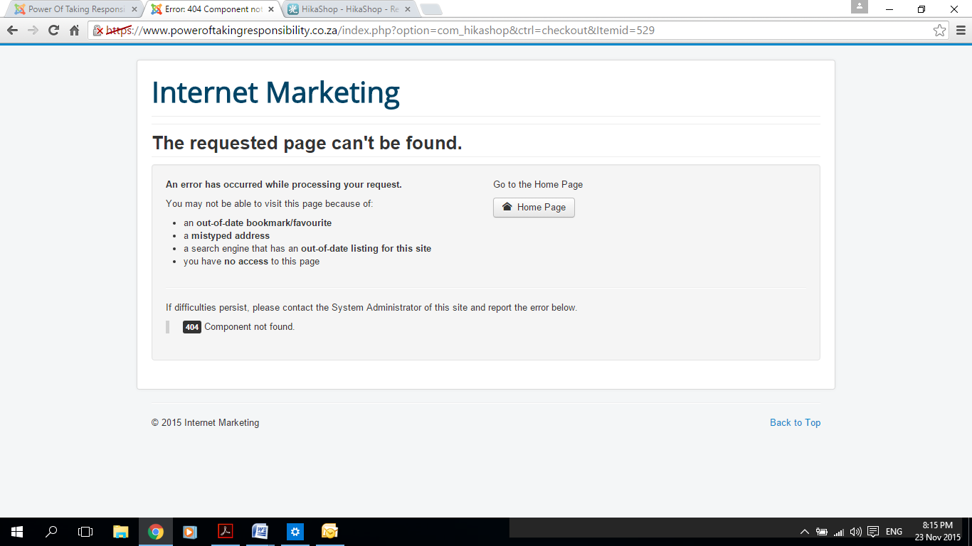

Good Day,
I get a similar message as in the original forum topic. I cannot follow how the issue was resolved. Could you help.
See attached the type of error message.
I use Joomla! 3.4.5
Browser is Chrome
Hikashop 2.6.0
  • Posts: 86040
  • Thank you received: 14174
10 years 8 months ago #221699
The error you're having is actually different from the one on this thread. Yours is "component not found" and not "category not found", so it's normal the solutions don't work.
It's either because you've deleted HikaShop from your website, or because the menu item with the id 529 points to a component which doesn't exist. So please check the settings of that menu via the Joomla menu manager.
